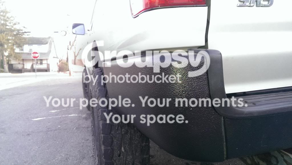

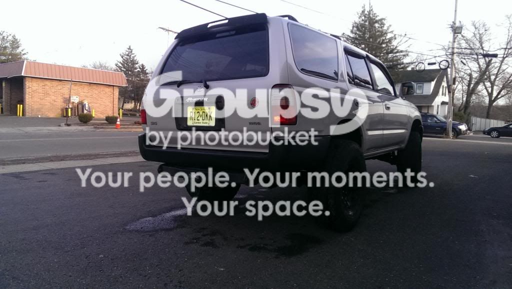

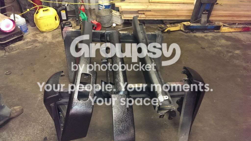

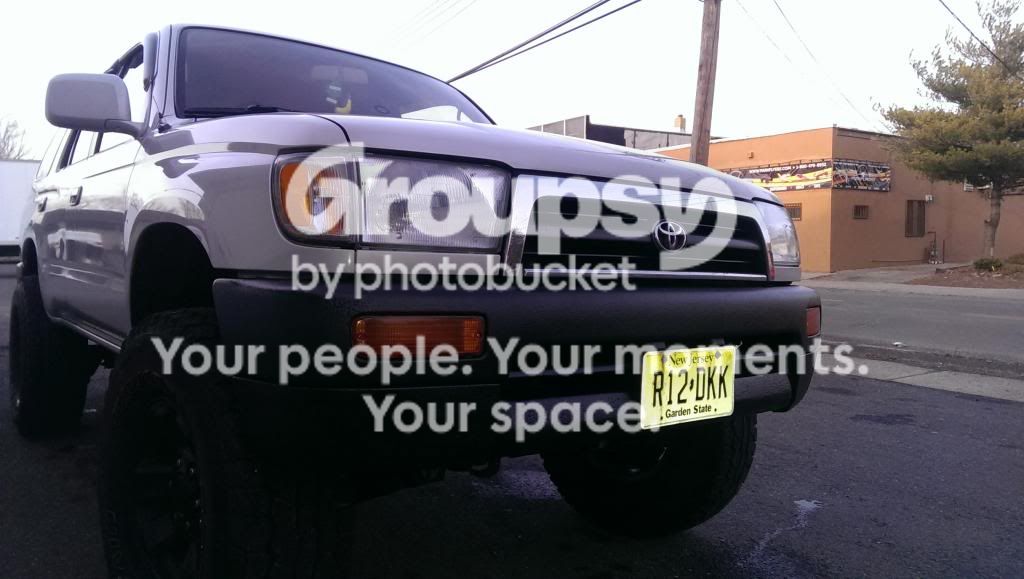

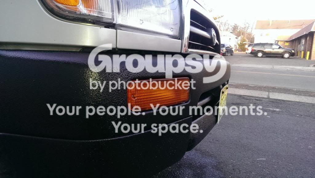

So over the weekend me and my friend rhino lined the bumpers. Our pro car auto body friend told us to 120 grid sand the bumpers. So we did that, we sanded the rust of the back and used rust reformer on the back. Then used this product called RAPTOR. It's like rhino Berliner but pro quality. We used it with a hardarner. Here's the outcome, also did the plastic bottom piece.
Looks great! I think I'm going to do this to mine eventually; tired of all the little nicks and scratches. Are you happy with the way it turned out?
Very happy. Turned out awesome. But then again we had proper tools to spray it on. Feels very durable, looks shiny looks natural! Since we used a hardanrer, like we mixed some in a bottle it should hold up very good. I should of did the back spoiler that goes over the back light also but I completely forgot about. I highly recommend this as now I don't have to polish the chrome, I don't have to spend thousands on a arb bumper, its nice project and if you take your time it comes out good.

*TIP*: WHEN YOU PAINT AND IF YOU MESS UP, GET OVER SPRAY, RUNS OR BUBLES, RELAX DON'T FREAK OUT. THIS STUFF IS LIKE TAR. SO SINCE WE HAD FEW BUBLES WE TRIED TO REMOVE IT WITH OUR FINGERS, BAD IDEA ! SINCE BED LINER COMES OUT WITH TEXTRUE, AND SINCE WE RUBBED IT WITH OUR FINGERS IT LOOKED LIKE A MESS WE NEEDES TO GET THE TEXTURE BAD TO THAT NATURAL RHINO ! SO YOU TAKE A SCOTCH BRITE PAD AND YOU SIMPLY LAY IT OVER AND LIFT VERY LIGHLTY AND CAREFULLY. ONCE YOU LIFT UP IT RE-CREATE THAT TEXTURE. BECAUSE RE SANDING IT AND RE PAINTING IS TO MUCH AND WAIST OF MONEY.
https://www.google.com/search?q=sco...8q4Fg&ved=0CAgQ_AUoAA#spd=4357080365792314547
WITH A PAD LIKE THIS. JUST A GOOD TIP. BECAUSE WE DID THAT ON THE WHOLE PLASTIC BUMPER AND THANK GOD WE FIXED IT. CAN'T EVEN TELL.
Also if you use harderner, you must use all of the spray because if you don't it will harden in the bottle and be useless

Original bumpers were chrome. Used 120 grid sand paper to creat scratches and cleaned up the rust behind the bumper and used rust reformer on the back side. To remove ALL of the chrome is a lot of work and so creating scratches/making the chrome not shine is enough for new paint to grip. That's what my buddy that works as a auto body person said. And let it dry out for at least 24 hours. So far so good. Dirt wipes of clean!! I did take it to a car wash right after I painted it next day and everything was good. Just remember if you use a harderner, USE ALL OF THE RAPTOR, or it will go to waste. Also if you mess up, relax and try and recreate the texture with scotch brite pad. I don't know if you can tell, but the whole bottom plastic piece we layed the scotch brite pad very lightly and lifted it up. Really came out like it was sprayed on. Can't even tell it was fixed.
