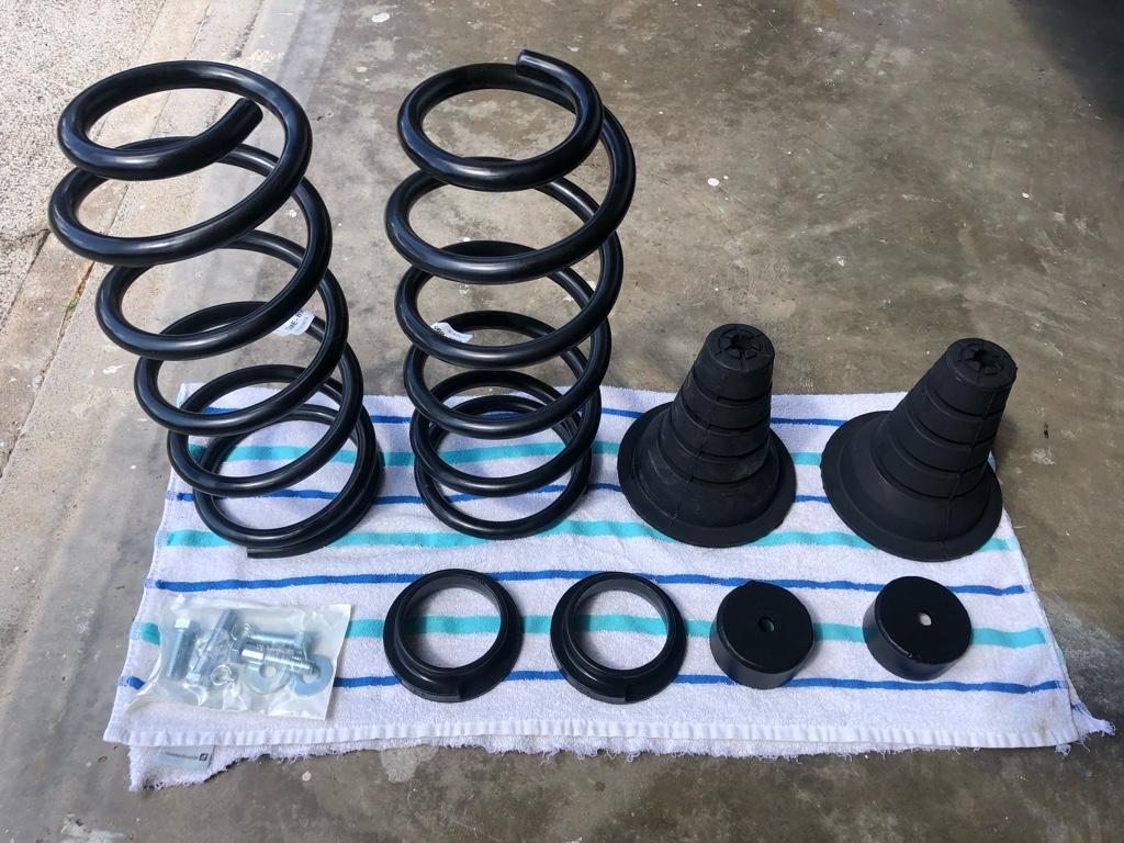

I started planning for this coil conversion right after the accident. I purchased the metal tech gx460 conversion kit. And a few days prior to my airbags failing I ordered OME 2895 rear coils.

Hey im about to do my RAS swap soon too! Got the metal tech stage 1 kit without the isolators. Ended up getting Moog k160061 For much cheaper and went dobinsons coils

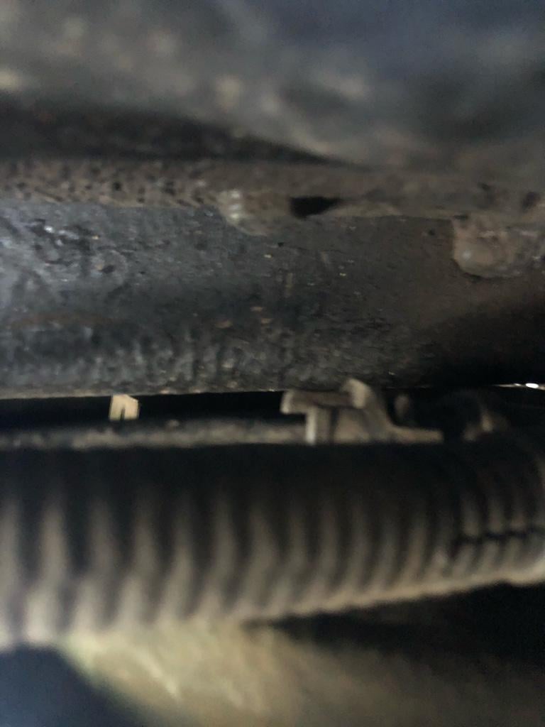

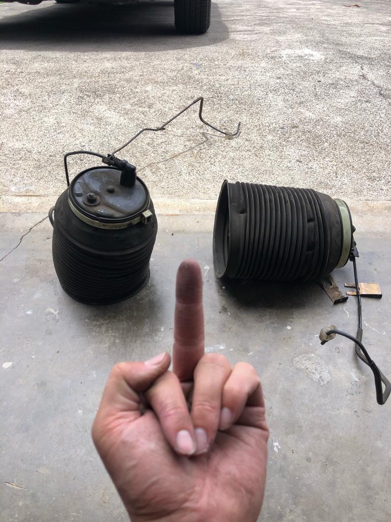

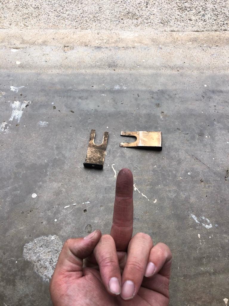

In short the task of pulling out the old failed airbags was challenging as accessing the small metal clip that hold them in place was not easy to access.

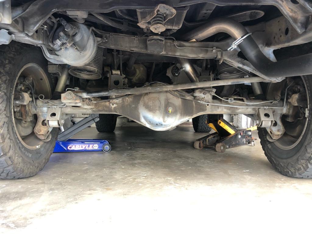

Two jack stands with blocks
Very poor quality photo of the metal tab that holds the bag in place.
PITA metal tabs. My only real frustration during this process today.
Airbags after tab was released and the air hoses disconnected

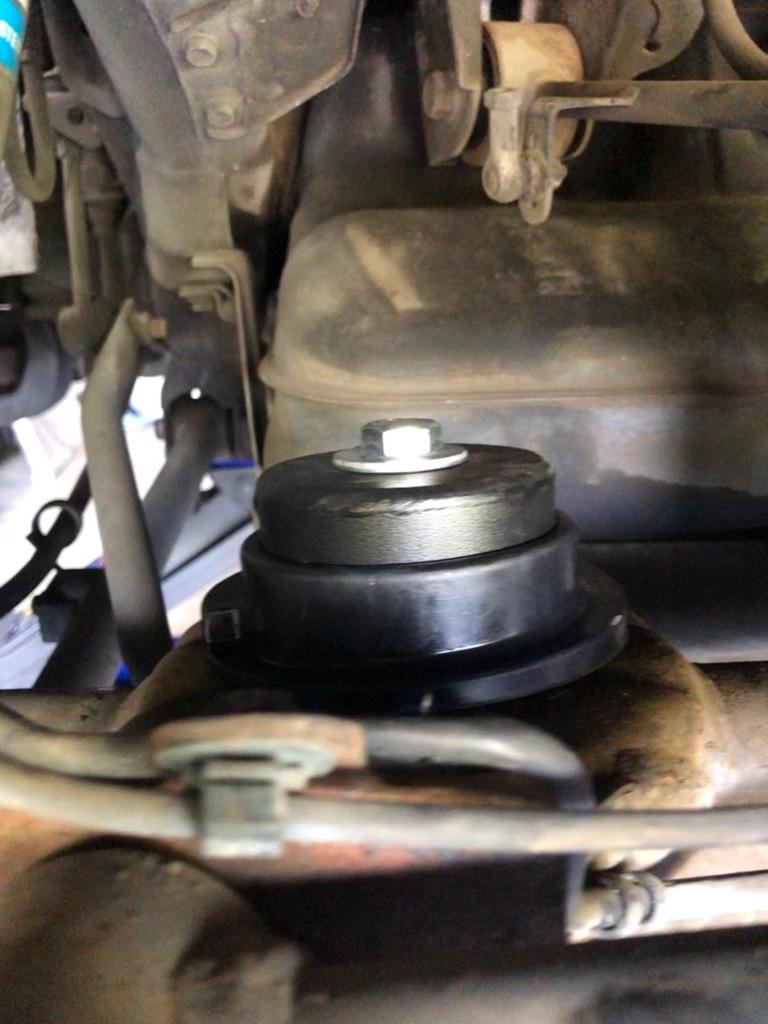

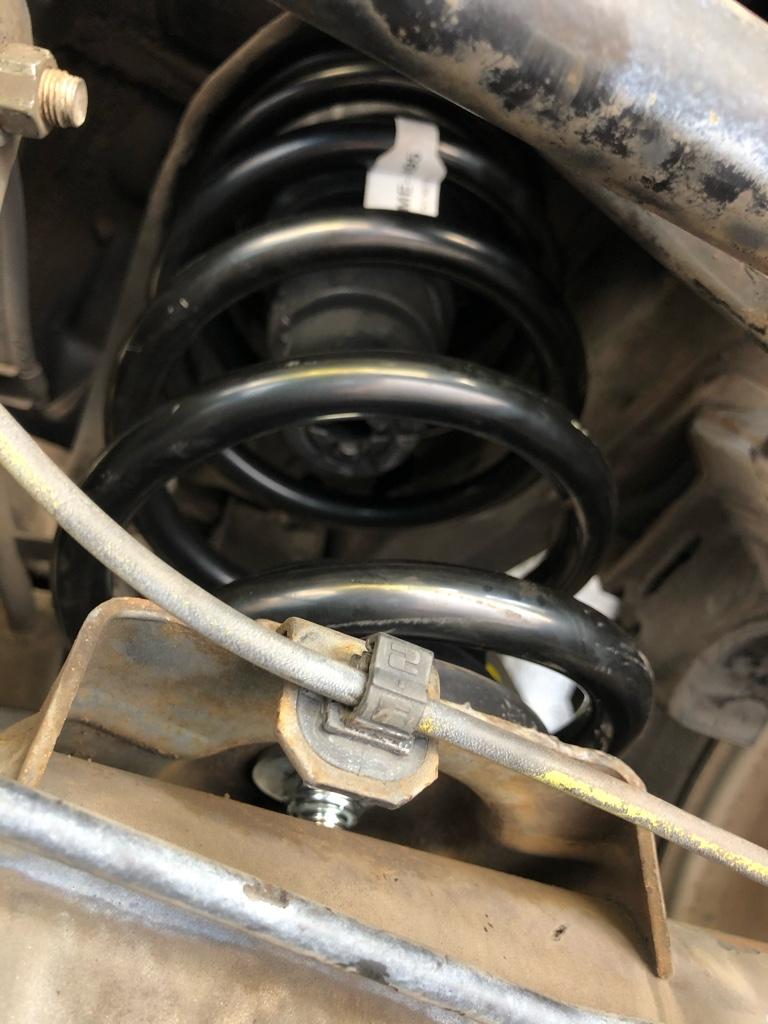

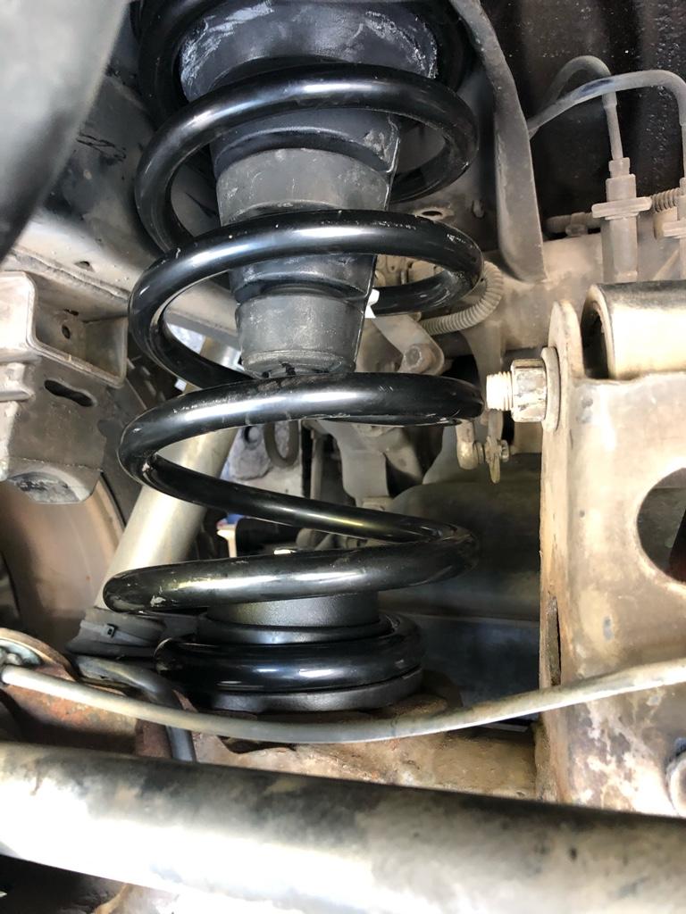

The driver side coil isolator was more effort than the passenger side
The driver side coil in
The passenger side coil in. Isolator was much easier to mount
All in all having two jack stands was much easier than using. Also two sets of ratchets, a torque wrench and a breaker bar. Oddly enough I did not remove the rear tires for this install instead disconnected most of the rear suspension components and I clipped the break lines and air lines.

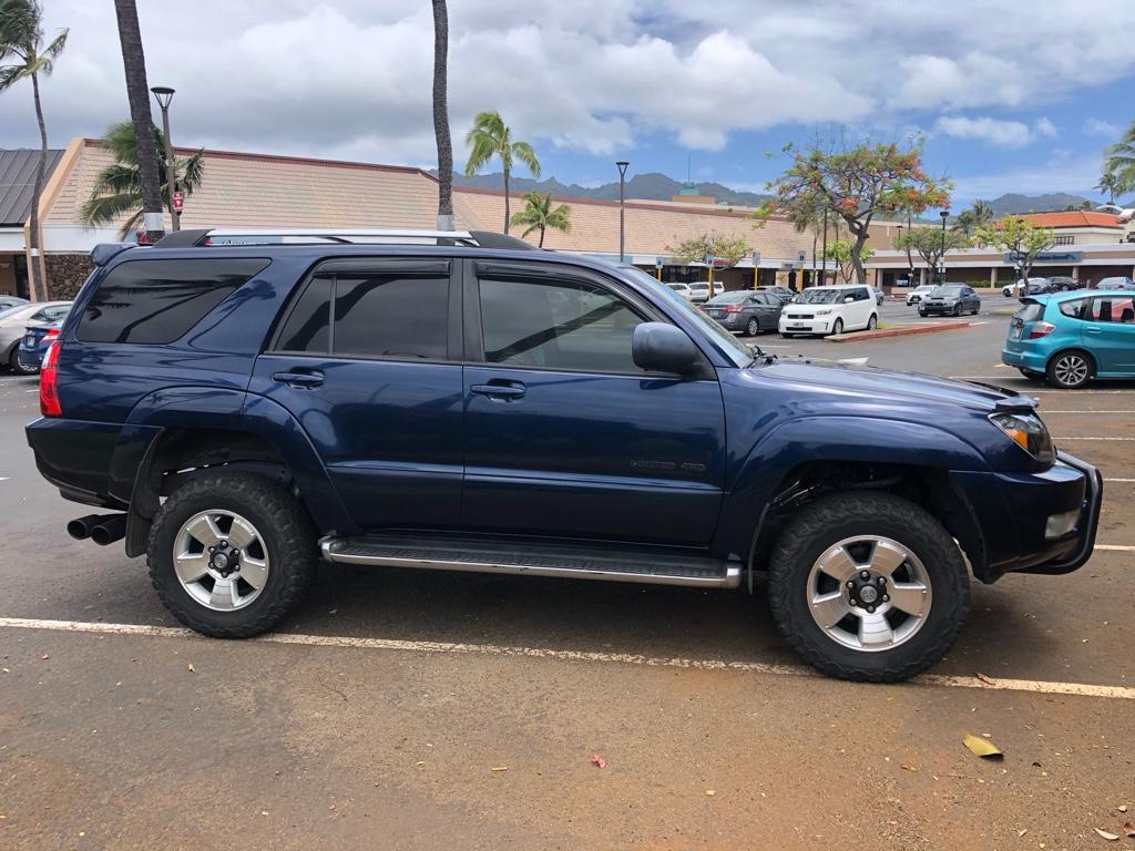

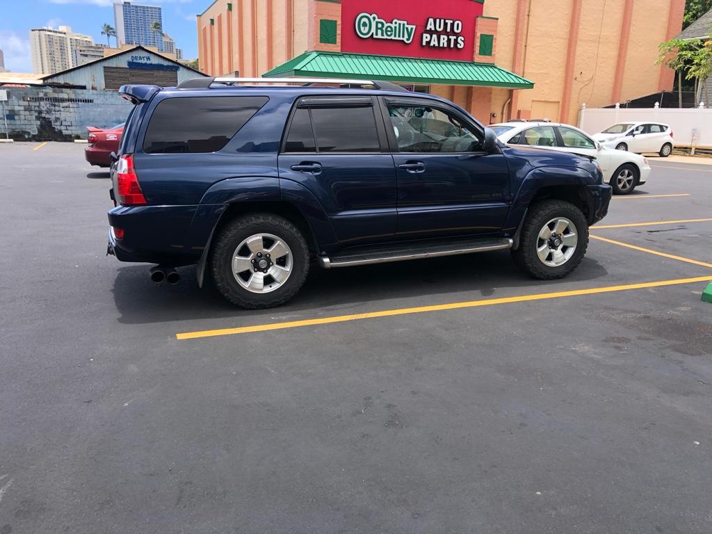

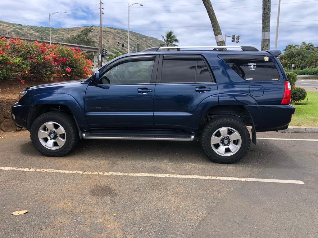

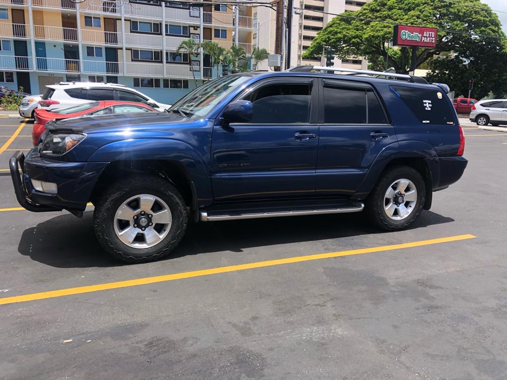

Don’t have measurements before as the bags were collapsed and uneven but with the roof rack the rear end is sitting just below 6’3.
Placing an order for OME ARB 2885’s to replace the Tacoma coils in the front currently mounted on Bilstein 5100’s up front to level her out.
As she sits until the new coils come in for the front end. Too bad the factory rake didn’t come like this
My apologies for iPhone quality photos.
Also I do have to keep my running boards for now... my girlfriend and her dad find it difficult to get into the car. The dog doesn’t seem to mind the jump.
