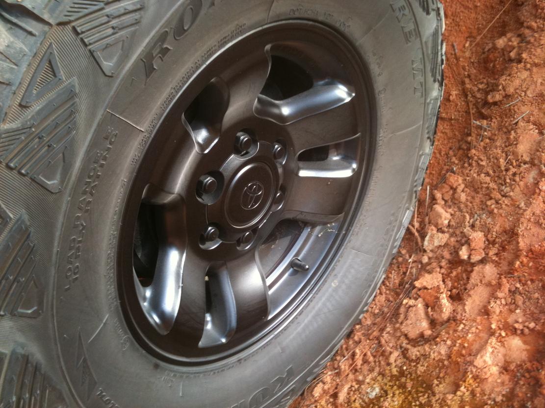

Hey guys, just bought my runner a week ago. Been so crazy with work 65+ hours a week but i finally had time to take care of the pitted and ugly stockers it came with. Yea, i could have bought another set and went aftermarket but i personally like the stock Toyota look better. Plus, the i like the challenge of maintaining rather than buying new!
I think they came out pretty good, what do you guys think? If you have any ideas on what i can do next to give it a more "tough" look for cheap $$ i would appreciate any! Btw: These were painted with Dupli-Colors line of wheel paint, just the paint, No clear coat. Prepped with a dremel with sanding attachment.
Before:
After:
Just a crappy cell phone shot, wish i had my dslr at the time :(
I just love this 4runner and i want to express it! Sooooooooo much better than that AWFUL corolla i was driving.( But <<<--- was still reliable!)

holy crap thats awesome man. what did you do to keep paint off the tires? i want to do this when its warm

Heres a crappy diagram of how i covered the tire, i took the tires off the truck to do this BTW...haha. If you were planning on painting with them on, i wouldnt !
I removed the center cap also and painted it separate. I cut a nice circle out of painters tape to fit perfectly over the toyota logo and then sanded the cap and painted.
For those who dont understand that drawing, here goes.
1. Buy nice wide painters tape, the green kind is what i used. Autobody stuff.
2. Cut out about 20-25 pieces at 3" long for each wheel.
3. Then one by one slide each piece under the gap between the tire and wheel, overlapping as you go. Dont press down and seal them to the tire yet, just use your finger to seal around the edge closest to the rim, and leave the rest sticking up.
4. Once your all the way around, find some cardboard.
5. Now lay it over your wheel and punch a hole in the center, then use a blade to work your way out to the outside of the rim. Then just follow the rim around with the blade to cut a nice circle out the size of the rim. Make sure you used a big enough piece of cardboard to cover the WHOLE tire.
6. Now, take the piece of cardboard you just cut and cut in directly in half.
7.Take one half, slide it underneath the tape you left sticking up. Now you can seal the tape onto the cardboard! Repeat for other piece.
8. Dont forget the valve stem !
Few other things i should mention, i used 80 grit on a dremel to rough up the real nasty pitting, then went around with 400 grit and sanded the whole wheel again. That seemed to work best. The Duplicolor brand spray seemed to be a little "Runny" at times but dried great. Three light coats worked best for me. I only needed two cans.
I had absolutely no overspray on the tires with this method. Enjoy guys!
