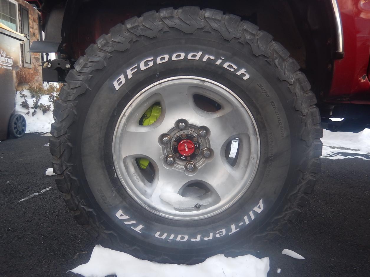

Hey I’m finally finishing my 4runner project and am ready to purchase some tires. I’m looking for some tire recommendations from people because I’m a little confused as to what tire specs I need due to the upgrades I’ve made to the vehicle. So here is some background info.
As you guys already know the OEM 4runner wheels (16”x7”) use 265/70R16 tires (~31”x10”). But I bought a set of FJ80 wheels (16”x8”) from somebody locally and plan on installing 33” tires, so I’m not using the stock 4runner wheels and tires. The FJ80 wheels I purchased already had the original 33” tires on them (285/75R16), but they are dry rotted and not safe to use. However it was great to be able to install them on the 4runner to determine if I liked that tire size before spending all this money on 5 new tires. So I do plan on buying new 285/75R16 tires (33”x11”) for the FJ80 wheels. But if you guys recommend the skinnier 255/85R16 tires (33” x 10”) let me know. I made all the proper suspension and brake upgrades to accommodate the tires size increase. In the front I have JBA high caster upper control arms, Tundra coilovers and Tundra 13WL brakes. In the rear I have Dobinson 210V springs and Bilstein 5160 4runner Gen 4 shocks. I have not done anything about the front wheel well pinch welds yet, but I will handle that when the time comes.
I live in the Northeast and will be using these tires in all conditions (pavement, mud, snow, sand). Mall crawler during the weekdays and off road on the weekends. Backcountry, offroad trails and surf fishing in the spring/summer. Fishing the Great Lakes tributaries and snowboarding in the fall/winter. It’s important to me that the tires have the 3-peak mountain snowflake (3PMSF) rating.

Let me know what you all think. Attached is a photo of my current wheel and tires. And you know I had to add the manual locking hubs.

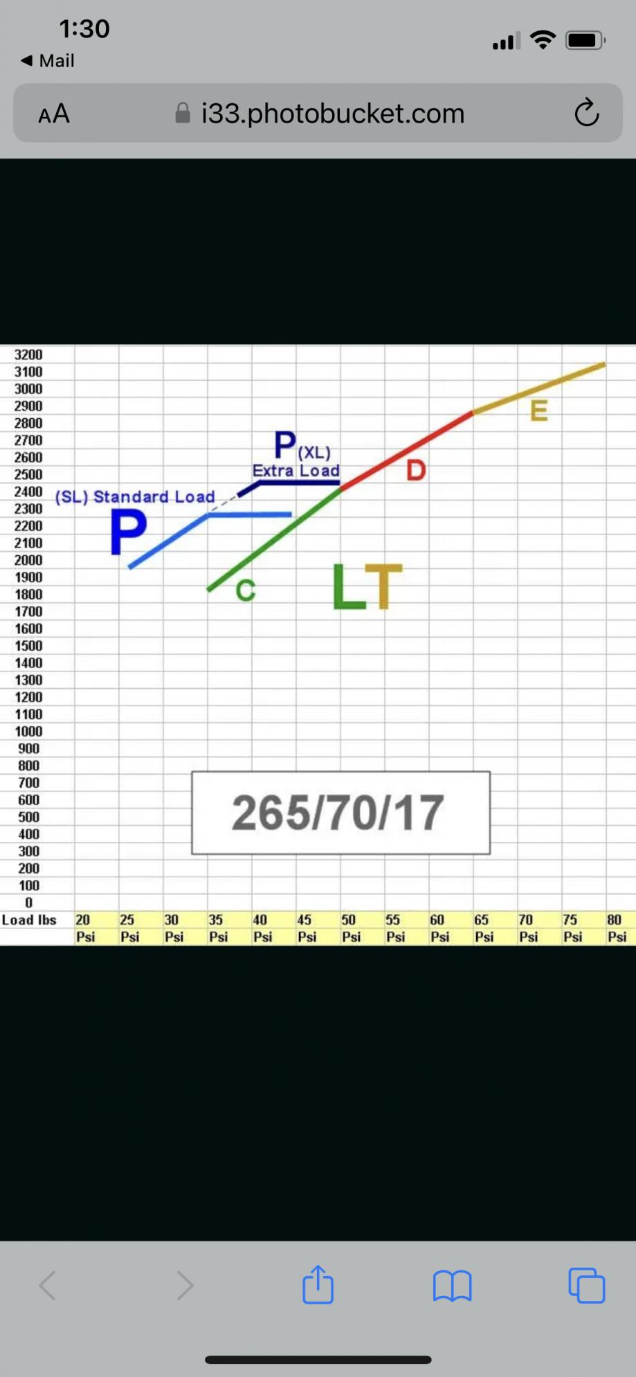

Now you get into the big opinions-side wall flex, side wall cut resistance, tire load carry, tire weight. LT ( C, D, E) and SL and XL. All have a different range of benefits. Do not forget comfort ride on pavenent, washboard, dirt. I found this chart educational.

2. What is the deal with the tire load range?
Ideal for the 3rd gen is probably a C rating at minimum and maximum of D, for offroad use. I highly recommend staying away from E rating. I have a VERY heavy 3rd Gen with all the additional steel, and can personally say that even then, E rated tires never felt good, nor did they wear that great. They did not do great for me even aired down to lower PSI for normal driving and they certainly did not perform well aired down to extreme low PSI for offroad use. This could have been the tire itself as well (Maxxis Trepador Radials), but general consensus in the 3rd Gen Community is to stay away from E rating.
D rating is the sweet spot especially for overall road use + offroad. They just seem to be more difficult to find in smaller tires.

Tire load ranges: Basically, you're choosing between C and E for a 4Runner. And that mostly comes down to the sidewall construction (to oversimplify). And I've been running E's on mine the whole time. They're heavier, they don't flex as well when aired down, but then theyr'e a little tougher. I've wheeld with friends running C tires and perhaps it was just luck/driver skill/whatever, but they've very occasionally torn a sidewall on a rock. And despite some occasional bone headed riving on my part and some occasional fairly deep looking cuts and gouges on my tires, never a flat. Only flat I've had to change on a trail was when I bent a rim, bumping a ledge a bit too hard with the tires aired down a bit too much (10 psi). It flatted, I changed the spare on, and later in camp that night I hammered the dented rim back into shape and it aired back up again.

Some people really like the way load E tires ride but I don't like it at all. It's just too much tire for a 4runner. Then they have to air down to pressures the tires aren't designed for to get the ride tolerable, leading to more heat. It can work, but i s really not ideal.
Load range goes like this:
P ie P285/75R16 is standard passenger load
LT is then broken into
C
D
E
with each having additional plies and thicker sidewalls.
TL;DR
My top recommendation would be Toyo or Falken in either a P metric or a C load.
