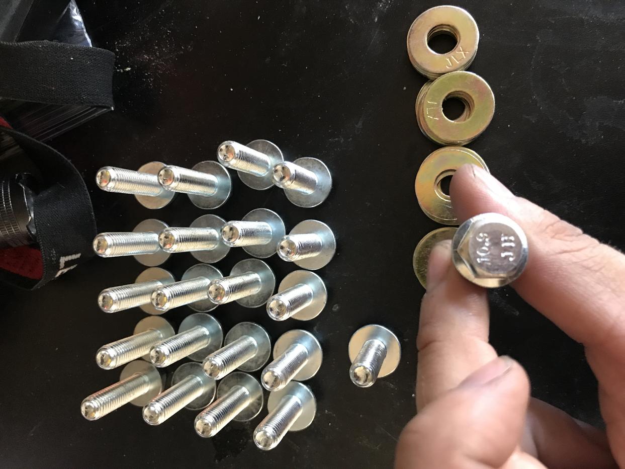

I received the correct m8x1.25 bolts from RCI. The frame threads just needed to be cleaned up better.

Bolts look the same as what I had.

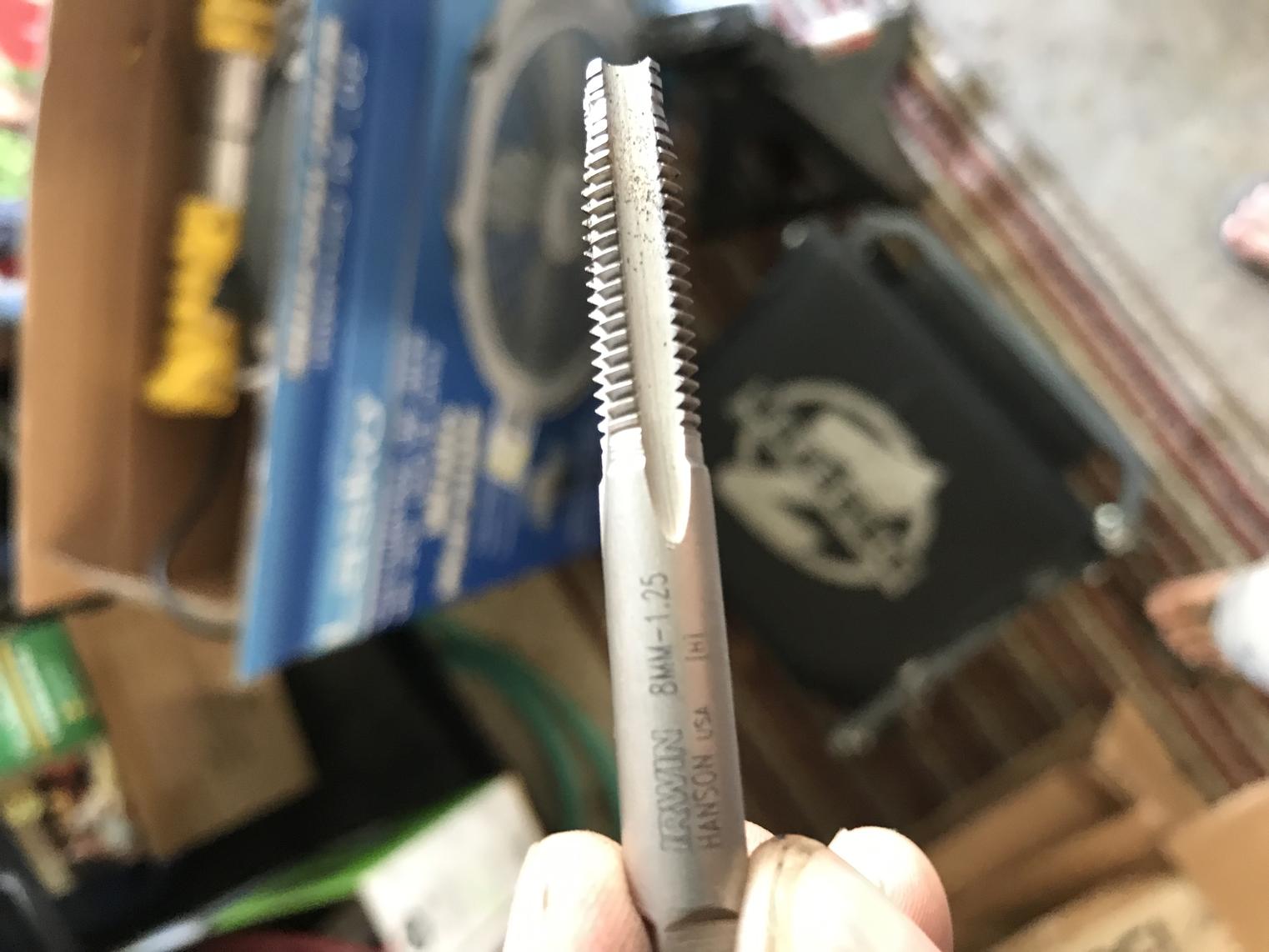

Thanks for the replies. Sorry about the false alarm. I verified the thread pitch on my bolts is indeed M8x1.25. Turns out a few shots of brake clean didn't clean out the holes as well as I thought. They were still quite gunked up. I'm in central TX, so no road salt, but I guess a few years of road grime. Is this tap ok to use to clean or do I need to get a chaser tool? Also, did y'all remove the plastic frame caps or leave them in?

Yes remove plastic caps. Also when installing I used some anti-seize so that the bolts don't lock up in case you have to remove for one reason or another. Did the same for my skids and makes it 10x easier to get the bolts in and out.
