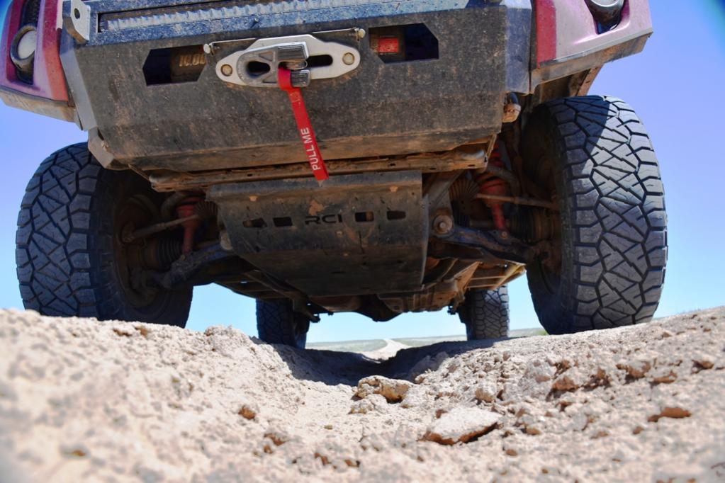

Fits fine. About a 1" gap between for sticks to go up and poke your rad though.

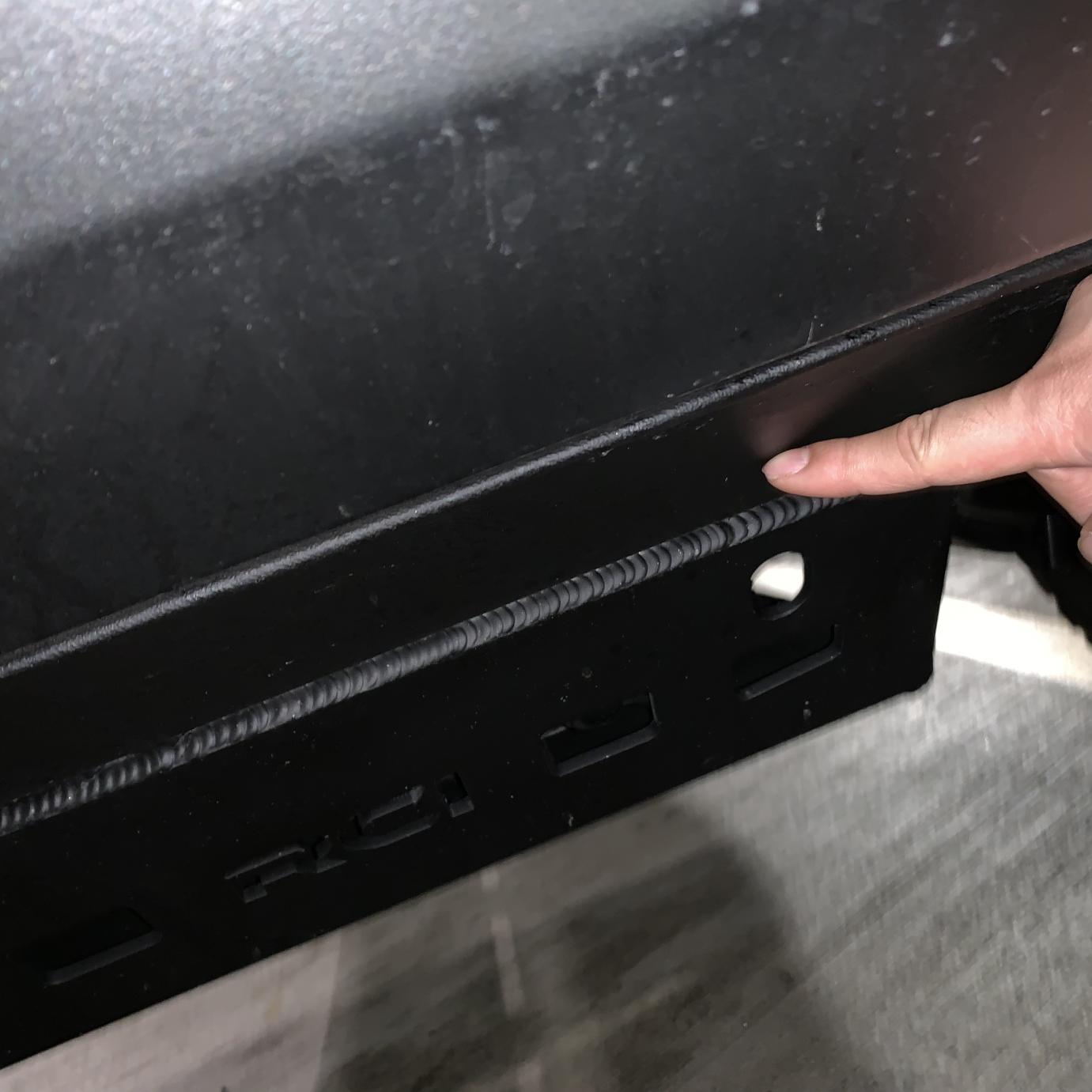

here is the filler plate chopped w/angle grinder and I used weather stripping to hide the chopped edge..
finger pointing at plate

The two mate up nicely, much better then most bumper/skid combinations. There is a tiny gap but certainly not enough to go to the hassle and expense of trying to fill.
