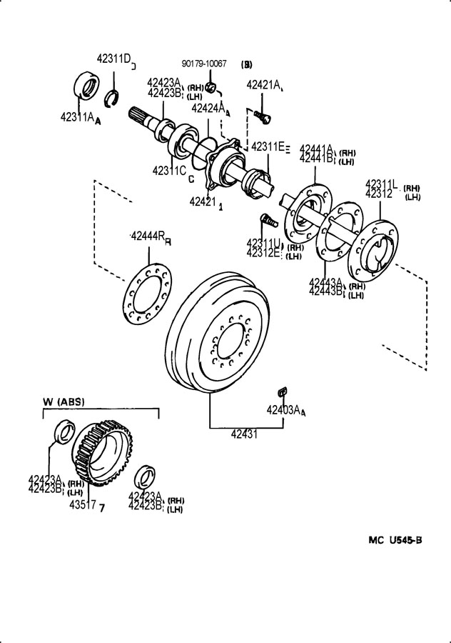

Ok. I got the attached picture from a local auto parts place and was told I need everything in this picture (except the drum) plus the following:
Shaft Bearing Retainer - 42421-35050 - $35
Oil Seal - 90313-54001 - $3
Bearing - 90363-40068 - $30
When I searched for "1997 Toyota KZN185 Rear Axle Shaft" I came up with the following page.
http://jp-carparts.com/toyota/partlist.php?maker=toyota&type=671160&cartype=4&fig=4102
This lists every piece, both left and right. From their table I created my own and removed all the right hand pieces and the Disc, Rear (part code 42431).
I compared what I came up with vs BigFishAllDay's list. On the table on the page there are five listings for 42403A, Piece, Balance Rear Drum. I don't think I need any of those as I'm not changing out the drum.
There are also three shafts listed, 42312. I don't know what month the Surf was manufactured. There are two parts numbers for the three listed shafts. I don't know which I need.
I have attached the pdf version of the part list. Can someone please point me in the right direction? I'd rather not buy stuff I don't need but I'm happy to make smart investments in preventive maintenance. Since it's going to be apart there is no reason not to replace all the seals etc. I just don't know what is what.
