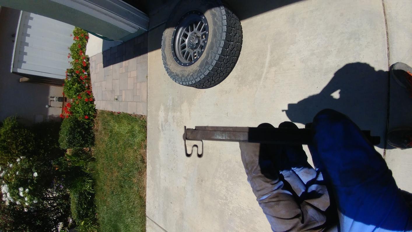

I was about to leave for an overnight wheeling trip when it sounded like my rear brake pad wear indicators were making noise. I didn't think it could have been my rear brake pads because my front pads were still good. Every other car I've had, the front brake pads wore out first, so I was shocked when I inspected my rear pads and found my back brake pads were worn down to the indicator.
