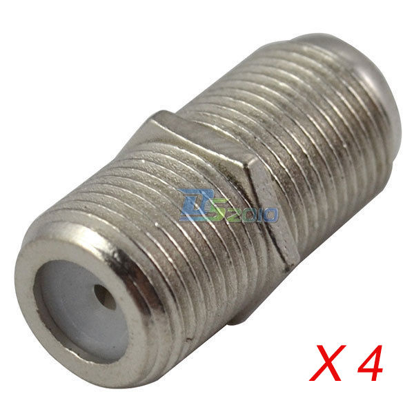

for less then $1, pickup this.....drill the inside out, screw it into the diff with a hose to extend to gas area with a small service loops.
or if you're like me, really cheap. Take a fitting off your catv line and use that, its FREE
I bought the two toyota fittings ( as outlined in Timmy the Toolman's youtube video ) for like $7. Already had some hose.
Even still. You can easily piece together your own kit for less than $20
Wow, same threads huh? Thanks!
