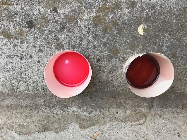

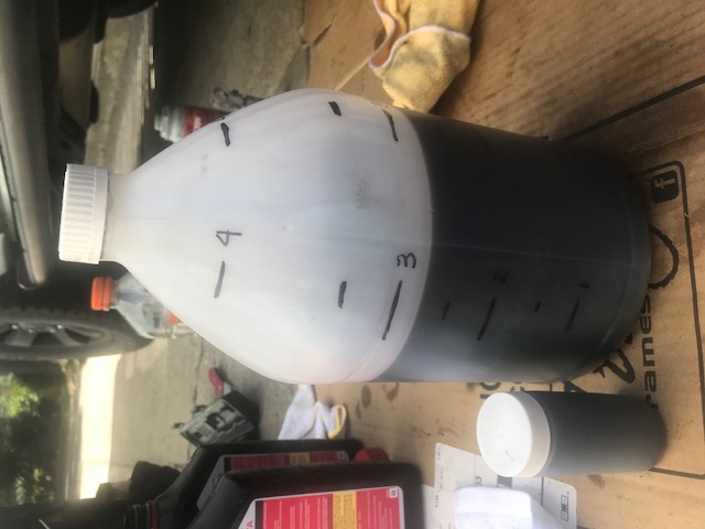

I opted for just a pan drain and fill today. Drained just shy of 3 quarts (including the sample for Blackstone), and refilled with three quarts of Toyota WS (less what I couldn't pump out of the quart bottles). Pain that the Toyota bottle doesn't fit a standard fluid pump...
