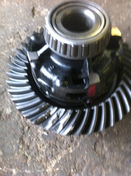

Well here is my story...
At 65,000 Miles My rear end (diff) blew out. Meaning I shredded my gears. There were many possibilities.
1.I always power braked it and it took a lot of abuse from that.
2.A week before it happened I went mudding (1st time) got stuck (took me a while) and i was stuck in an area where water nearly submerged my breather up top of the diff.
3. I never changed the diff oil. (Never have on any of the cars, never had a prob)
Well, one day I was driving on the highway and I hear loud clunks coming from my rear end. I just knew my gears were gone. Typically no one predicts that whilst driving in a Toyota, but I did. Sure enough I was right.
We lifted it up took off the driveshaft then dismounted the differential and took it apart. sure enough I shredded a portion of it. The gear was damaged but the pinion was fine; however, we replaced the entire assembly because obviously the pinion was microscopically affected because of the gear turning it and the chunks of metal circulating in the oil. Nevertheless $3000 later we swapped in a brand new rear end.
I feel that I am the only one that has experienced this problem.
heres a pic
