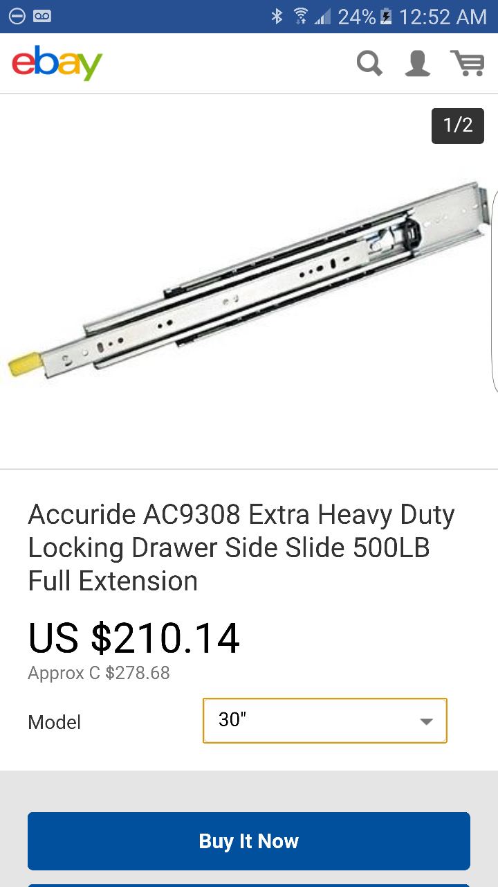

Wanting to build a DIY fridge slide for my heavy cooler. Found a place on island but need to buy slides in sets of 2. Wondering where any of you have found accuride slides sold singularly. Looking for the accuride 9308 in 30 inch lengths. Lock- in / lock-out.
If I can find another buyer I could always by the sets and sell one set off...
Go splits with someone? Also this is the screen shot from ebay....

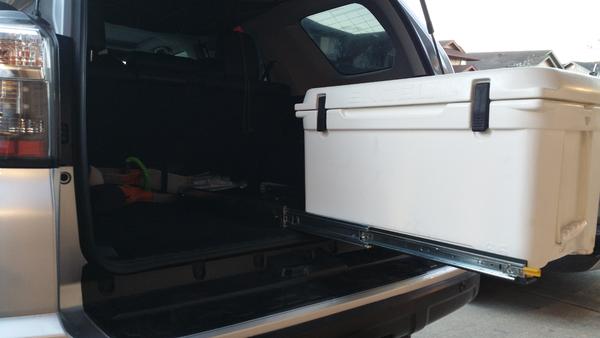

Finally got around to completing my project. (more pics in my build thread)
- Accuride 30" 500lb Lock-in/Lock-out slides
- 2" angle iron for bottom brackets
- 2" angle iron and some for cooler tray
- 3/4" birch plywood lined with bed armor bolted to the metal truck floor
- Trunk lined with sound dampening material.
- Bottom brackets attach with bolts and t-nuts to be removable.
