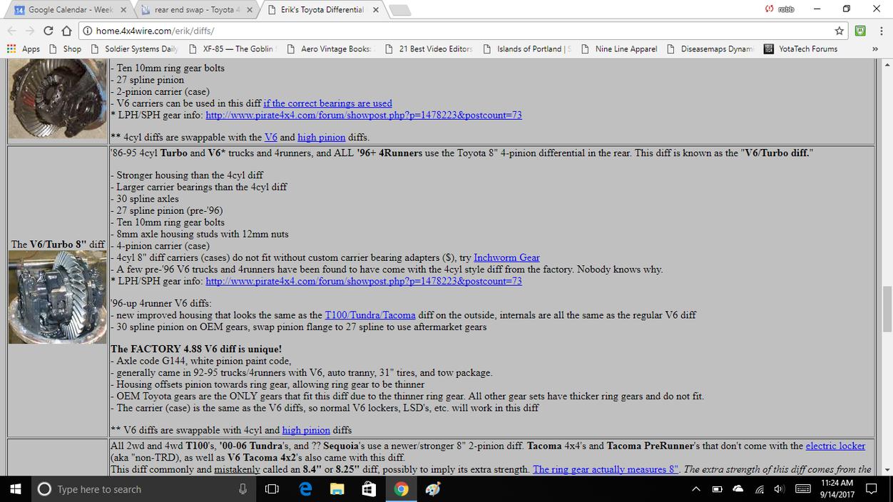

rear making noise at high speed. don't have the money to do a rebuild so a salvage yard rear will have to suffice for now. it is a A03A/4.10, 7.5 inch. what 4runners, if any, came with an 8" rear end? what other toyota rear will swap in? tacoma, tundra?
