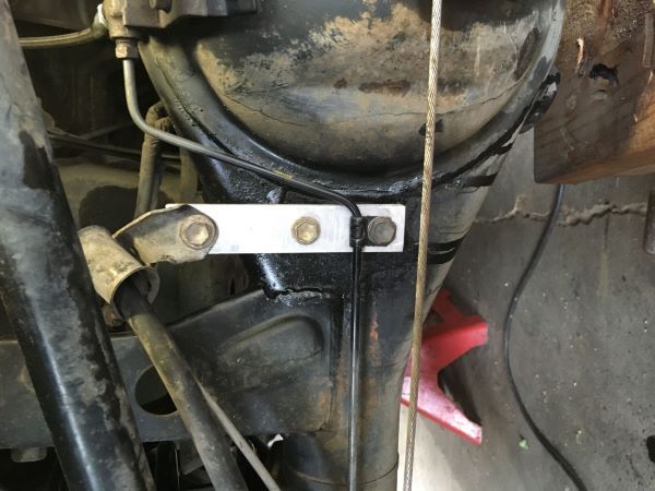

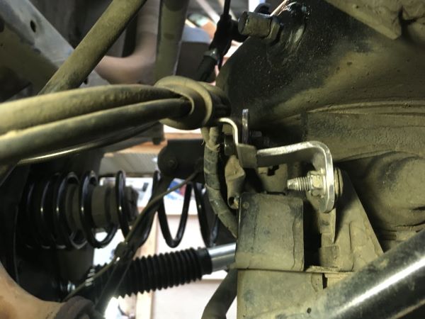

My brake line was too short. The e-locker harness support bracket needs extended, and the E-brake cable support bracket needs extended. Plus longer bump stops.
Not to mention the sway bar links and panhard bar mounts.
Fun stuff. LOL!
This was todays dinking around. Painted black after the pics, but left raw for the pics so it was easier to see. Tomorrow I'll extend the axle vent up to the gas fill area and work on the panhard bar.
No idea why they turn sideways when uploaded. iPhone I guess.
