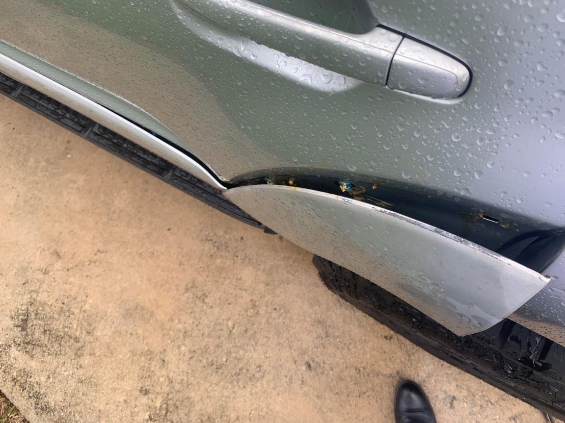

It looks like you just need to replace the blue and orange push clips that secure the fender flare to the vehicle. I actually have a bunch of them I didn’t end up using. PM your address to me and I’ll send you a few of each.

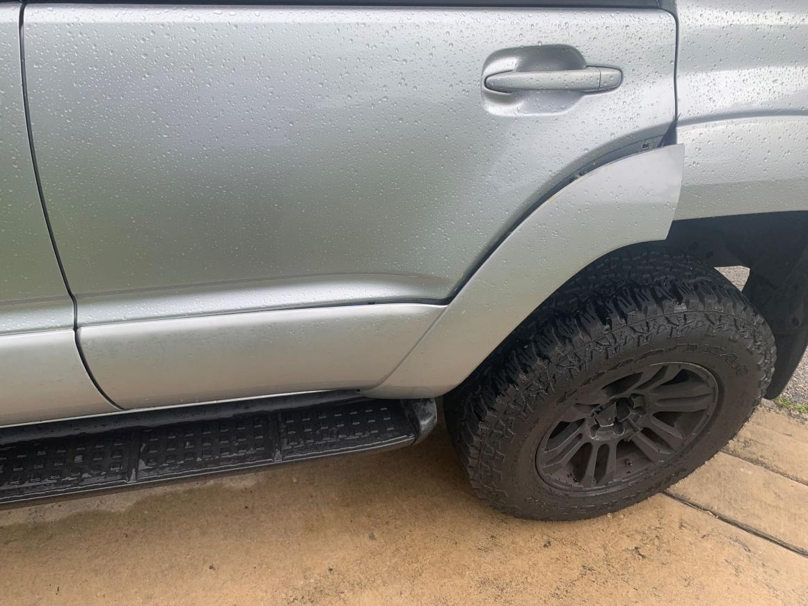

Recently, I noticed my rear fender coming and flapping while I was on the highway. The mechanic who did my brakes supposedly fixed it, however it came apart again and I see he just used some glue to hold it together.
What part exactly is this panel that I need to replace? Is this "lower cladding" on the below linked page the correct part?
Genuine OEM Exterior Trim - Rear Door Parts for 2005 Toyota 4Runner Sport - Olathe Toyota Parts Center
As CJFONNER said, it looks like you just need to replace the clips. I had a similar issue on mine. Make sure you figure out which clips you need, since Toyota, in their infinite wisdom, used a couple of different ones in different spots. I bought some from the dealer, but then decided to order a couple of bags of them off Amazon for much cheaper. It's a pretty quick fix. Clean all the glue off first.
This guy has a post with the FSM pictures and a list of the parts.
2003 Cladding Help! - Toyota 120 Platforms Forum
Mine looked similar after I bought it. As others had stated it just looks like the clips are broken. The mechanic that poured glue in it did a horrible band-aid fix and should have told you how to properly fix the issue.
