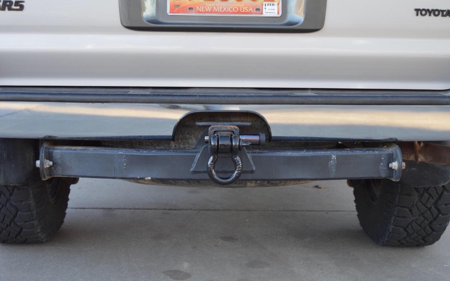

Info is scarce depends on hitch you have.
Hitch that has receiver below crossbar bolted or welded this is what you get.
BigFishAllDay RIP, his 97 build thread no longer works how he did it.
Hitch that has receiver same plain as crossbar you cut frame mounts off crossbar. Flip the mounting plates
to where they set inside frame rails long part of L pointing upward instead of down.
Does require making frame mounting holes into slots.
Cut equal lengths off ends of crossbar to fit between mounting plates notch bumper weld in place.
Hope this helps.
