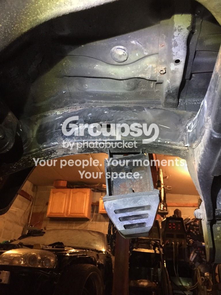

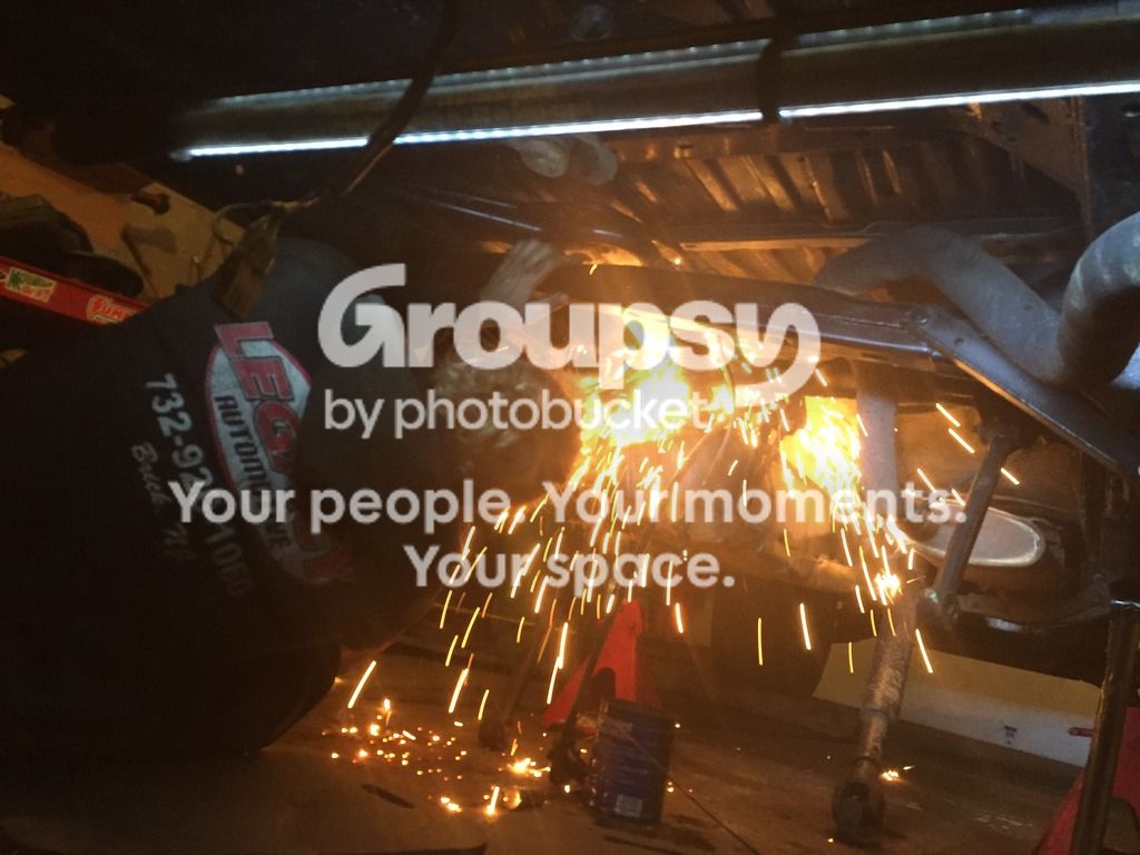

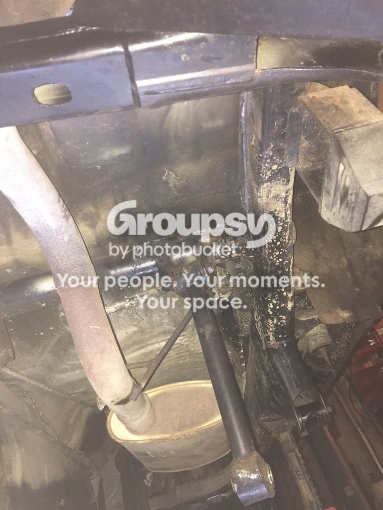

Yup? Torching near the gas tank. Shhhhh

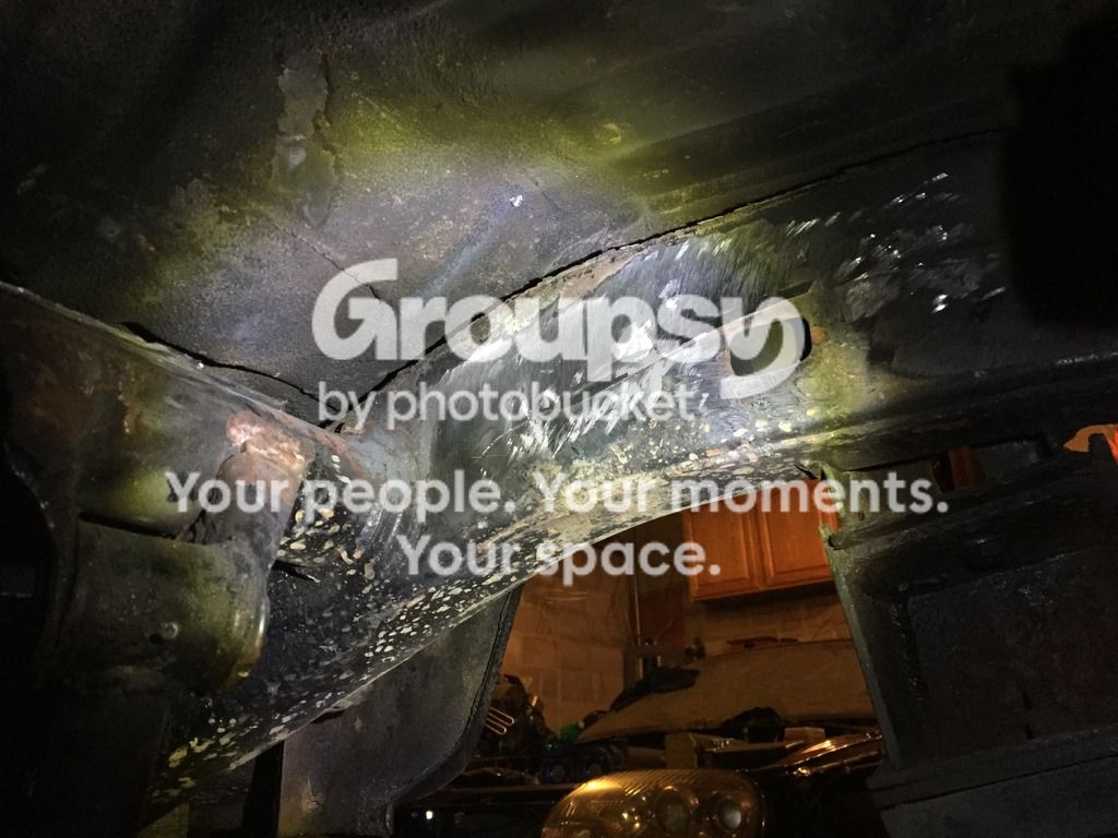

Driver side removed. Because why not do both sides !

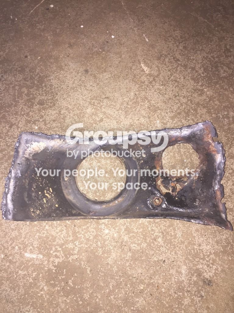

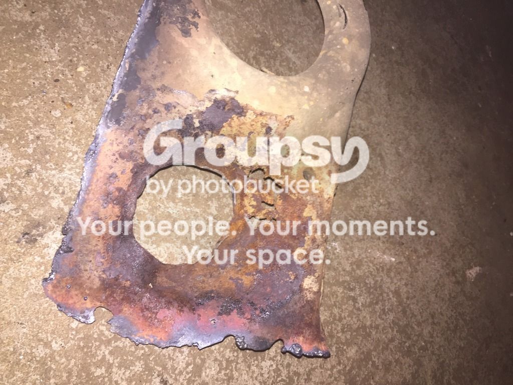

Passenger side removed. The side that rusted through.

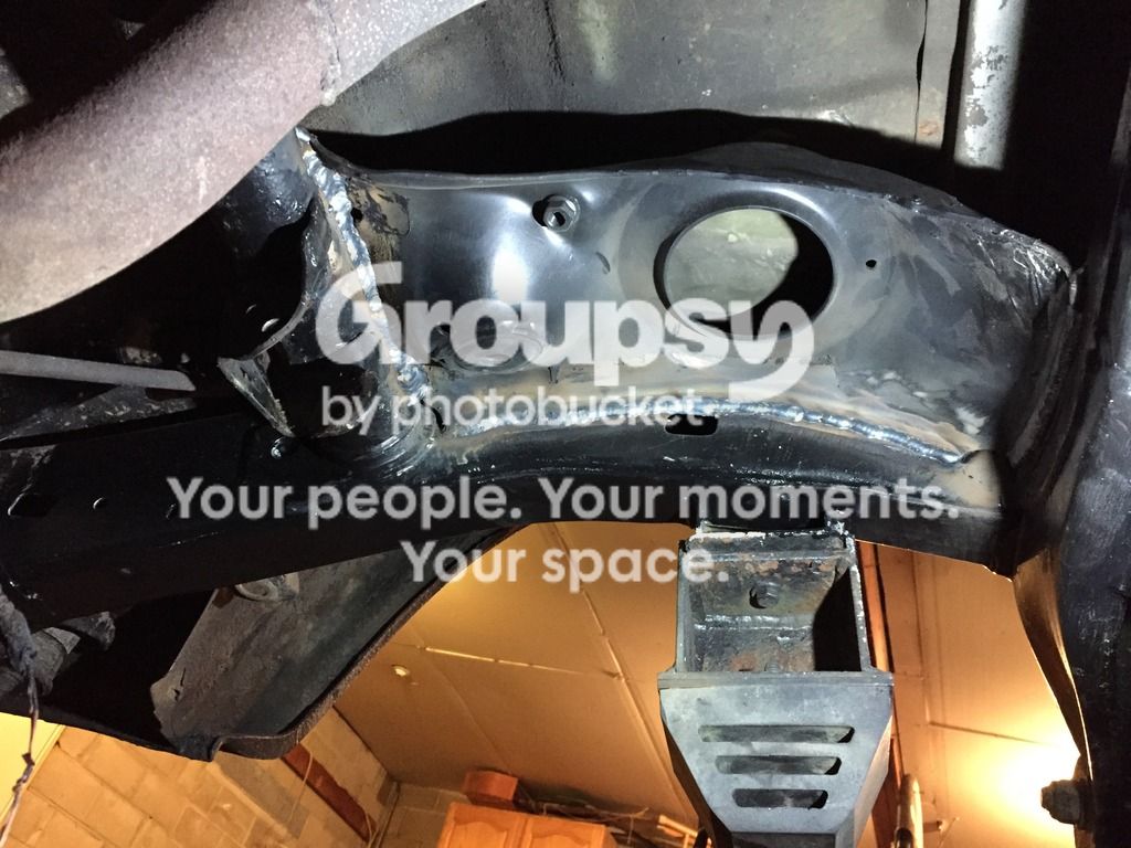

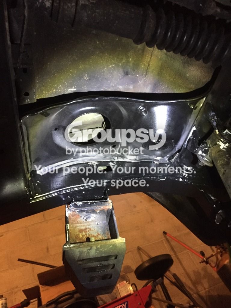

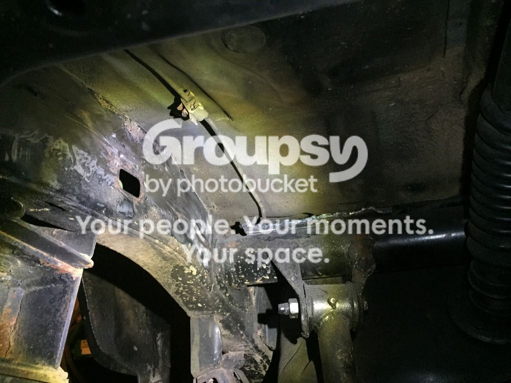

Top mount on the round cross member is impossible to completely remove it unless removing the whole body which is a no no. The replacement part will have to be slightly modified and welded from bottom. How ever everything is basically ready for welding. Good tip on removing old weld. Is to cut into with a small wheel cut. Make sure to NOT CUT INTO THE FRAME. Then get out a air chisel and you'll be amazed how it will pop of the old weld/metal. And you'll be left with just little be of grinding to do. Grinding down a weld is very very hard vs regular steel. Thanks to my friend he took care of it.

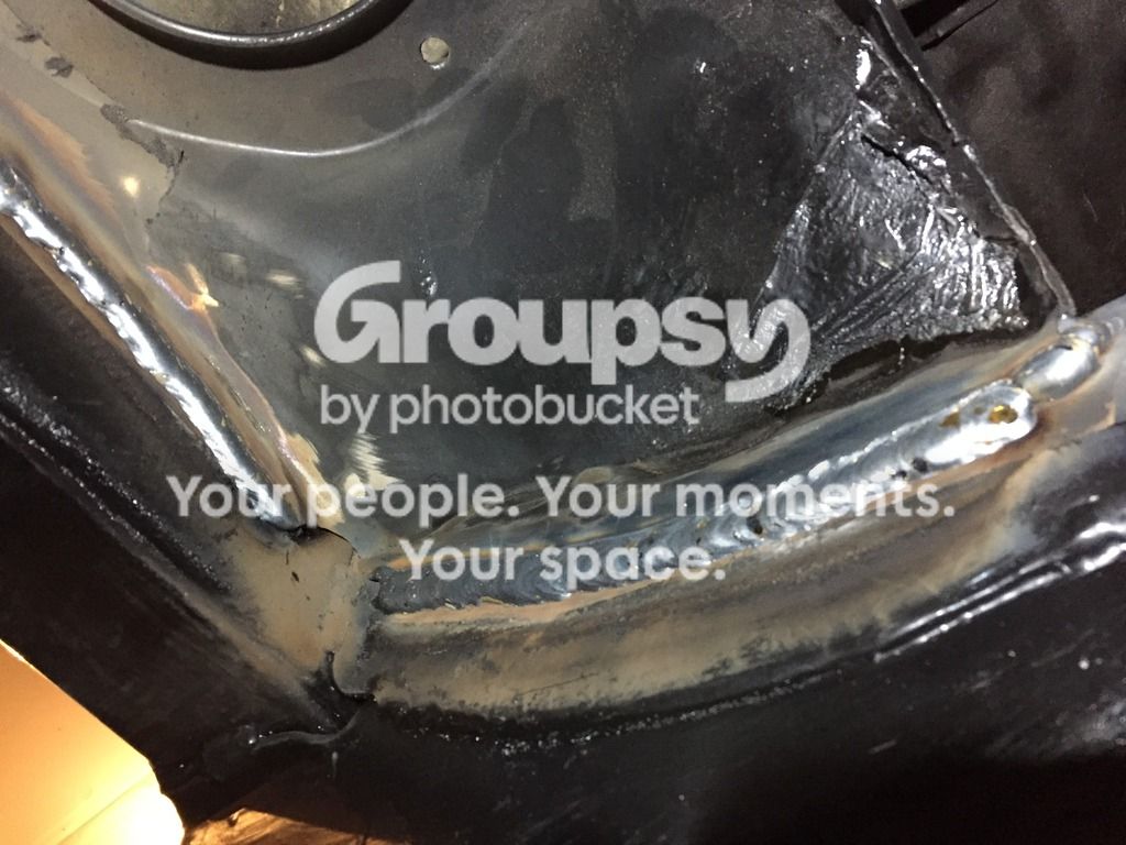

Alright boys and girl. UPDATE

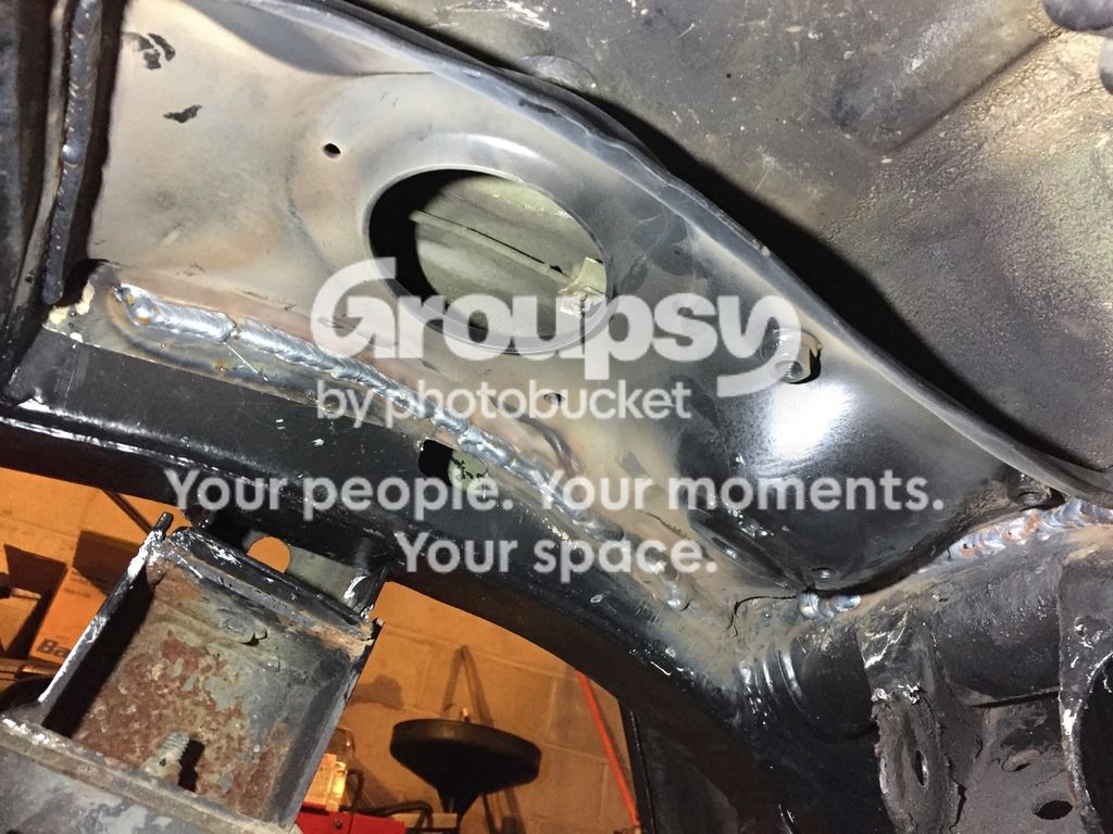

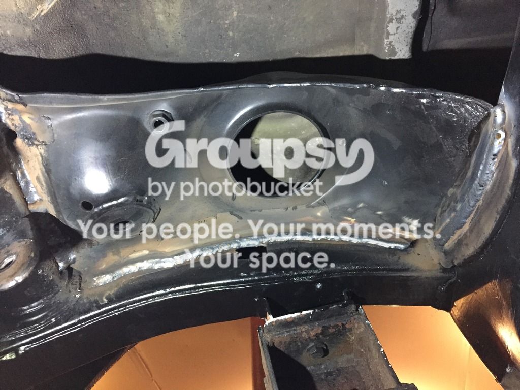

Primed and painted before the shock mounts gets welded. Because it will be impossible to reach some areas with a brush after the mounts are welded.

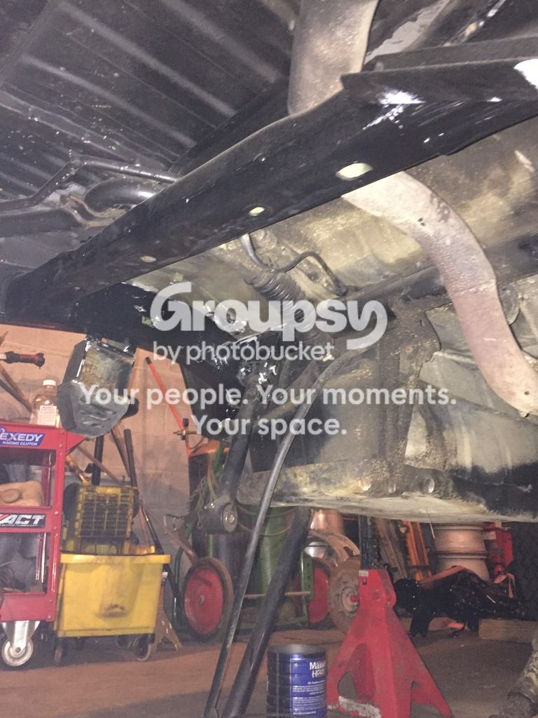

Test fit
Best believe it. It fits exactly in the same original spot. Only thing is we had to cut back the front part of the mount facing the front of the truck. The section that goes on top of the round cross member. But no big deal. My friend cut back the old mount as far as possible. And trimmed back the replacement one and it sits very nicely.

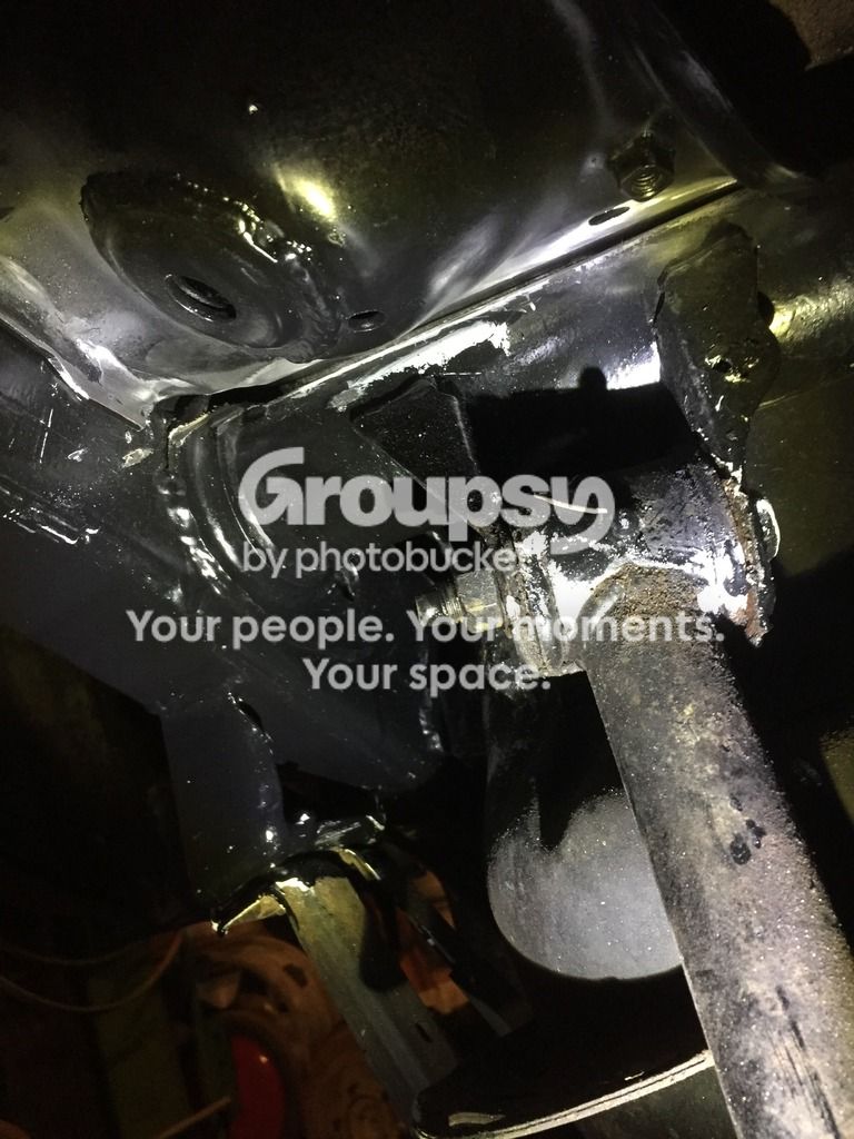

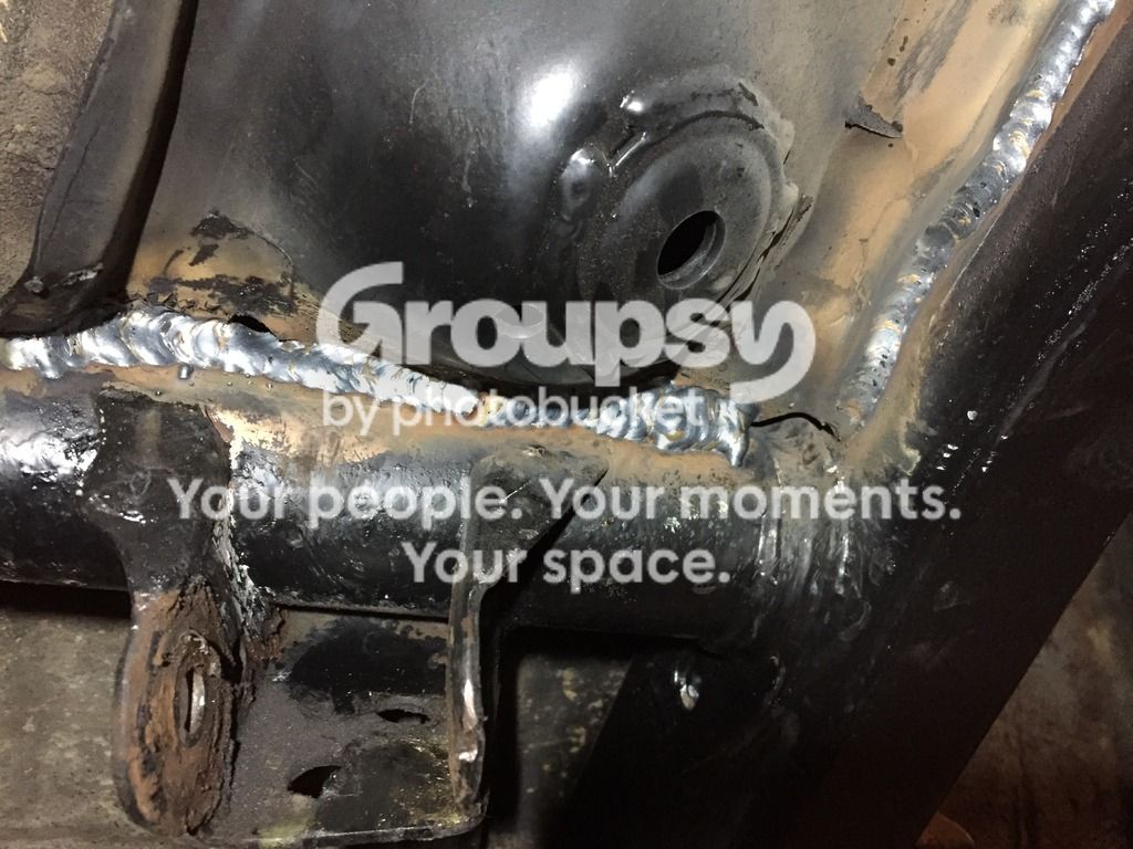

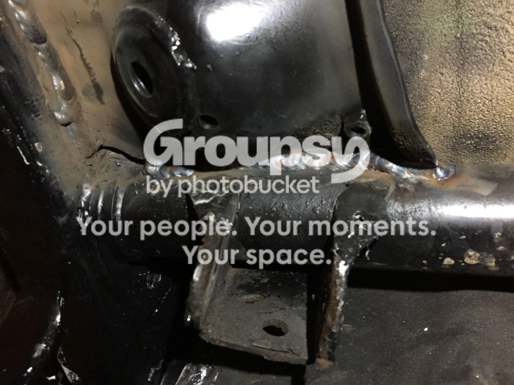

This was the hardest part to weld for my friend. The way the mount goes on the tube. It creates a big gap. The original mount is welded from too before the body goes on. But no big deal. He filled it in pretty solid.
The driver side.

Thanks guys. You know the hardest part of that job is grinding the old welds down. Big tip I can give you for that is cut in the weld with a cutting wheel. Then use a air jack hammer to just pop the weld off.

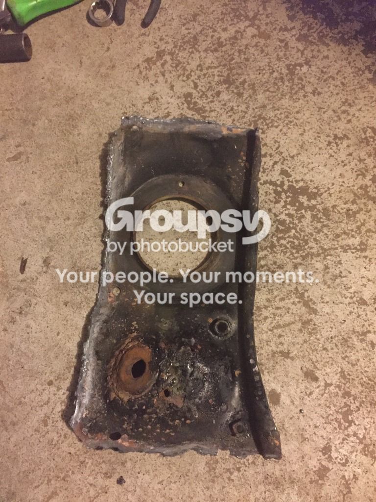

Anyways, the parts aren't expensive like I said. [MENTION=10169]TheDurk[/MENTION] was the one who gave me the part # for the shock towers. Big issue is how they are designed. It's basically a cup. Perfect area for muddy sand to sit. Thus eating metal away.

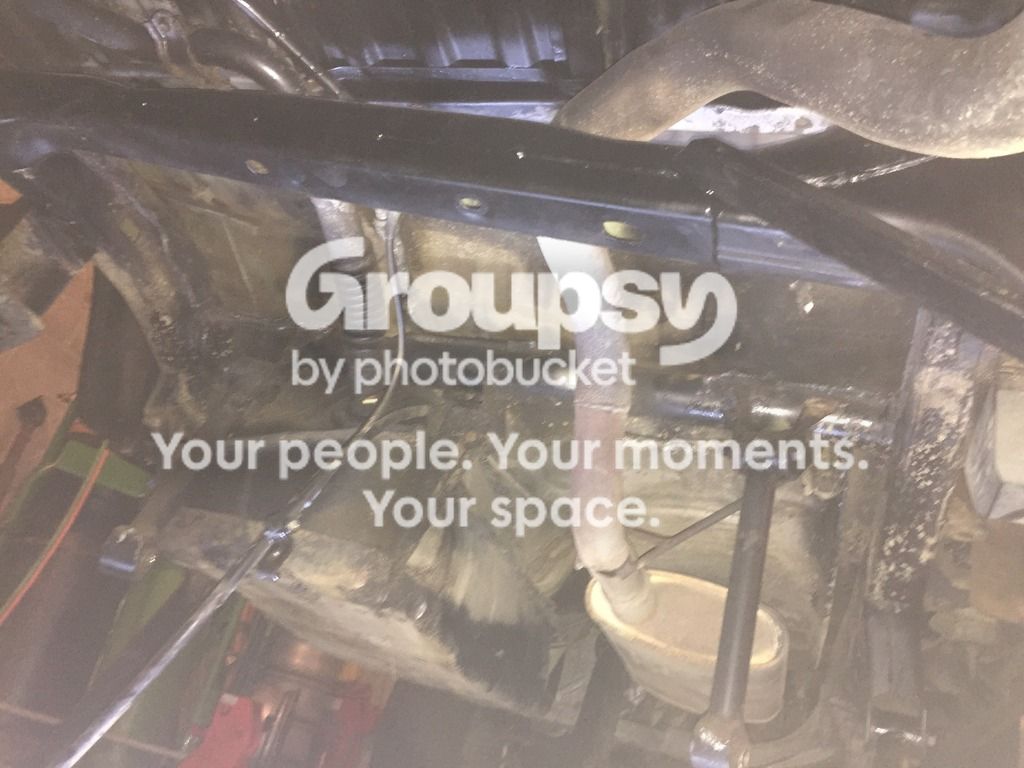

Before they got welded. I tapped the drain hole to the biggest size I can. Drain hole is close to a weld. Toyota welds like a thick washer which you mount your shock in. And I taped the drain hole in a small angle. So the water runs out better.
Then I used monstaliner chassis saver paint. Once it all got welded I went over with chassis saver again. Especially over the welds. I did like 6 coats. Thick to. Hardest area to get painted is the top area where it sits on the round cross member. So I just dipped my brush heavily and somehow got it in.
The metal is acivery think. Which is surprising to me that it rusted through. If someone could modify the cup design to like reverse cup. It will be better for longer shocks to. Anyways, .....
Forgot to add. We had to cut away like 1/2" of the metal from OEM replacement tower. Because the original tower like goes over the whole round cross member. So we just cut diwn a little and but it right next to the old one. Impossible to cut that area 100% off unless you have the body of. I hope you understand what I mean.

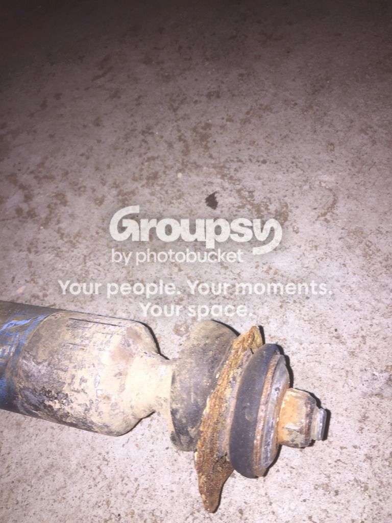

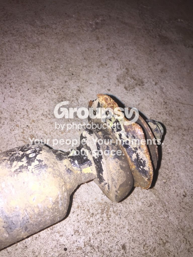

Again, depends which part is rusted through. Most likely it would be the shock area. So, if the shock is rusted through, YOUR SHOCK WILL HIT YOUR BODY, could actually even push through your body. Every time you go over a bump you will head a BOOM in the back. Thats the top shock hitting your body. If not, i doubt its rusted or probably soon it will be. Get under the truck and check it. Put your hand up top on the mount. If you feel and grab big chunks of metal, thats a good sign of it about to push through.
