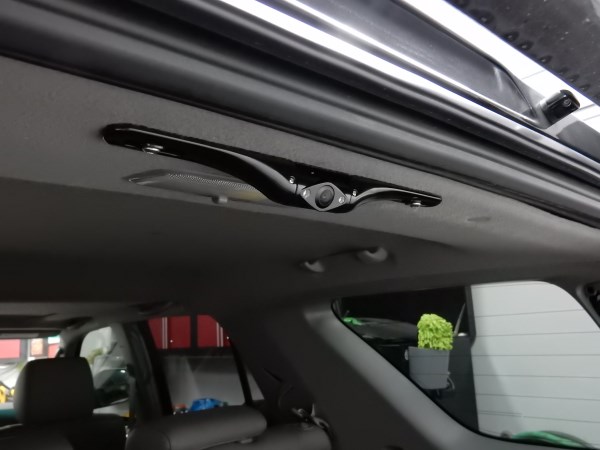

I hate having to wipe the camera lens when covered by dirt or snow so I put my licence plate style inside.
Wiper cleans the window and if need be, I just roll down the window.

My rear hatch and spoiler is always dirtier than the rest of the car. Physics. Low air pressure and the likes. Or I tell myself.
I think its every vehicle. Think its just worse on SUV's and trucks due to the big flat rear ends. My other vehicles, always have to run my thumb over the lens to clean em off before going anywhere.
Interesting ... that's two that have moved their license plate mount inside. I'm assuming that it narrows your field of view some ... how noticeable is it? And do you see reduced low light capability looking out through the tinted rear window?
I compare the view as another "fish eye". You do see less side to side as the body of the vehicle is in frame now. And its not as clear as mounted outside as you now have 1 more lens to filter thru (the rear glass). Night vision isn't the best. But these camera's aren't the best at night anyways. I do have LED reverse pods mounted on the bumper so that helps. (Reminds me, I need to cover up the LED's on the camera for night vision. They just glare and reflect on the rear glass when used).
Hmmm ... it's backing up in low light that I'm most interested in, so this might not be the best solution for me.

OMG That's perfect!
I've had a license plate style backup camera for more than a year but never installed it!
I didn't have the time to run the wires thru the hatch.
But this is easier in so many ways.
I may try this!

This is genius! I have been trying to find bullet cameras to install in the spoiler, I only found one that looks worthy, the COOLINT CT-106S. But after seeing your install I'm leaning a little more to an interior install for ease of maintenance and replacement when need to. Just need to weigh the pros and cons I guess. Obstructed view of the hitch, better outward angle, eventually a tire carrier swing arm, etc...
