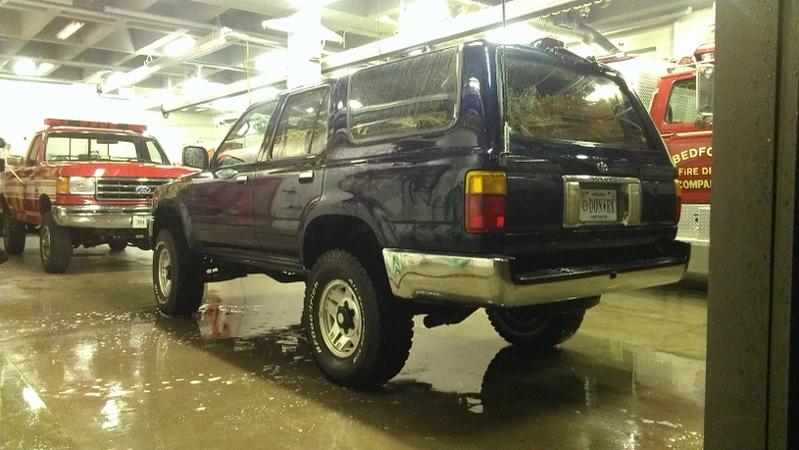

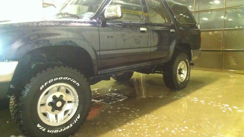

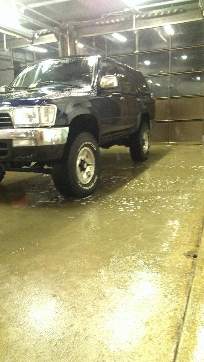

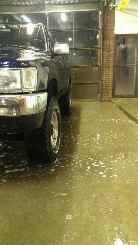

I've looked at the pictures of your truck and I really like the height. Were those pictures taken after you installed the springs and the spacers?
I honestly dont remember. I wanna say they were with the springs but not spacers. If ya can give me til tomorrow i have the day off and ill snap ya some better pics of the stance

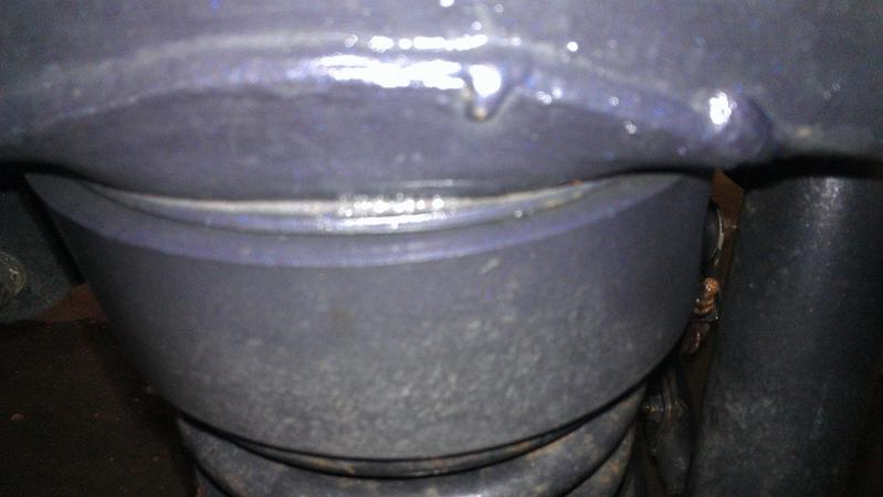

Here ya go... The pictures dont really do it justice. Due to the rain and it being winter I had to wash it indoors so this is the best i got. But ya can get the general idea. The spring i bout at rock auto for a fair price, the spacers i got on ebay for around $40. The close up is of the daystar spacer
ps they are also cellphone pics so they are of the best quality

They look perfect. The springs and the spacers level it out perfectly. Thank you for going out of your way to take those pictures.
