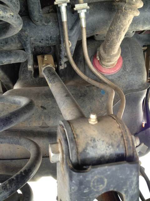

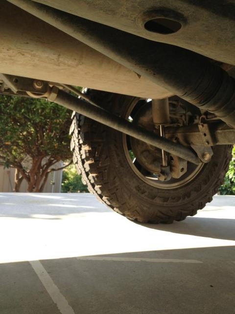

Metal tech lower links are offset so the link won't contact the axle with their long rear shocks as the axle "floats" through compression/droop cycles. A typical 3/2" lift could easily run toy outfitters lower links with no problems. Uppers are nearly identical. I run MT lower since I have their long shocks and TO up top (MT wasn't offering their uppers when I got mine). Both have poly bushings and will require some maintenance to keep the squeaking at bay. Both outfits offer great service IMO but MT will probably ship out quicker.

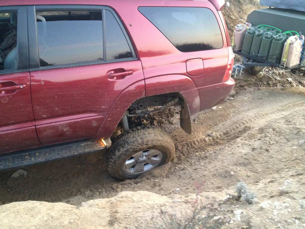

In most of these apps the rear shock limits the amount of flex. If you Install longer rear shocks you will get more droop. But it all works as a system, with the springs, bumpstops, sway bar, and upper/lower links synced to achieve your goals. How much lift do you run/are you trying to get?
When I was looking at obtaining more travel in the rear, I noticed that toytec did not offer extended bump stops. I also did not get a definitive answer on what size shock to go with.

The spring and shock combo that mt put together is amazing, I can run the desert at high speeds and it feels great. It also has lots of flex on the rocks.

You may want to do the lowers first, even Metaltech shows their stage 5 being lowers only and their stage 6 being lowers and uppers. Most people here would say the lowers are more important too as they get bent over rocks and such.
agreed, the lowers are much more prone to getting struck by a rock or something else on the trails. ive seen the placement of the uppers and i would think it would take some very extreme angles for anything to even get close to the uppers. although id like to eventually upgrade both, i decided to upgrade the lowers first since they seem like they're placed in a much more fragile spot than the uppers are.
