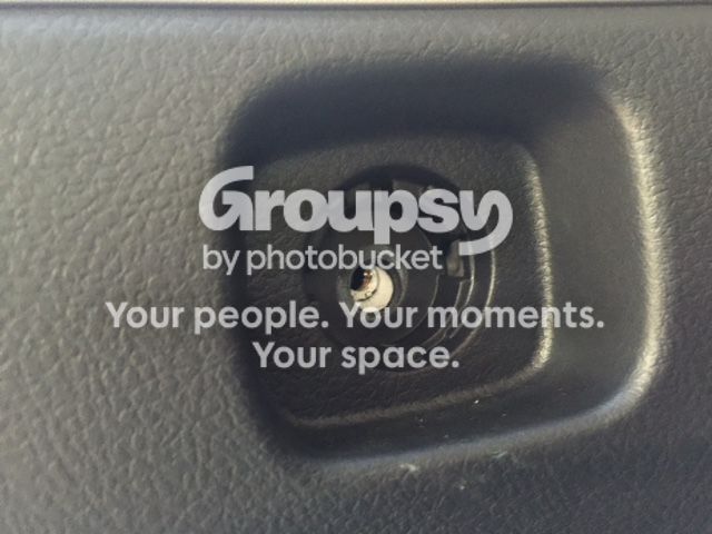

This is the front hole where the most forward bracket mounts up

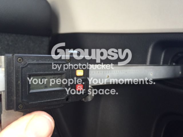

The space between the where the front bracket mounts and the threads behind it is .155"

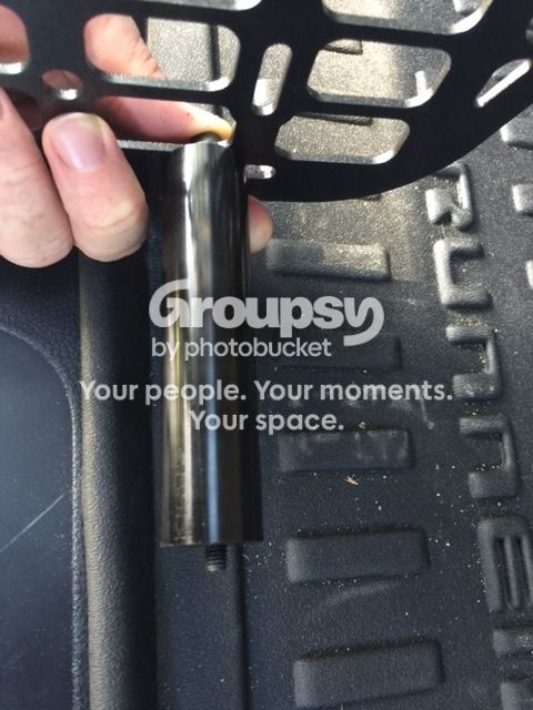

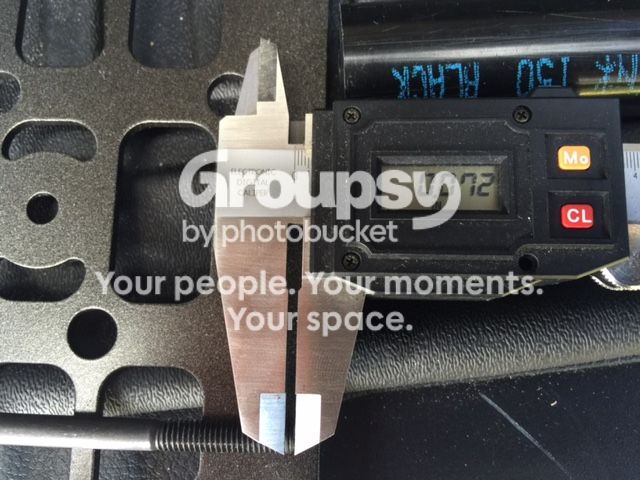

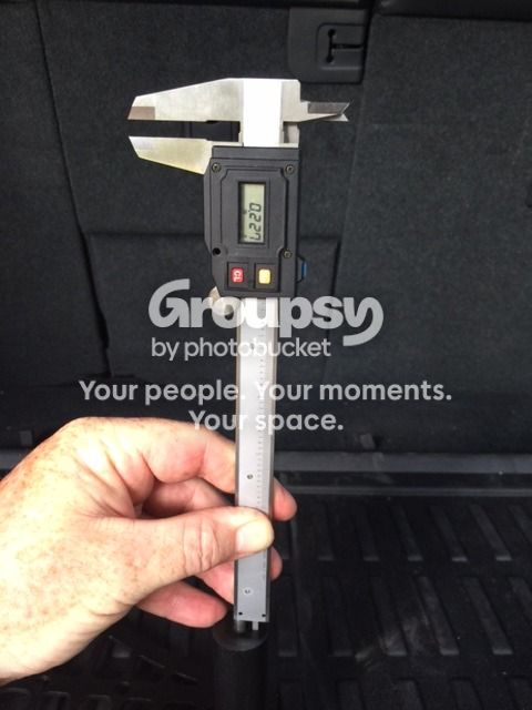

When you put the bolt through the front spacer, you are only left with this much thread to work with. .227"
.....so, .227" minus the space i have left to work with, .155" leaves .072" or about 1 and a half threads to hold it in place. I'm going to have to either find a shorter spacer or longer bolt.
I had the same issue, i didn't use the washer and it threaded perfectly.
