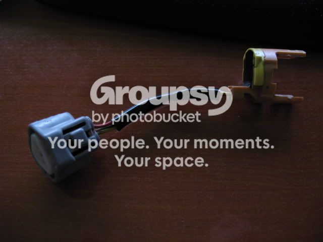

Years ago on a camping trip I found the rear window down and refusing to go up with any switches. I managed a bush-fix to get the window up and disconnected the motor once it was up.
At home I diagnosed the issue to do with the little wire harness slip ring that the key operates inside the hatch. I removed the little harness and the window has been fine ever since (although I can't roll it down with the key anymore, still operates fine with the dash switch).
Open up the hatch panel and disconnect this harness at the grey connector to see if your problems are solved.

EDIT: IT WORKED.
Wow, I'm impressed. Thank you, [MENTION=59497]sportscarfan[/MENTION]! Everything is back to normal! I was wanting to fix this so I got out there tonight and took it all apart. Took some finangaling to get at the connector and get it apart, but now it is working better, just by taking the grey plug apart.
Do you think this is a bad wire or such? I would like to keep the tailgate functionality if possible - perhaps I can look into replacing it.
#7 on the parts diagram - associated with the lock cylinder...
https://parts.camelbacktoyota.com/p...siteid=214329&vehicleid=68848&diagram=8414555
~$95. #6905535070 for the rear door lock cylinder and sensor wire. Not sure if the issue is with the wire itself, or the lock cylinder messed up...
Wow, glad to hear that it worked!!
I think the issue is inside the green slip ring portion of that mini harness where it connects to the lock cylinder. I made a weak effort to clean/repair mine, but it didn't work out and opening the rear window with the key wasn't worth the replacement cost to me. In fact, the mini harness still sits on my desk today...
