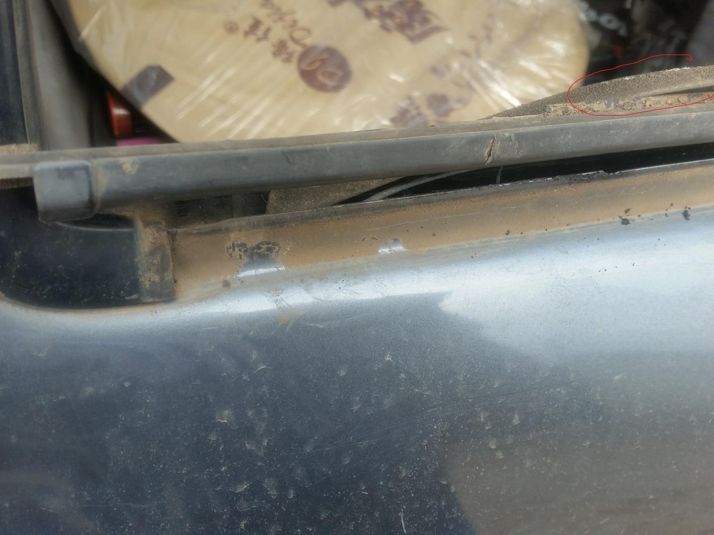

I'd really like to repair the rear window seal. Is there a clean permanent way to do this?

The weather stripping is in two parts. The part that is black and still shines is about $100. The glass scraper part # 68290A which looks faded in your picture is about $20. I replaced my scraper. It took all of about 4 mins. It pulls out and snaps back in.

The part you're seeking is the exterior "Belt Weather Strip" , the same part referenced in the other topic you posted in yesterday, but you were asking about the inner strip not the outside strip, here's a link to the parts list that has the outer belt/strip, number 3 on the list and diagram, part number
68290-35031
https://parts.conicellitoyotaofcons.../glass-lift-gate-scat/?part_number=6829035031
If you decide you need the inner belt which will do nothing as far as keeping water out, it's number 4 on this parts list and diagram.
https://parts.conicellitoyotaofcons...-0l-v6-gas-engine/body-cat/interior-trim-scat
thanks @ AUseeker , discovered my error, its the part circled in red [looks like a belt] that has gone bad in my truck, i thought that part is sold alone, just understood now that its sold together with the outer seal as one unit...right?
