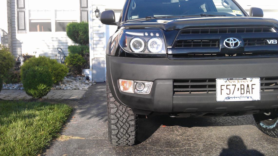

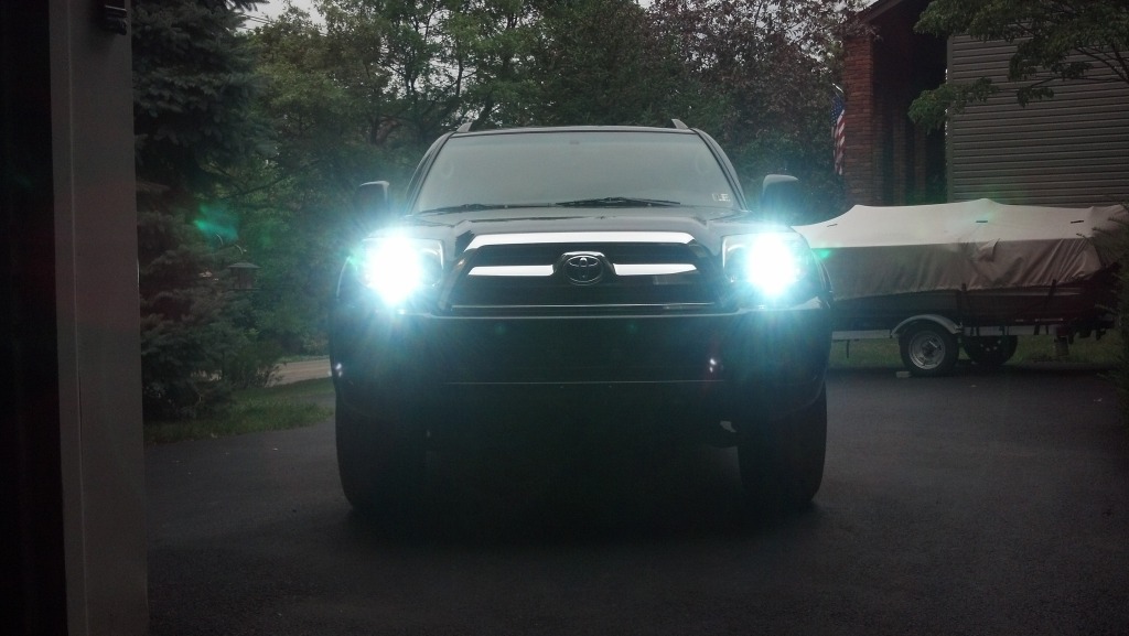

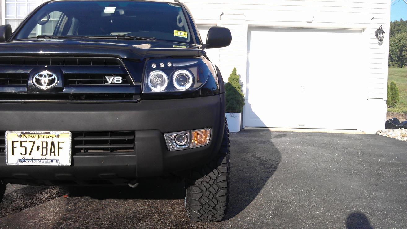

Those are the Spec D lights right?
Did they come with the bulbs? If so, are they the whiter/normal looking light or the bluish light?
Personal opinion, I don't care for the bluish light and am curious what they come with. Halogen looks like a typical OEM brightness/color correct?
DDM 35W 5000k's. Love them to death! Although the 1st pic makes them look much more blue than they actually are. There is only a very slight blue tint

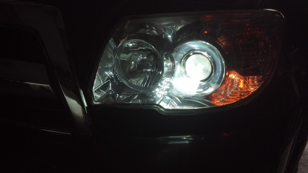

Yes they come with regular halogen bulbs just like the 06-09 housings have stock. I did a 6000K HID conversion which makes them significantly brighter and because they are 6000k they have a hint of blue.

I don't doubt his expertise and maybe with a computer and a bunch of testing equipment one could find minute increases in "glare and backdazzle" but frankly it has to be minimal. If one looks at the pictures in my thread, one can see that the greatest increases in lighting is where the light is supposed to go. Where it doesn't effect other drivers. The edges are just filled out a bit more but not significantly. Definitely more friendly to your fellow drivers than HIDs. Real world results; I have never been flashed in the U.S. or overseas (where people drive smaller, lower cars). My car passed the German's infamous TUV test (vehicle inspection done by engineers) so I think I'm good to go.
I highly recommend this conversion if you want a bit more light without going HID.
