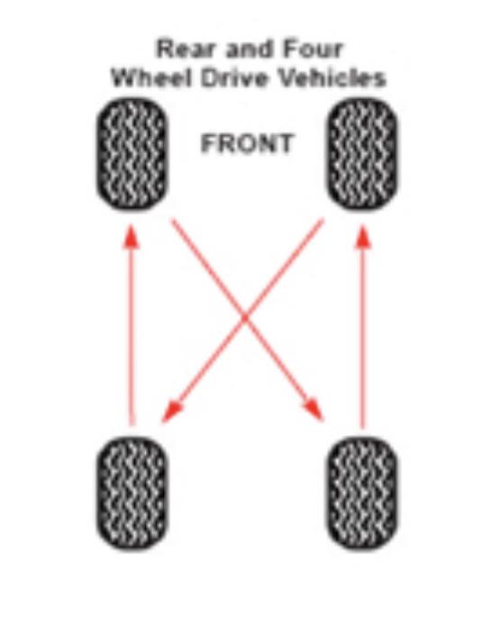

Rears move to front, same side.
Fronts move to back, opposite sides.
RWD.....4WD
yep, or straight back. crossing isnt always necessary.

Tire manufacturers generally recommend the patterns like in the pic, but the vehicle manufacturer has the final word and rightly so. Just like tire pressure.

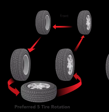

I do the 5-tire rotation shown on the top right of the chart. Tires wear evenly, and I get about 20% longer tire wear, but only because the wear is spread across 5 tires. Costs more for 5 tires when they need replacement, so the cost is the same. At least you can be pretty confident that your spare will be good if /when you have a flat.
this is a couple of years old but if the spare rim is the same as others , rotation of the 5 tires is a good way to go. the tire [spare] is exposed to the elements so rotation of it does make sense since the rubber will breakdown. so if not part of the rotation the spare will have full tread depth but damaged rubber.
Sorry to drag up an older thread, but i didn't want to create a new one. I acquired a 5th trail wheel to start 5 tire rotations. While I am familiar with the above-mentioned 5 tire pattern, Discount Tire, where I purchased my 5 tires, has a different pattern, where the PF gets moved to DF. This seems to contradict the moving fronts and rears together, as suggested by the other diagrams. Any thoughts?
