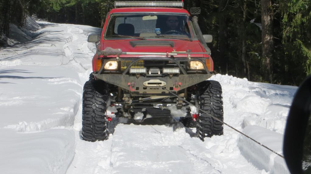

Use the big front rings already there. For the rear, use the hitch.
The photo is a 1984 T4 helping me out of a snow pile with the front ring.

^^ Haha. Yep. Don't fall for any BS you read on here or elsewhere about them being tie down loops. They work fine for recovery. You won't break them unless you're doing something really wrong or stupid or probably both, and even then you probably won't break them.

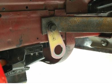

If they were tie down points only Toyota way over engineered them. Tie down points for transport look like this.
