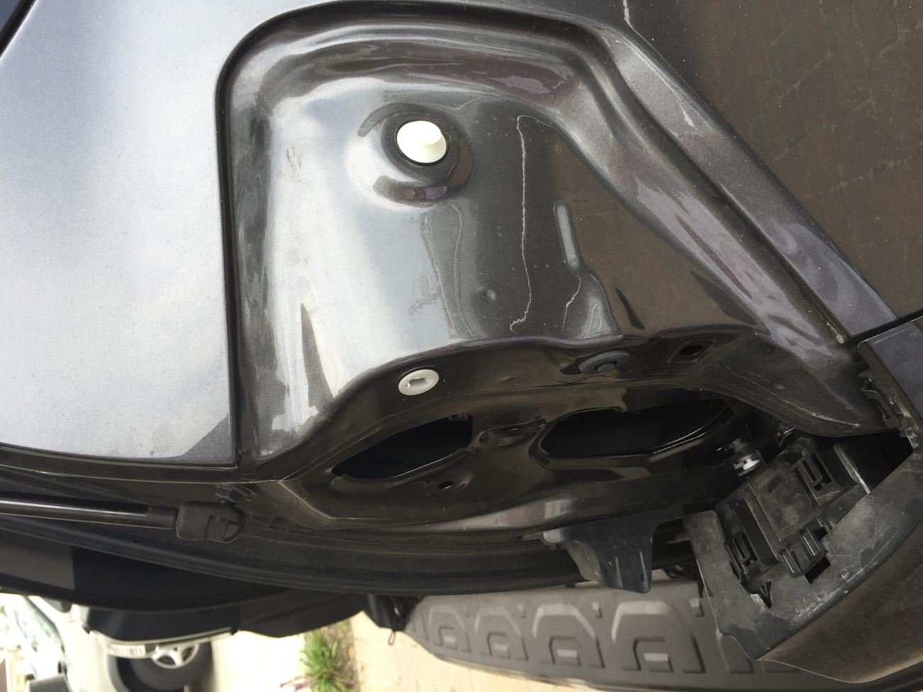

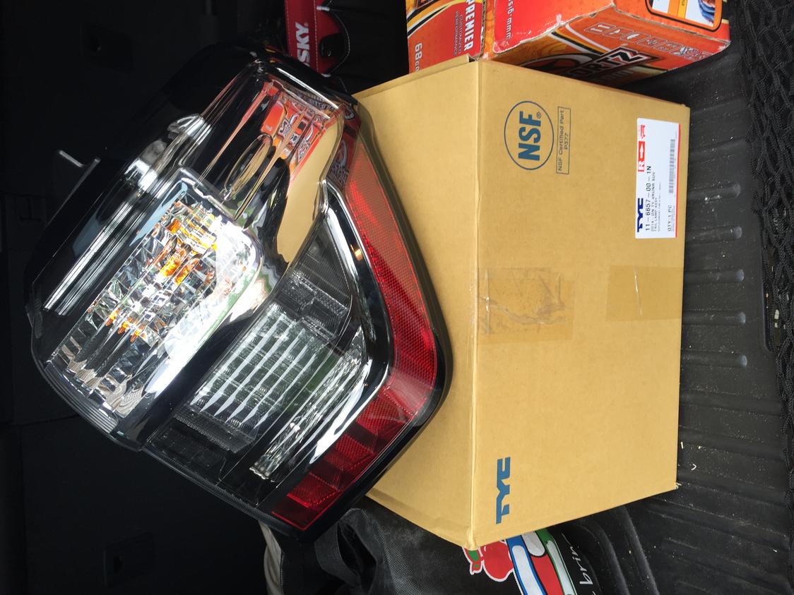

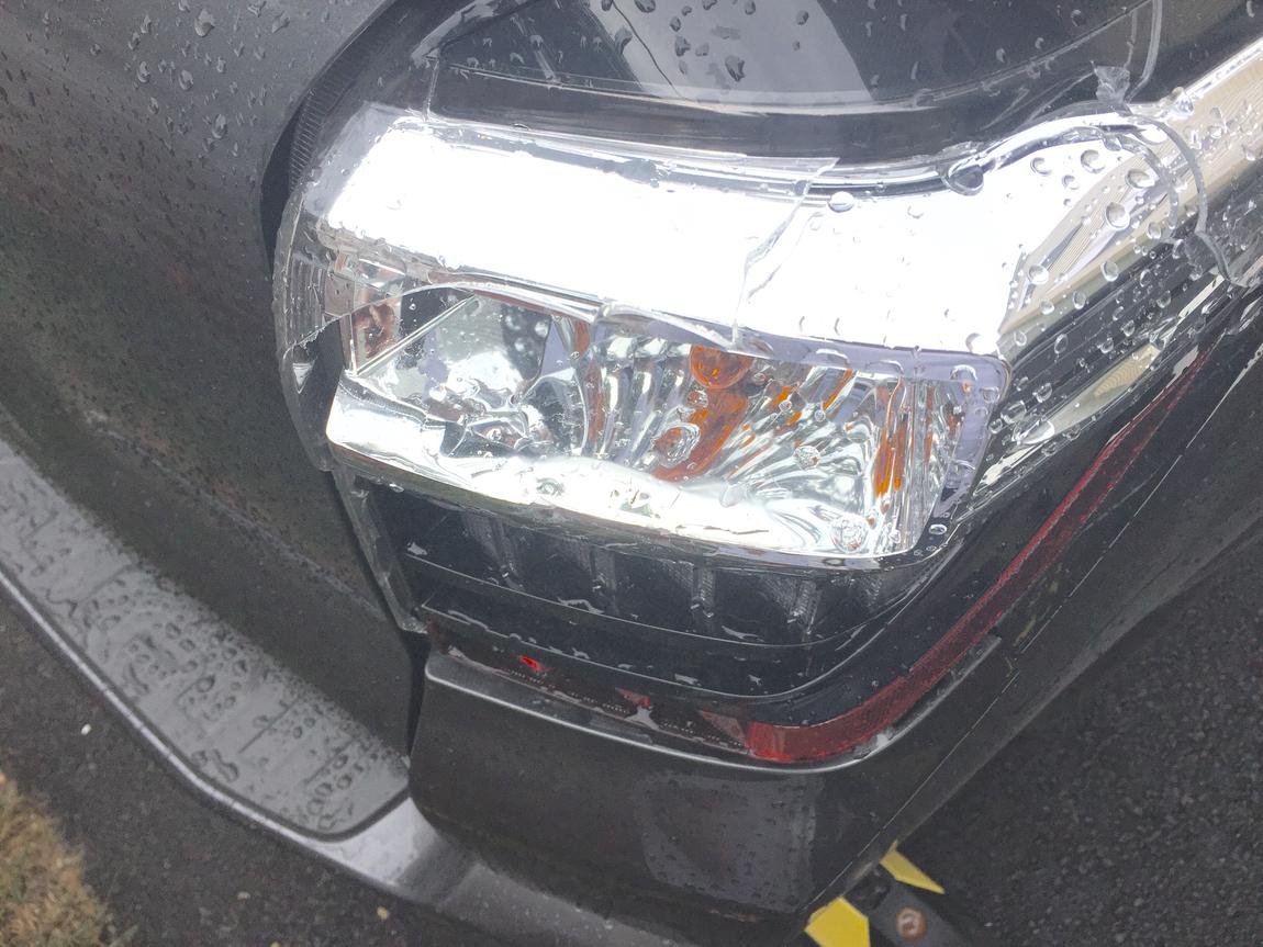

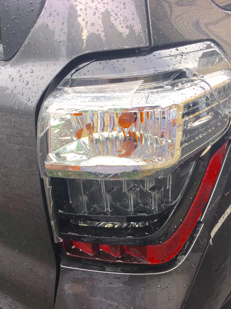

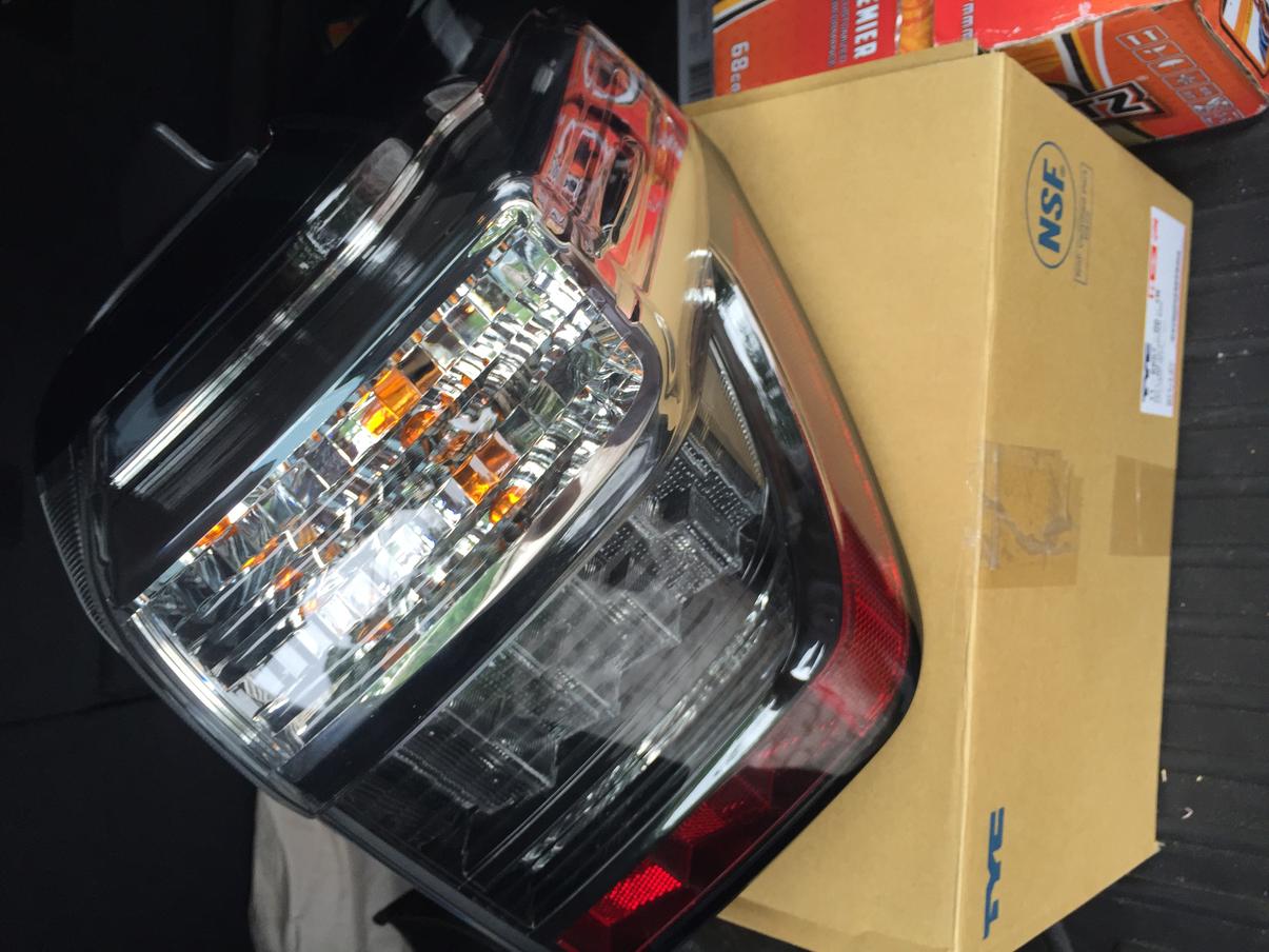

Good to hear! Pictures of the busted light and replacement. Dunno why they are sideways but you get the idea. :shrug:

I have them on my truck as well. I was just stating that I doubt for $120 they were OEM.
They are a great match, however, I've received two that started getting water into them. Both were passenger side. My driver side has been great. I'm waiting for my third passenger side to come in the mail. The second time I put a bead of silocone around the opening when I installed it and it still got A LOT of water in it. Fingers crossed third times a charm.

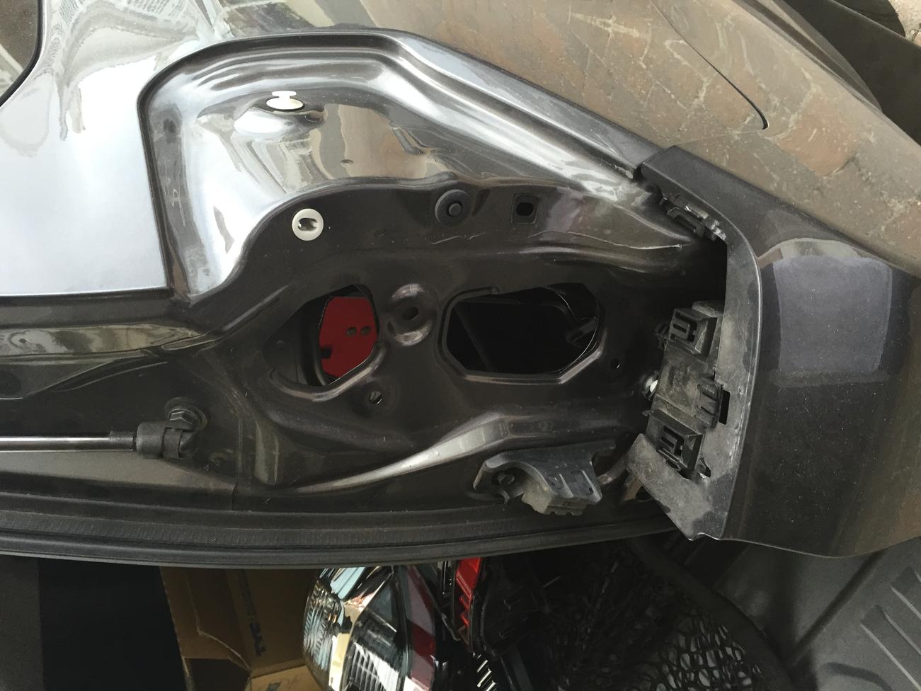

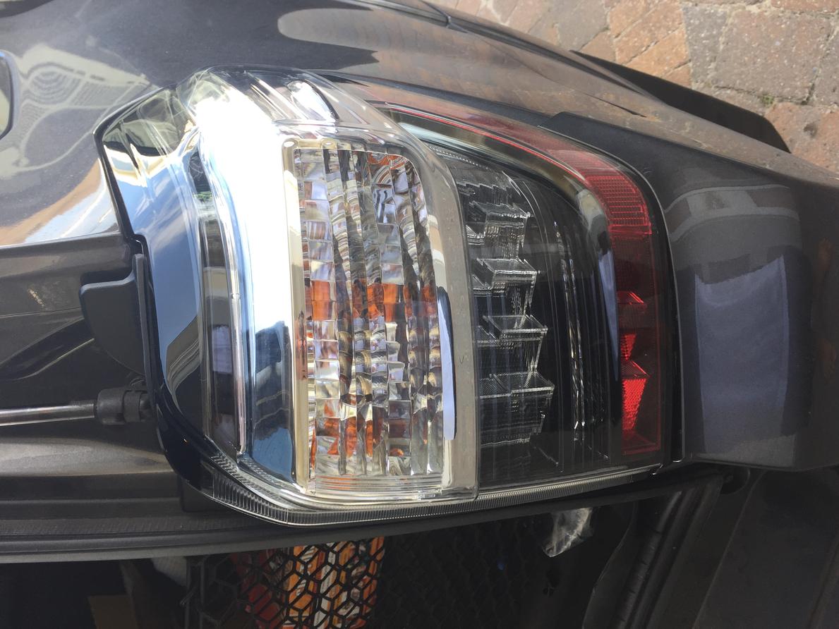

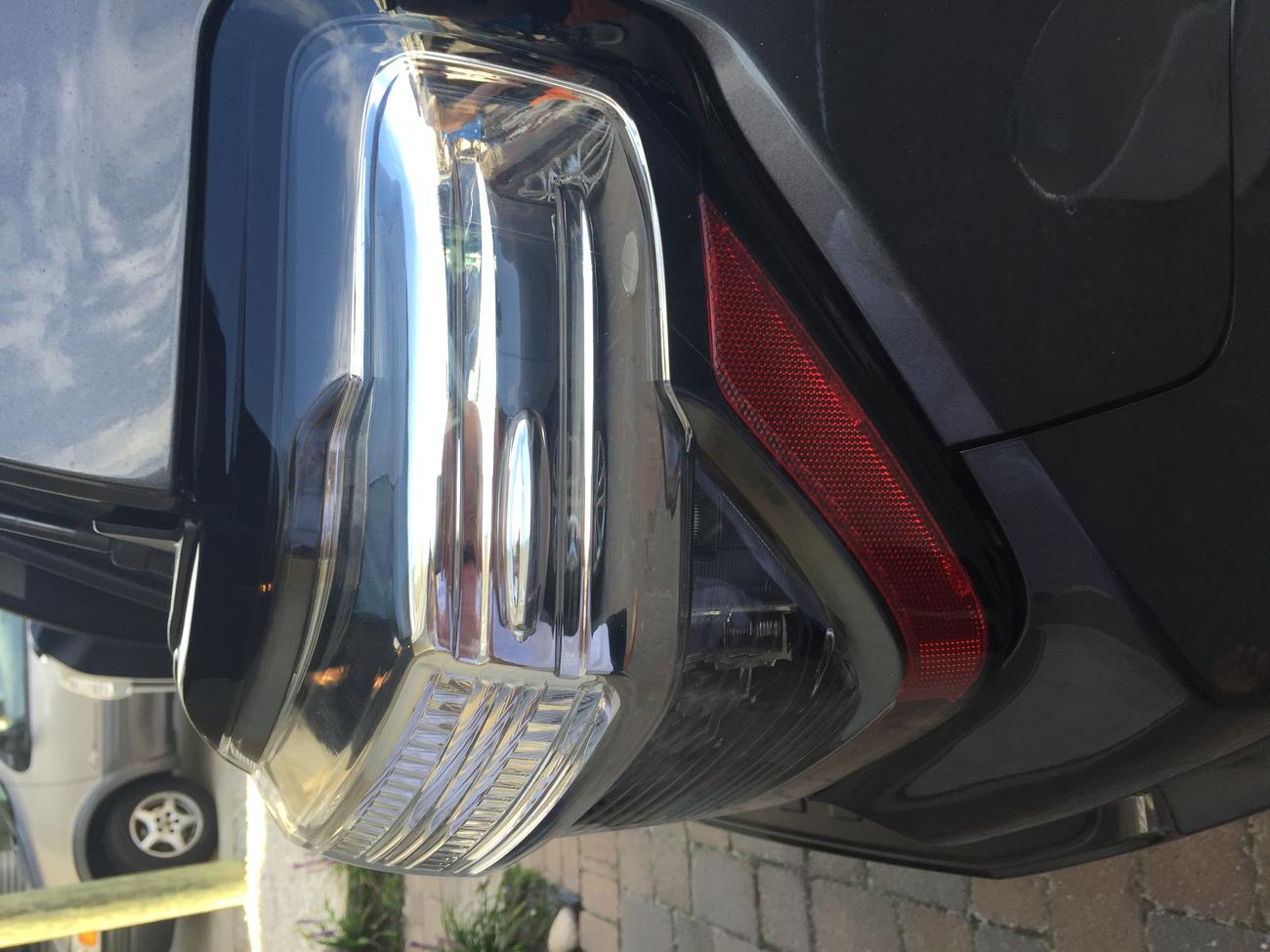

Thanks again for everyone's help. The light came out so smoothly. Two nuts and a firm wiggle and the light assembly popped right out. New light installed easily and looks great! One thing to note is that I did have to use a deep well 10mm to get the nuts out due to the long screws. Other than that it was a breeze!
