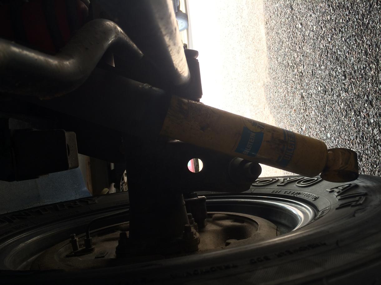

I have a set of rear Bilstein shocks/struts on my 1997 4Runner (not lifted) and I love them. This weekend, though, I noticed it was riding weird. After inspection, I saw that the lower connector was completely off (see picture). It looks like the bolt/nut/bushings are all gone now, so I am hoping I can just replace these parts rather than buying a whole new set of shocks. I know this is an easy repair, but cannot find anybody who sells just those parts.
Any help is appreciated!

To me it looks like the rubber is still on the lower shock attachment where the bolt installs You just need the bolt. A quick run to salvage yard, or hardware store, you could use a bolt and washer. Or OEM, they sell them at dealer and online. Or any toyota shop might have one.

It appears he still has 1 yet but there are 2 bushings!
Everything needed for one shock
Bushings depending on the VIN or month of manufacture:
Qty 2 - BUSH, REAR SHOCK ABSORBER 48385-19007 4 1995.11-1997.06 RZN18#, VZN18# $1.73
QTY 2 - BUSH, REAR SHOCK ABSORBER 48385-19009 4 1997.06-1998.07 RZN18#, VZN18# $1.73
Qty 1 - WASHER, REAR SHOCK ABSORBER CUSHION, NO.1 48948-03020 2 1995.11- RZN18#, VZN18# $4.06 (nearest to the bolt)
Qty 1 - WASHER, REAR SHOCK ABSORBER CUSHION, NO.2 48948-03011 2 1995.11- RZN18#, VZN18# $2.87 (between inner bushing and axle mount)
Qty 1 - BOLT, W/WASHER 91619-G1222 $1.13
