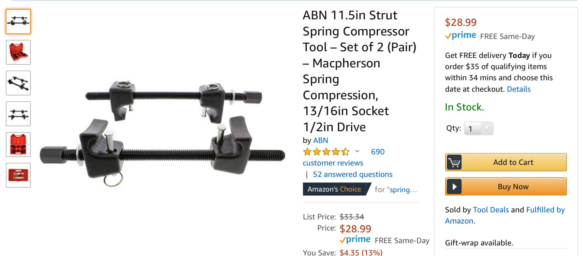

I picked up a pair of KYB upper mounts from Amazon when I replaced my front struts/springs couple weeks back.
Also picked up a low cost but good quality spring compressor on Amazon which worked out great.
