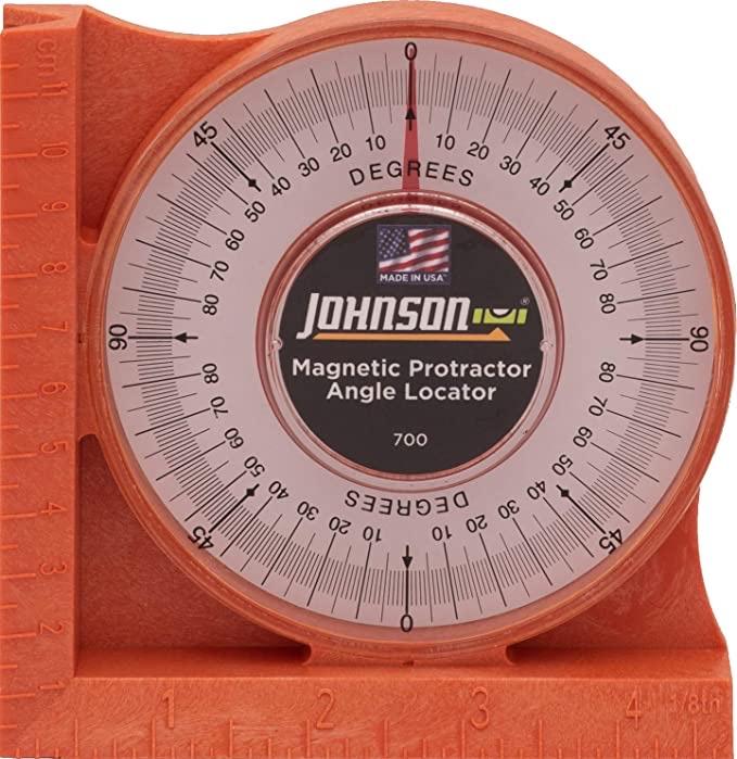

welp I went and bought one of these little guys and took some measurements. Trans was just under 90*, rear was 95*. Guess I'll be sending Opt Offroad a check :flame:
If you have a 4wd then your driveshaft angles will be different at the transfer case and rear differential. Your rear pinion should be pointing at your transfer case flange.
Here's an article showing the difference between the two driveshafts and how the pinion angle should be: Driveline Geometry 101 – Tom Wood's Custom Drive Shafts

Yeah I saw that after I took my measurements, thank you. Which made a lot more sense, I was under the impression I needed to reduce my angle which seemed completely unlikely and the opposite of literally everyone else on here. Even just glancing at it you can see it's not totally aligned to the transfer case so that's probably my issue
