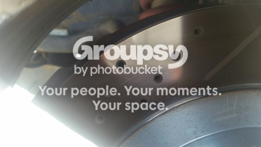

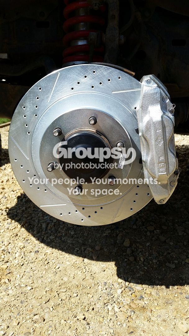

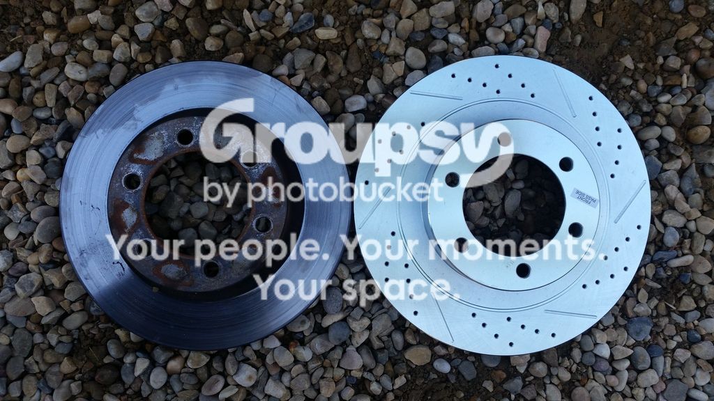

I second vote for Powerstop rotors and pads. Don't use OEM as others suggest. There is no comparison and no going back once you try PowerStop brake kits. Huge difference in materials, finish, performance and cost. None for OEM win, seriously.
20150508_183903.jpg~original
20150509_115102.jpg~original
I thought the drilled and slotted were for race cars and cracking was an issue with them. Is that no longer the case?
I think it's another one of those myth spreading around. My PowerStop rotors and pads do not, crack or cause warp-age unlike NAPA and OEM rotors and pads I have used in the past. Keep in mind not every rotor made equally. As you can see on picture below there is no stress cracks.
20150810_143618_resized.jpg~original
Slotted and drilled is not a requirement. You can install same rotors but without slots and holes, its really up to you if you paranoid. I personally never had any problems. BUT, HUGE BUT. I do not off-road. If you do, avoid slots and holes in rotors altogether since they been reported to fill up with mud, hard to clean on their own which causes unnecessary wear to both rotors and pads.
