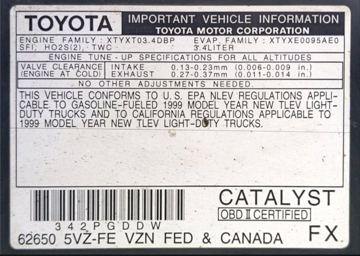

SFI, HO2S(2), TWC
And actually i do live in California. I'm in Sacramento. My mistake for not being clear. Sorry for causing all of the trouble by having you reiterate needed information. I appreciate your help and patience.
That text hints at non-CA spec vehicle. Very confusing.
in '99, the CA spec was an AF sensor, O2 sensor and two cats (TWC)
in '99, the Fed spec was 2 O2 sensors and one cat (TWC)

Yeah I'm thoroughly confused too. That code means this:
SFI = Sequential Fuel Injection
HO2S (2) = Oxygen (O2) sensors, two (2)
TWC = Three way converter, just one
I looked up your engine family code XTYXT03.4DBP and the California Air Resource Board thinks you have a 1999 Toyota Tacoma. Is that correct?
XTYXT03.4DBP Test Group / Engine Family Toyota Emissions
The 4Runner and Tacoma share a lot of things but they have differences as well. It may be that the 1999 Tacoma doesn't have a 2 catalytic converter version. Also I live in Citrus Heights, like 15 minutes away from you ha.

90% correct
That engine family code is for a federal emissions vehicle, yes.
My 4WD 4runner with federal emissions has the same codes except the engine family code ends with the same 4DBP, same as the [MENTION=303874]rrodness1970[/MENTION]
Here's my sticker for reference
[MENTION=303874]rrodness1970[/MENTION] can you just post a pic of your hood sticker and validate, visually how many cats you have?
EDIT: just reread, understand now.
You need the sticker that came with the cat the PO installed that has the EO# for the installed equipment so the tech can validate what was installed.
Without that, and it's a good thing you are in Sacto, you will have to make an appt with a DMV smog referee, located in Sacramento, and get a review and an exception, and have it documented on the CA registration database under your trucks VIN that your installed equipment conforms with the original equipment of the vehicle - which they can validate using the VIN.

Sometimes the EO# is stamped on the underside of the cat itself. It should start with a "D-". I think you might be on to something, there may be a non-legal catalytic converter on there. A unaltered federal emissions 4Runner will pass in CA with no trouble as long as it passes the tailpipe emissions but it seems once you change the cat to aftermarket it gets tricky for some. Mine passes just fine but like I mentioned, I have a "good enough" smog shop I go to.
I still think the fact that the engine family code brings up a 1999 Tacoma is throwing off the smog techs. Might be why it got refereed in the first place.

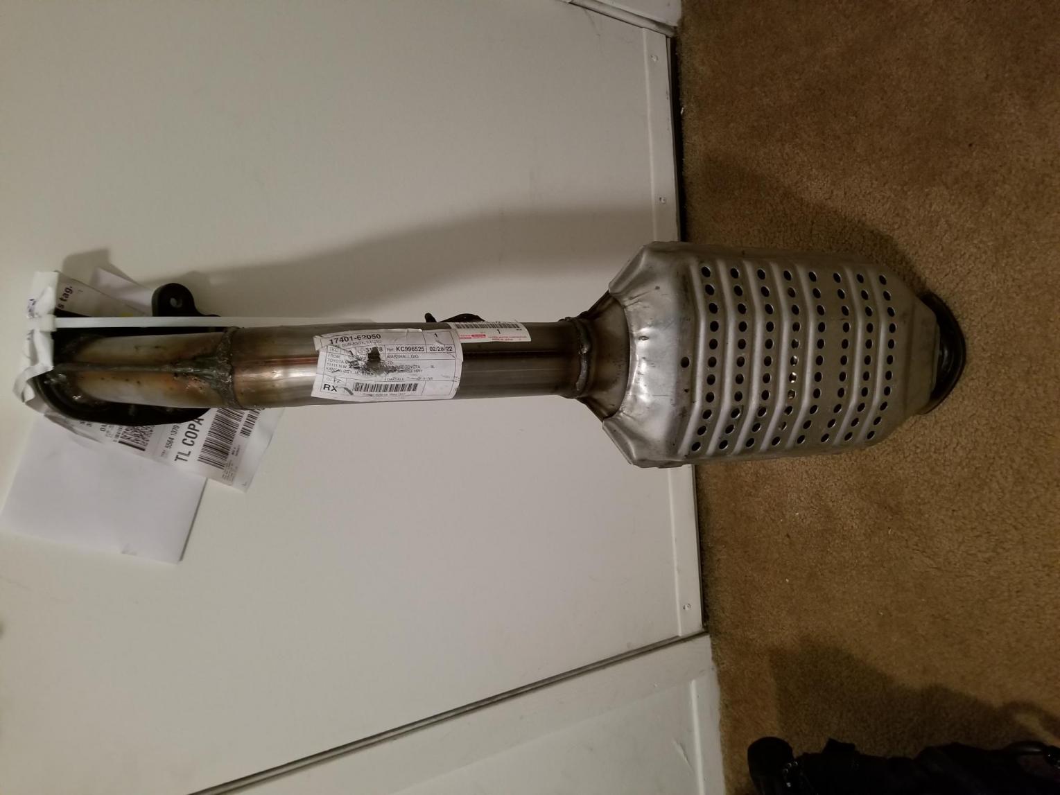

I went to the dealer and just purchased another cat. if i am understanding the question right.
Every Toyota dealer site I look at says that PN is not available... DISCONTINUED
Magnaflow 27301 is available in the aftermarket, however
