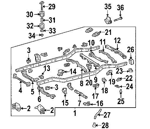

The reason I asked it because I thought I had found it in this parts diagram.
#4 Looked to be the correct bar to me.

I'm having this cross member replaced at some point. I'll probably replace it myself. #4 is the correct part. does anyone know the part number and where to buy it?

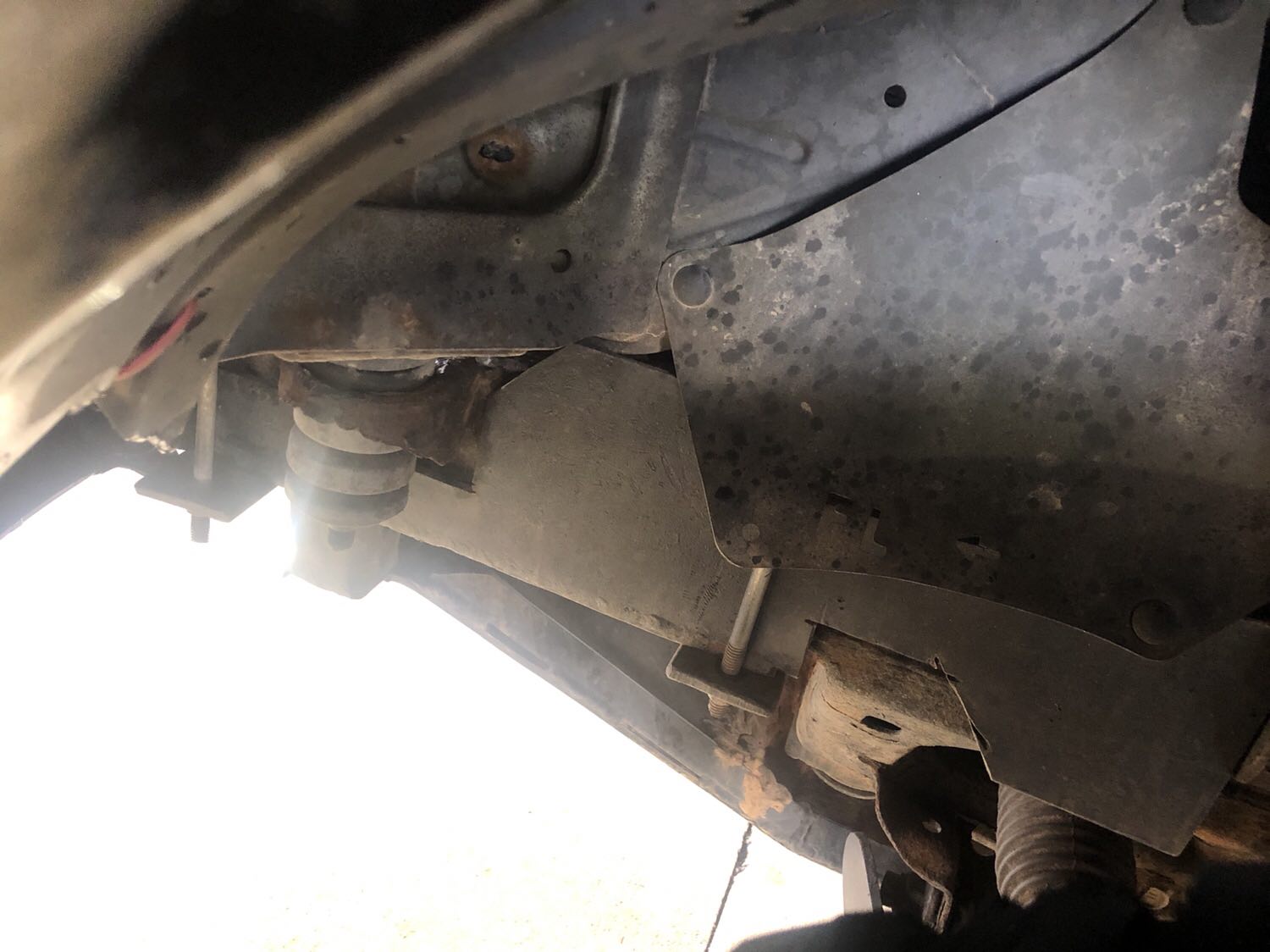

Quick picture update, since there was nothing to weld plate steel on to, we built sleeves. They are currently held on with a pair of U-bolts. This coming weekend we will also be installing a pair of 3/8” grade 8 cross bolts through the frame and sleeves. We will be using 3/16” flat stock cut into 2” squares as washers. IMG_0997.JPG
