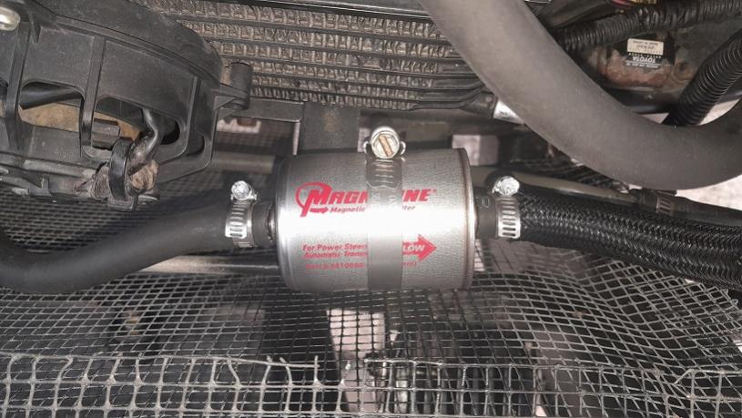

I also found this comment on another forum that sound like a good idea and may be cheaper in the long run.
“The pan “filter” is just a screen. I wouldn’t plan on replacing, or cleaning it. If I was just doing the fluids, I would install an inline transmission filter on the return line from the radiator. They’re good for about 30K miles. I use one on my Tacoma, will put one on my 4Runner. The fluid on my Tacoma went from a very dark cherry red to a red color. So, it does work. Besides, it’s a lot easier to change an inline filter than to drop the transmission pan to mess with the internal “filter”(screen).”
Magnefine are supposed to be good quality. Not hard to install. I'm probably due to replace mine. Quick search says 30k miles is a good interval for these. ymmv
