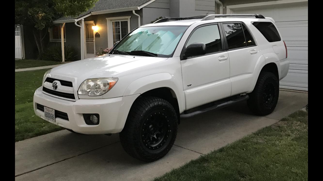

Here is the final product guys:
(Ray, yes I waxed as the final stage)

Looks great! Since you are a beginner go and get the Griots Garage DA Polisher kit for like $159. It is well worth it and for a beginner this is a very good quality machine that is really easy to use and will give you great results. I am about to do the same to my wife's Sienna. It has lots of oxidation and swirl marks in it. I also purchased the Griots BOSS System ( Best of Show System) with the correcting cream, perfecting cream and the sealant along with the pads. Also doing it on your own gives you more pride in your own work and in your vehicle.
