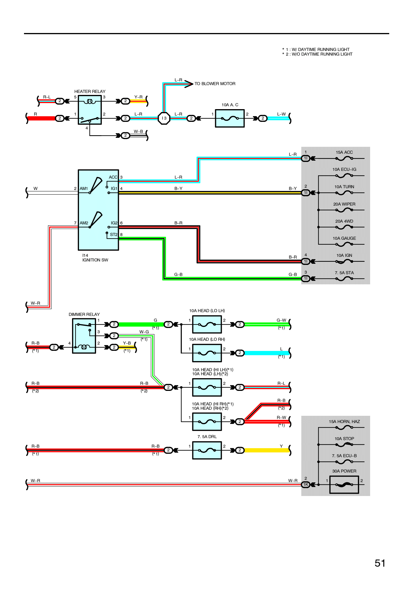

This is the closest thread I could find without creating a new thread so I'll start here and see if I can get some wiring assistance.
The aftermarket head unit I have loses bluetooth connection everytime I start my 4Runner when going from accessory(ACC)/on (IGN1) power. Probably common for everyone's radio to turn off while cranking, but I want mine to stay on. I'll attach the wiring diagram that I'm referencing.
I've determined that the radio on power comes from the 15A ACC fuse which gets it's power from from the ignition switch when the ignition switch is in the ACC and IGN1 position. In order to power the 15A ACC fuse I could wire in a diode between IGN1 (B-Y wire from ignition switch that still receives power while in the ST position) and ACC (L-R at ignition switch). The diode would keep the IGN1 circuit from powering on when the key is in the ACC position.
Can anyone with more technical wiring knowledge than I confirm this would work or suggest a better way?

I don’t really know the answer to your question, but I believe what you are looking for is the non-load reduction circuit (at least that what it’s called in the Audi world). In other words, the circuit that still gets voltage while cranking the engine.
IG1 and IG2 both get voltage when in the run and crank position, but the ignition switch doesn’t have a circuit with power in the accessory, run, and crank position.
I guess I didn’t include what the ignition positions power. Accessory powers ACC, run powers ACC/IG1/IG2, and crank powers IG1/IG2/ST2.

Might try using a 12v timer for the ACC connection to the radio. It can keep power on for 0-60 seconds after the power is cut, which would solver your power interruption issue. We installed these on high powered stereos back in the day to keep the amps from voltage spiking with the radio rapidly turning on/off during the ignition cycle.
Amazon.com: Directed Electronics Inc 528T 12v Accessory Pulse Timer : Everything Else
I've never heard of those before. I found this wiring diagram for it, but I'm not sure how to wire it for the radio application. Any recommendations?
https://www.donmar.com/Tech/DEI_528T_PulseTimerRelay.pdf
EDIT: Maybe follow the last wiring schematic they provide for a door switch?
