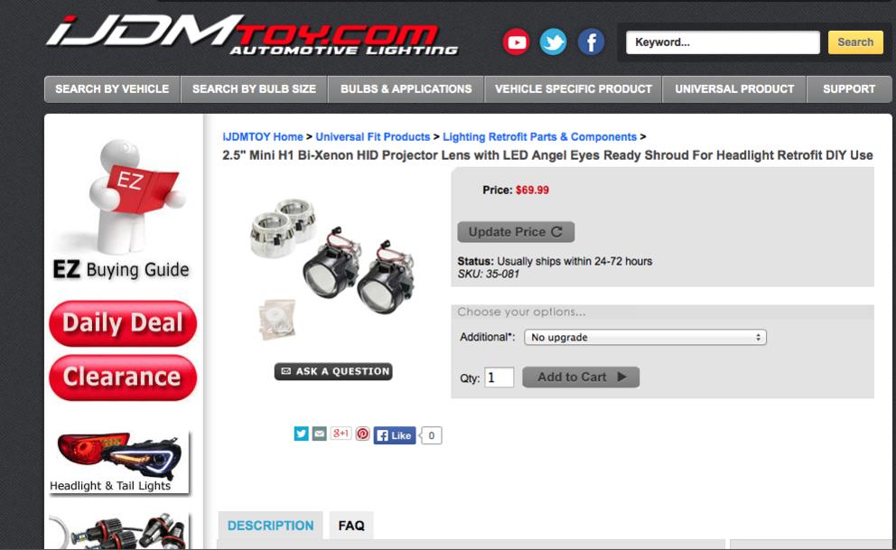

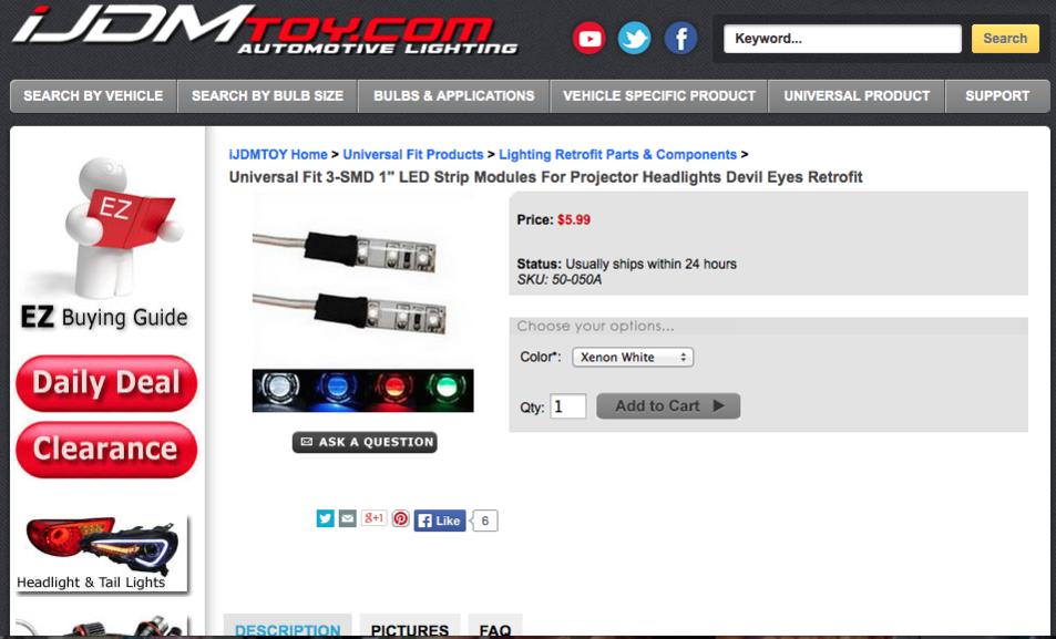

I've posted about this a few months back. I'm interested in retrofitting my current headlights (03-05 model). I've looked online and I came across these items. If you guys can tell me if there is anything else I should have to add please let me know. I plan on doing this mod in the near future.

I've looked at your retrofit threat multiple times and it's probably my favorite. Do you think that kit in the picture I uploaded would work fine? I know it's not the Morimoto Mini kit and everything.
Yeah, the kit you posted looks like it would mount up fine. It's the same size and everything, probably similar to the Morimoto in terms of design. I'd be interested to see how similar the results are if you choose to go that route.
