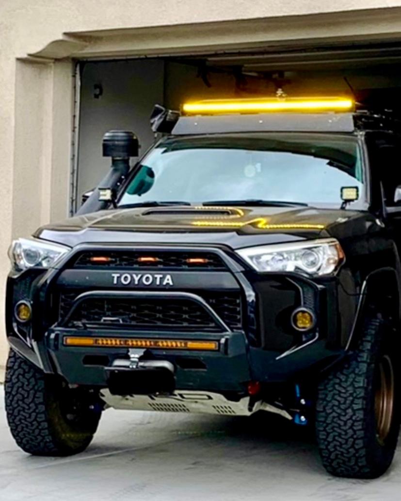

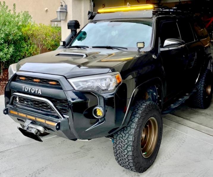

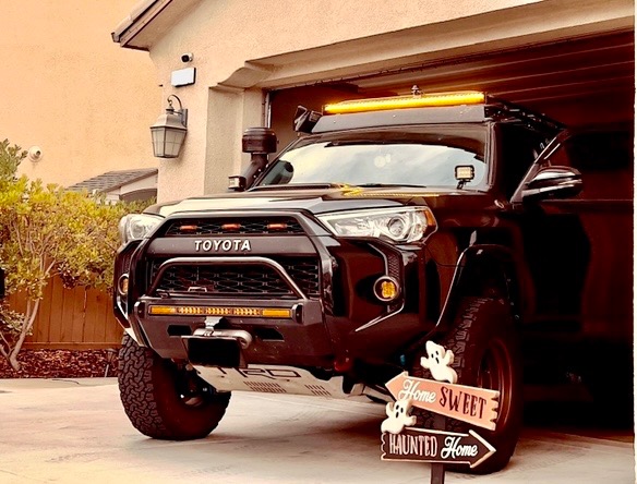

Here are some pictures of the LASFIT 42" bar installed on my GOBI rack. Warning to others that may want to install this on a GOBI rack: the light bar mounting brackets from GOBI can fit a 40" bar (maybe 41") bar at max. I had to drill out/elongate the holes where the brackets mount to the rack itself when I installed my old 42" dual row AUXBEAM. When I installed the LASFIT bar, it fit perfectly because of the modifications I had already made. BUT, what's awesome about this light bar is the rear mounting option! I would have installed the light bar that way if it didn't fit between the GOBI mounts. Like I said before, GAME CHANGER. Now onto pictures! DISCLAIMER: I am not a professional photographer (not even close).
