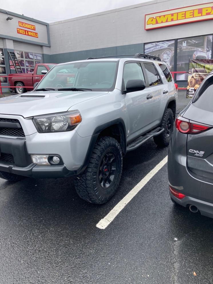

Just got the 285/75/R17 Nitto Ridge Grappler tires installed. They are almost 34" at 33.8". No rubbing. With a 3" lift, a lot of inner fender liner removal and stock TE wheels, no BMC was necessary.

Nice, get back to us and tell us how they are offroad :thumb3:
I've had no issues with mine offroad. There's a lot of mud and loose ground in S Louisiana, M/Ts are the norm but these are performing well. They are starting to make a little noise now that I've got about 20K miles on them.
Update: I stand corrected, they rubbed at certain angles once I tried more maneuvers. I required a BMC, got it done yesterday.
