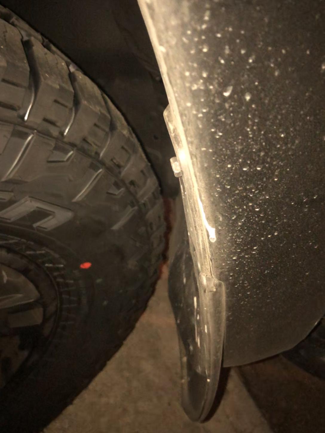

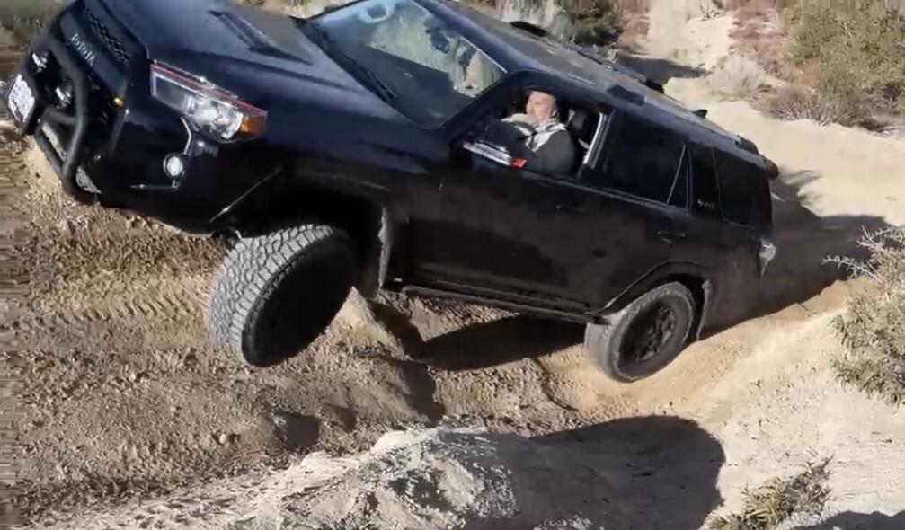

Running 285 Pirelli Scorpion AT+ on pro wheels with no lift (backordered) zero issues on pavement with standard bumper trip/push and mudflaps removed. I put the flaps back on and zip tied them back and they only rub at full lock when hitting a bump like turning into my driveway. Haven't done any real offroading since I'm sure I will rub when it flexes, but I have mashed it down dirt roads and climbed through some rocky areas. No rub with wheels straight. Little rub on the flaps if I'm turning.

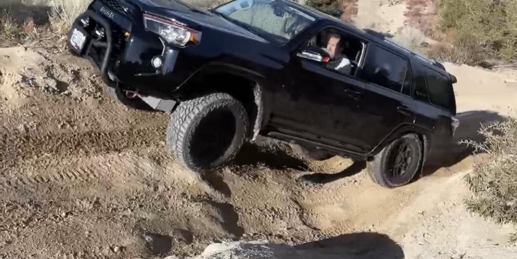

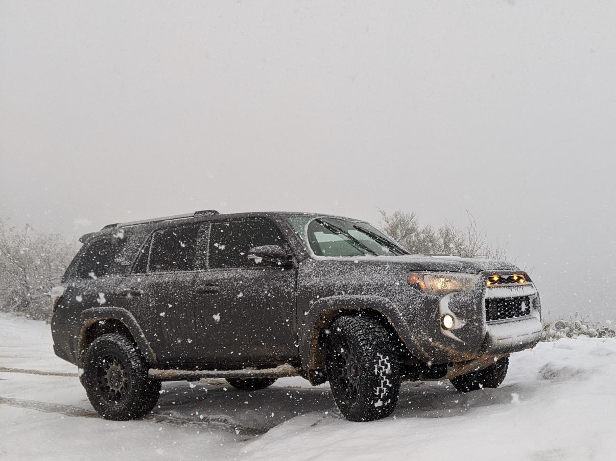

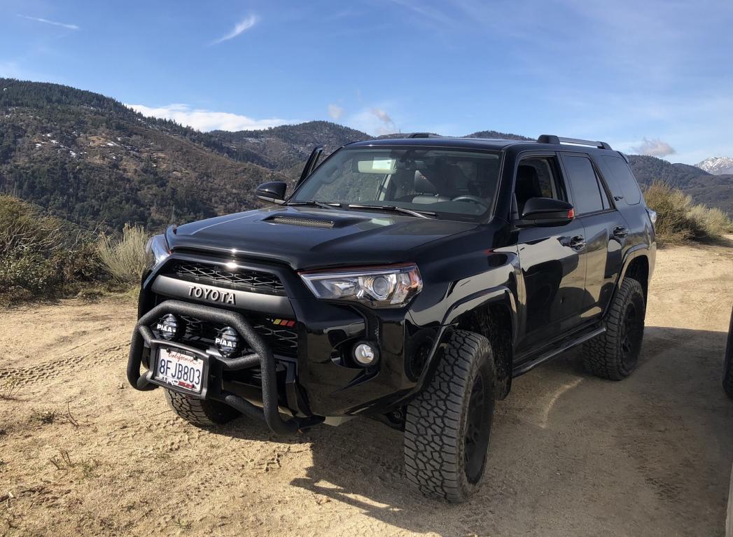

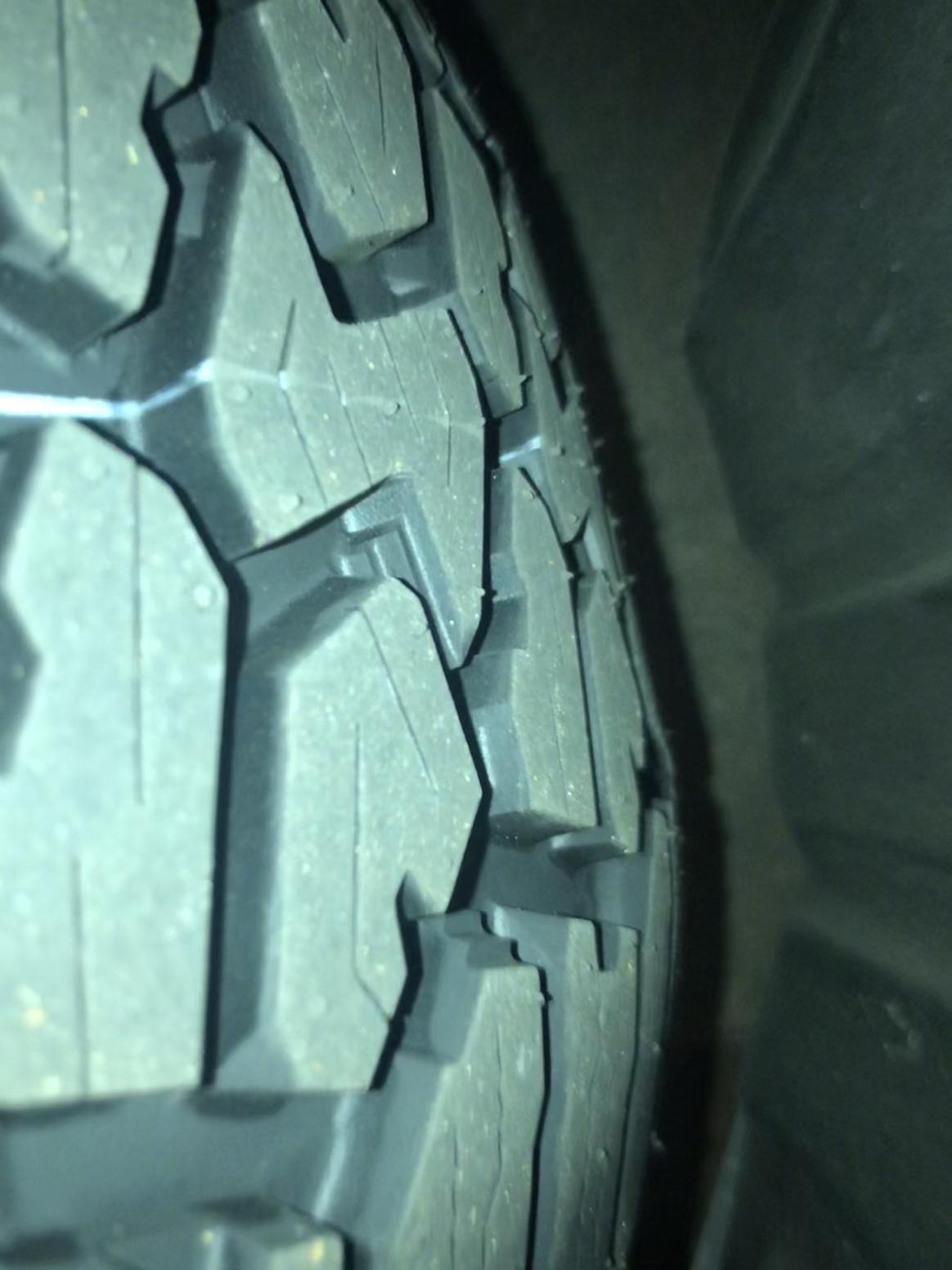

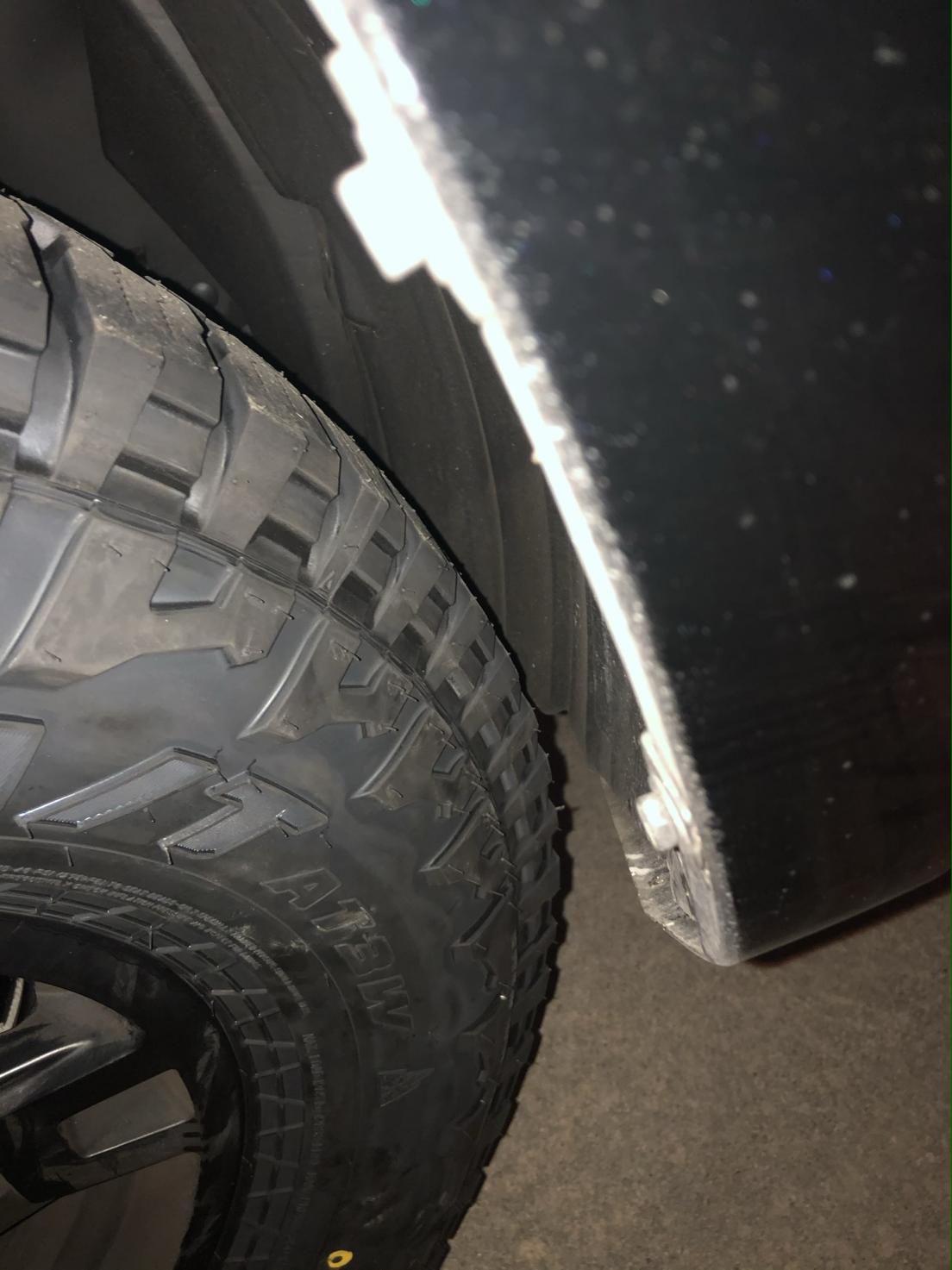

2018 Pro here. I am running 285/70-17 Wildpeak AT3W’s SL on the factory Pro wheels, which really lend themselves to limited clearance issues due to the width and more importantly the offset. . I only have 1.5/1” Cornfed spacers on it with no other modifications to clear. As you know, the Pro is ~1” higher up front stock and has the fender liner trim mod done at the port. I have no issues with rubbing the mud flaps/bm, no rubbing on the factory UCA’s, maybe a very slight rub at full articulation on the fender well, but checked after going off road each time and notice nothing. I’m at about 3.5 on the caster, as I recall. 22.5” center to top of arch in front, 23.25” rear. I would’ve liked another .5” front and rear only for looks. My CV’s are not at much of an angle and any lower CG is better. I only air down to 20psi as I run an SL and the traction and ride quality is very good.
Nice, can you upload pictures at full lock?
The only ones I have are under slight to moderate articulation. Here are a couple. One is at the mud flap, the front fender and looking down from the top of the front fender.
