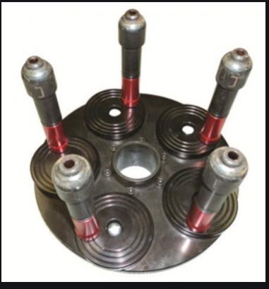

19 TRD ORP swapped OR wheels with TRD wheels and General Grabber ATX P. Vibrations are there for me as well and has been almost 2 months of going back and forth to Discount Tire. Roadforce for front ones is 6 or less and back ones are 17 and 18. The last option I am going to try is to find a tire shop that can use the Haweka adapter for lug-centric wheels.
Really wish Toyota would do away with lug-centric and go to hub-centric wheels, will help so many 4runner owners. But I am not an Engineer so don't know why they use this setup.

Then why the need for the Haweka adapter?
I am confused. I thought our rims are lug centric?

they are hub centric, go look at your lug nuts - they are normal flat washer style nuts
the haweka adapter has nothing to do with lug centric or hub centric, a centering cone is still used. the purpose of the haweka adapter is to provide even pressure to the wheel to make sure it is on the cone correctly. the cone is still doing the centering, the adapter just helps make sure it is correct and consistent. it is not a lug-centering tool. if the wheel isn't perfectly centered on the balancing cone your results will be off, the haweka adapter helps make sure it is centered on the cone by providing even pressure all around.
i'm think all toyota alloys are hub centric, but i don't know enough about the various wheels offered to make an absolute statement
the haweka adapter has nothing to do with lug centric or hub centric, a centering cone is still used. the purpose of the haweka adapter is to provide even pressure to the wheel to make sure it is on the cone correctly. it is not a lug-centering tool. if the wheel isn't perfectly centered on the balancing cone your results will be off, the haweka adapter helps make sure it is centered on the cone by providing even pressure all around.

All Toyota Truck wheels need the flange plate adapter used on lug-centric wheels.
I see others have a different opinion. I don't want to argue. But Toyota literally says, a flange plate must be used. I guess it doesn't matter if the wheel is actually lug or hub centric. Just use the flange plate and it will eliminate the steering wheel wobble.
that TSB explains what I am talking about, the wheel is hub centric and uses a centering cone and the purpose of the flange plate is to make sure it is mounted properly. the plate does not center the wheel, the cone does.
As the wing nut is tightened, equal pressure is automatically applied to each stud forcing the wheel to perfectly mount on the balancer
the purpose of the adapter is to evenly sit the wheel on the centering cone.
one of the directions is to verify that the cone sits on the "hub-centric portion of the wheel." the flange plate just makes sure everything sits evenly on the cone.
the technician should also do a centering check which is easy to do on the hunter and i assume other machines
