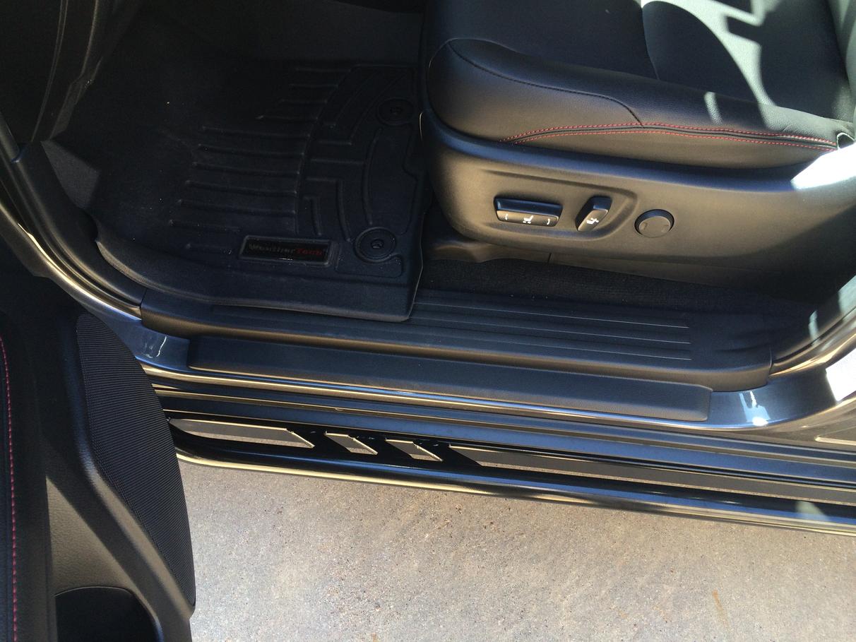

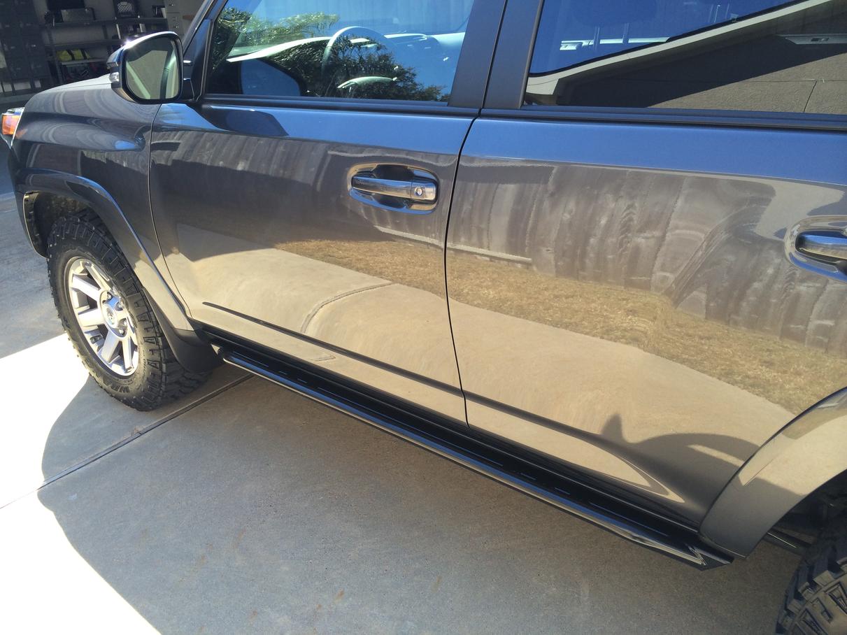

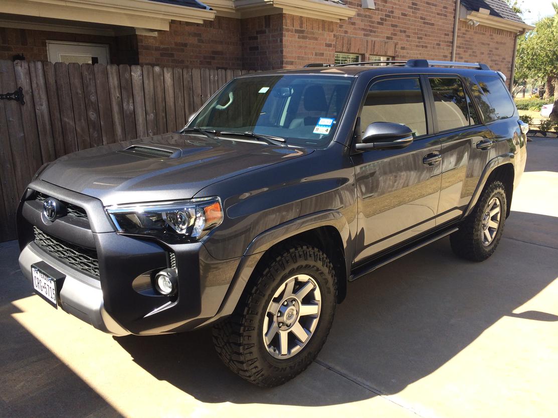

Finally got a couple of free hours away from the kiddos and wife today. These have been sitting on my work bench for the last 4 weeks just tormenting me to put them on. I think they turned out very nice. The fit is very snug.

looks great!! i was contemplating picking a set of these up for my 13 sr5. can you actually stand on them to, say, load stuff onto the roof if necessary.
reason being is that the wife has stated that she needs something to step onto to get into the truck...
i mean, can you imagine...she cant get in...and the ride is peaceful....
i retract my previous question.
I have these sliders on my 2010 TE and they don't stick out far enough to really use as a step. Which is why I like them. Some people may say they don't offer enough protection off road, but in my experience they do offer good protection, and I like the tucked in look. OP, your Trail Edition looks great with the tires and sliders.
Thanks! Yes - they are not much of a step - but that's not what I wanted either. Basically just a toe hold to reach up to the roof. My daughter actually said it makes it harder to get into my truck. Oh well - guess all the kids and crayons will need to go in the wife's car :-)
WOW! Those look great on there. If I might ask, what was the total price shipped on these and what type of install (any drilling/welding)?
Thanks
Thanks
I think after shipping it was around $500. They bolt on - six bolts on each side. No drilling or welding. Installation was pretty straightforward. If you have KDSS, there is one extra step of adding a couple of spacers behind a few bolts on the driver's side. Passenger side took about 15 minutes and the driver's side took about an hour. If installing by yourself, you will definitely need some jack stands.
Excellent. Thanks for the info...
I see you have Duratracs also. Are they stock size? Did you notice and rubbing issues?
I have stock size along with a set of Ballistic Jesters on mine (+12 offset) and had to remove the front mud flap and trim the front lip on the leading inner edge of the fender/bumper (grabbed the lip when in reverse). :lookout:
Yes they are stock size. No rubbing yet that I can tell.
