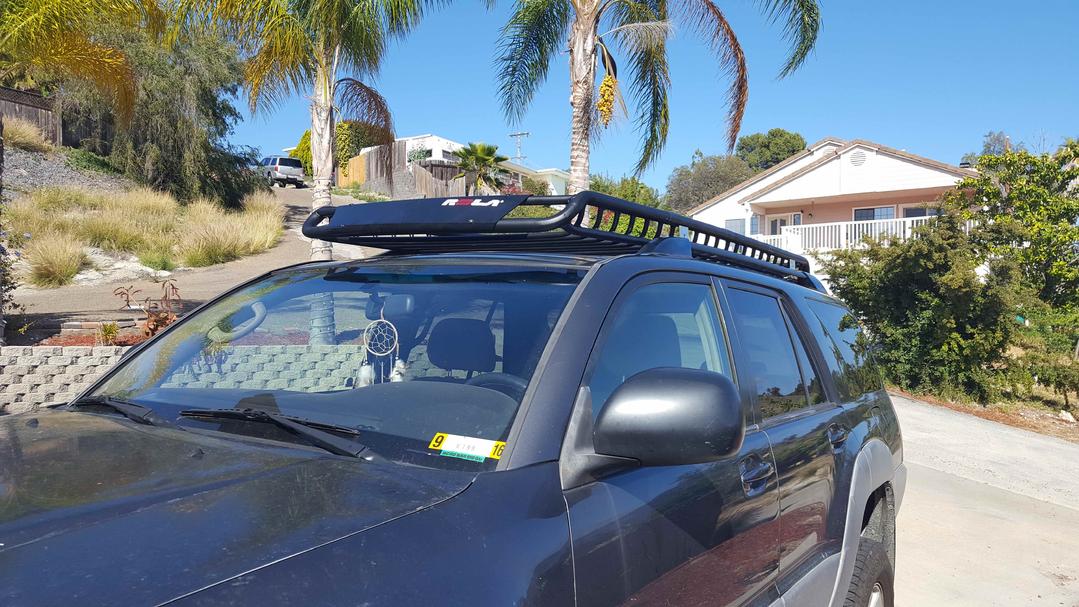

Installed! Without the fairing for now since i still have to paint over the Rola trademark. Now I gotta decide if I want the low brackets or the extension first! Overall, i'm really diggin this rack. Definitely more wind noise than before but that was expected anyways :party: And to Arn, I didn't take any steps for rust prevention though I should have since i've seen some issues with this rack.
I took a pressure hose and the rola sticker came right off. Once you put the fairing on your won't hear it at all. I used black gasket sealant and haven't had any rust problems. When I had my 3rd gen I had a rola and didn't use anything and had an orange line at every joint when it rained.
Good luck and enjoy your rack. The looks of these are great.

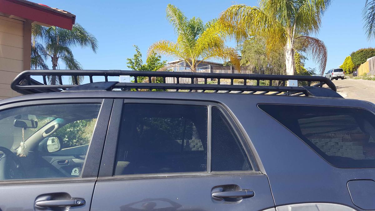

I was pretty worried about wind noise (my cargo box I had on previously made having the sunroof open unbearable), but it's barely noticeable. I can hear more 'wind sounds' (I hesitate to call it noise...) with the sunroof open, I can just make out the sounds with the sunroof closed, and it completely disappears when I close the sunroof shade. I'm happy.
I agree, with the fairing on I can barely hear anything while I drive. I usually have the radio on anyway, but it's definitely not noisy.
I didn't use any water-proofing and we had a pretty decent rain today so I'll see what happens with the rack over the next few weeks. Hopefully I don't have any issues.

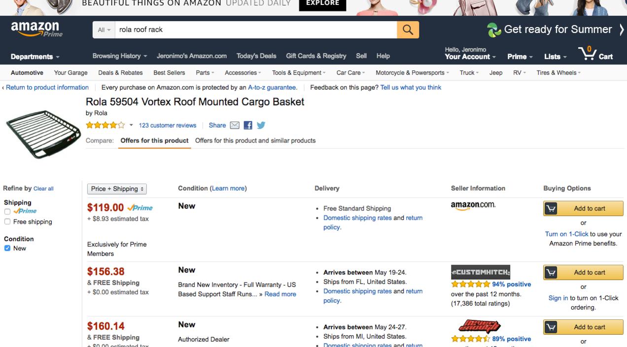

Amazon is weird sometimes. On the main product page it shows a price of $153, but if you click on the blue "other sellers on Amazon" link, you can then select the $119 with free Prime shipping options. Maybe they get paid to, or are required to, show other vendors as the primary option?

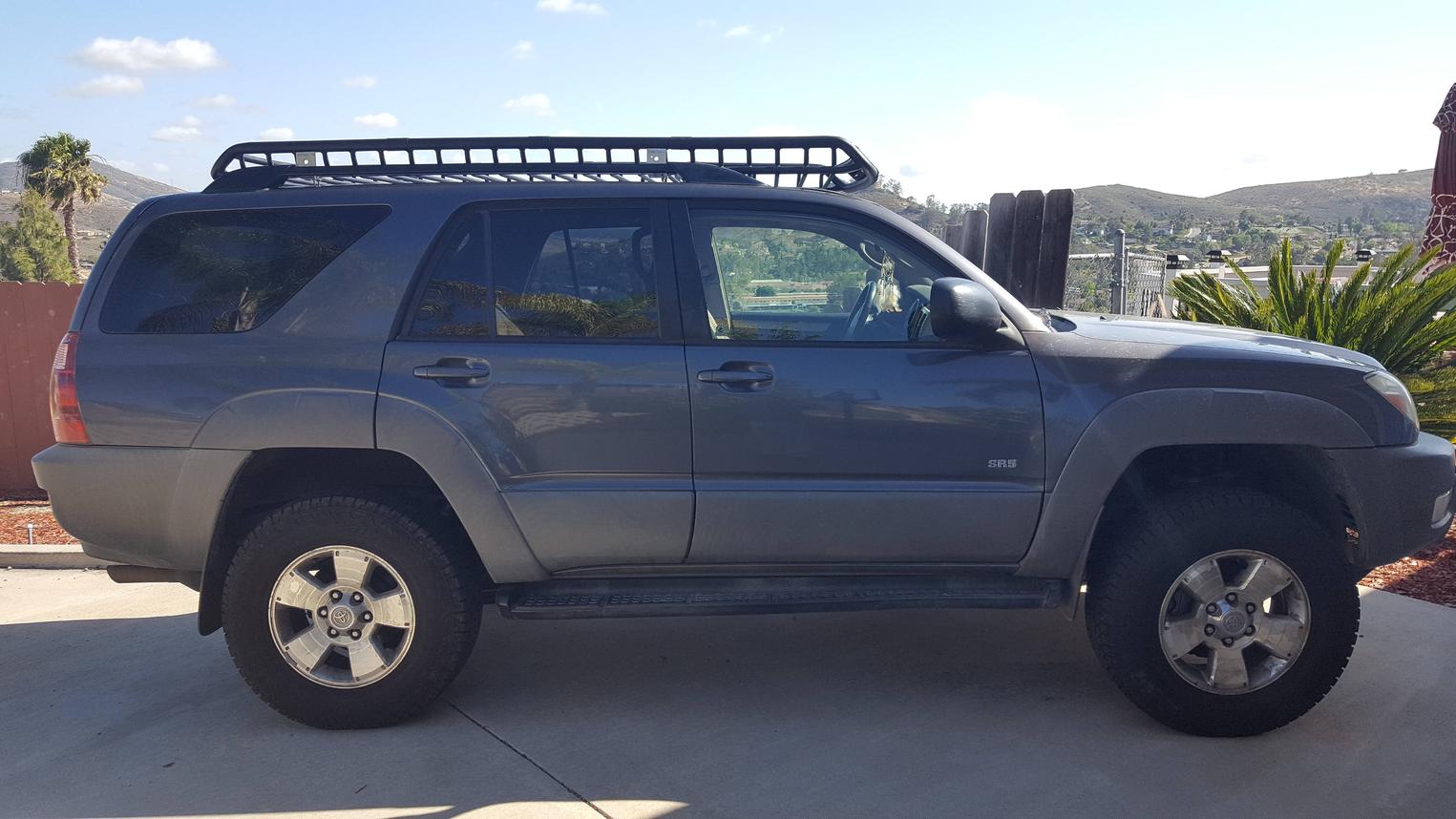

Finally installed my Rola Rack with 2 extensions. I made some home made low profile mounting bracket bought from home depot. I also need to make 2 more brackets in the front for to take the load. Need to add LED bar in the front to further reduce wind noise. I think it turned out great!
