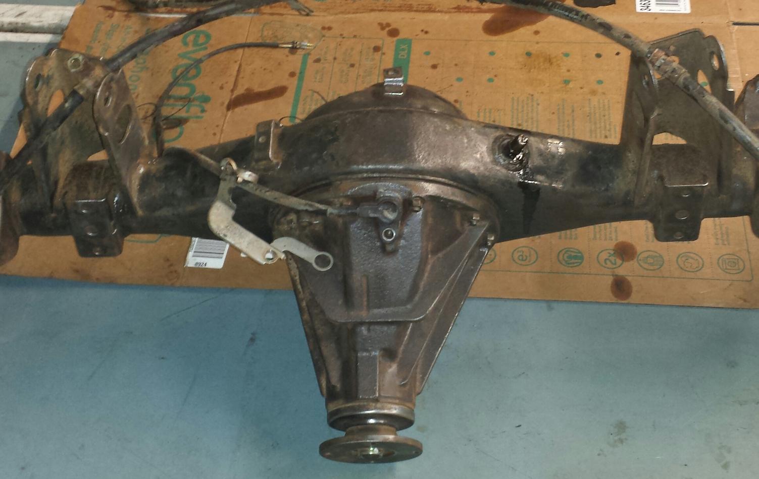

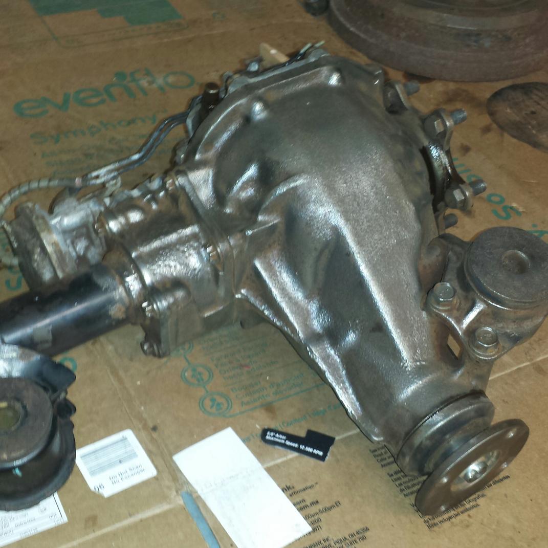

Im gonna paint the diff housing while they're out. The housing had a bunch of surface rust, which I'm wire wheeling off, i cleaned off all the dirt already. While the diffs are out coating in and around under there. Then thinking about doing the complete t4r. What do you guys recommend?
I've used herculiner before. Leaves a rough texture look, but fades in time. I've used spray can plastidip on certain car parts and motorcycle parts, looks good, lasted but you can peel it off not sure how would do on a n off road rig.
Keep in mind my t4r is far from perfect, body isn't horrible but the paint is faded, chipped and scratched..
Almost ready for wipe down and paint/coat.
