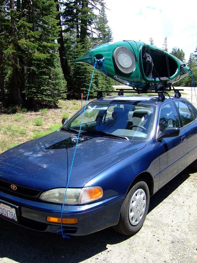

I had roughly the same concerns when I was trying to figure out how to haul a kayak on my old Camry, without the wind grabbing it and pulling it off the top of the car. I've attached a photo which illustrates the solution I came up with.
On the 4Runner, in front, there are both hooks and metal pieces with a hole next to the skid plate. With your ladders, you could use the same idea to tie them down. The rope would absorb the wind pressure and keep the ladders from lifting up and bending your roof rack. The rope would do all the work.
