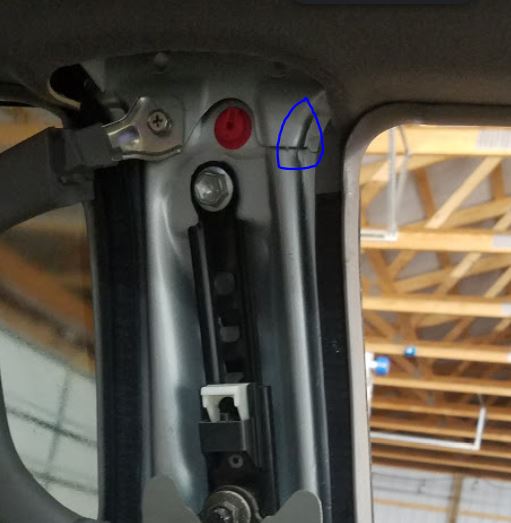

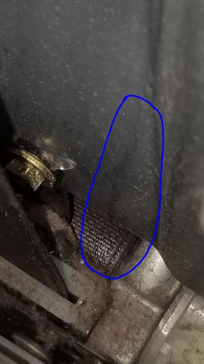

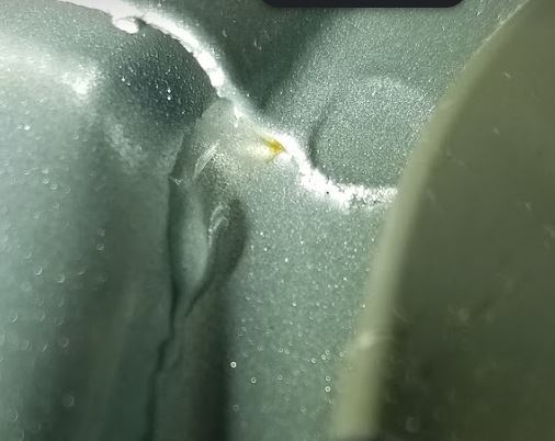

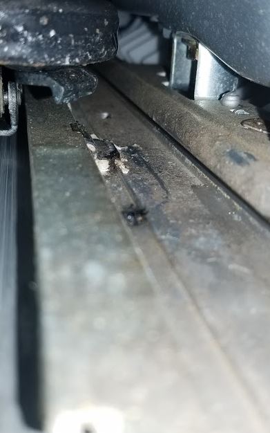

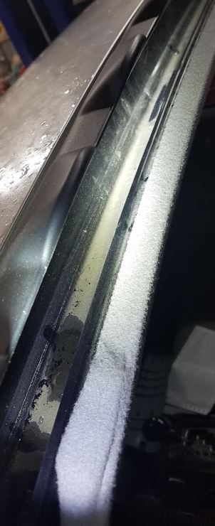

I've still got a leak somewhere. It rained this afternoon, so I thought it would be a good time to pull some things apart to see what's up.
The pictures show what I found.
In order...
Wet seatbelt...line of water running down the b-pillar, dripping on the seatbelt...dry front sunroof channel...dry side sunroof channel...little bit of rust at the source...farthest I could trace the water up the b-pillar.
Any ideas of potential leak spots on the roof? Are there any fasteners hidden by that black drain track trim that runs between the roof rack mount points?

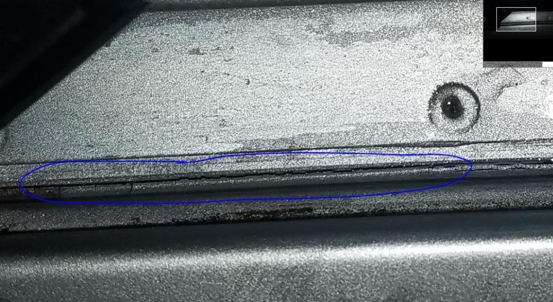

I pulled the drip rail trim. I was hoping to find something obvious like a rusted out spot weld, but I didn't.
I dumped a bottle of water into that channel and the hole I photographed above weeps, so it looks like I've narrowed it down. It's a slow drip.
One thing I did notice is that it looks like there's tiny cracks in the seam sealant in that channel. No idea if these tiny cracks are the source or if my RTV job from a few weeks back is insufficient.
