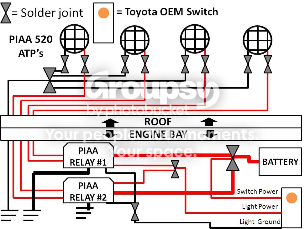

I have 4 PIAAs mounted to my Yakima Loadwarrior basket and I created a wiring diagram of how I wired them up just in case anyone was interested in doing a similar project. Since the PIAA wiring harness isn't long enough to get from the roof to the engine bay you will have to do quite a bit of modifying to lengthen it, but it is really nothing too difficult.
WiringDiagram.jpg~original
Here is a link to a thread that I started over on Yotatech and goes into detail about what I did and how I ran the wires. I hope this helps.
http://www.yotatech.com/f2/yakima-loadwarrior-build-thread-230343/
