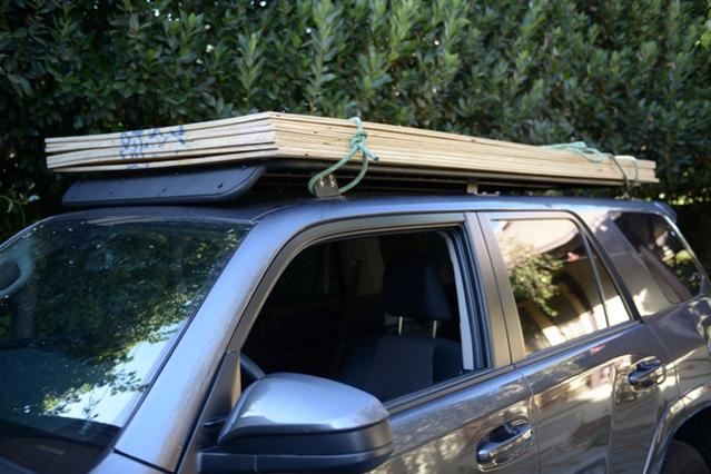

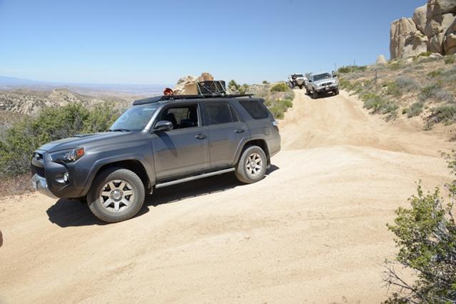

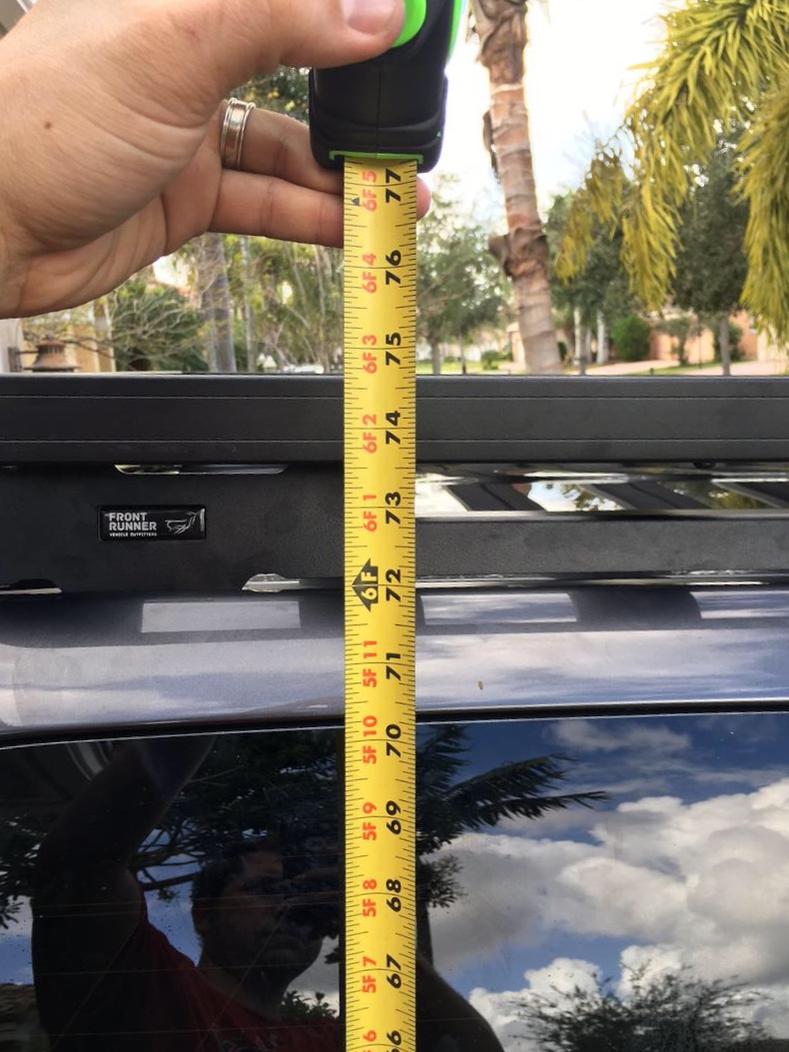

Front Runner 3/4 is a great option. It's light and all the slats are oriented across the roof so you can affix a roof box to it with no issues. I attach my Thule Force L to its crossbars as it is with no additional brackets.
how high does the front runner 3/4 sit without cargo box?
How is the wind noise? I notice most people don't sport a wind fairing / deflector.
At the moment, I have <6 inches from the roof of the 4runner to work with for tray/crossbars.

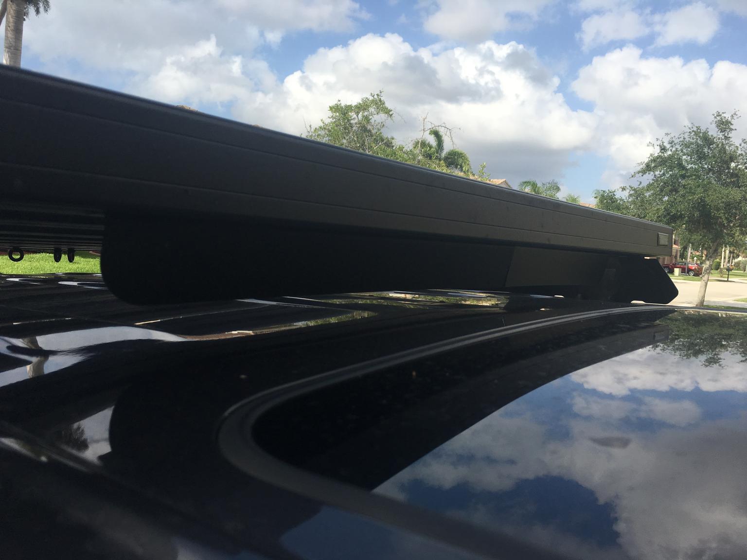

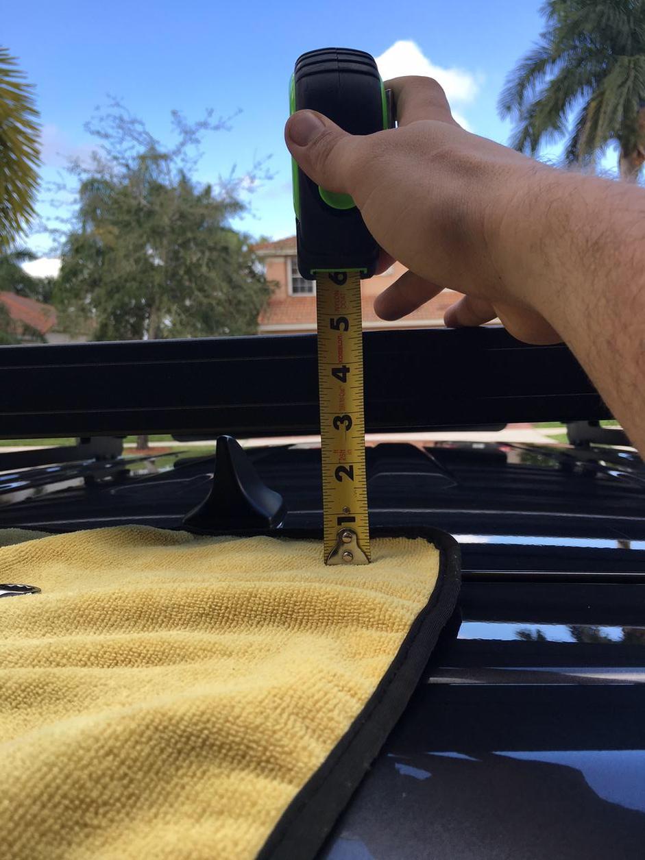

The Frontrunner sits just under 5” above the roof line. I’m at about 75” of total height with stock suspension. You definitely want the wind deflector on, it may not look like much but makes a world of difference in wind noise. With the deflector and empty rack the wind noise is just slightly above that with the OEM rack/crossbars and about the same as the Thule Aerobars I had on previously.
Edit: Just FYI, the wind deflector on the Frontrunner actually mounts below the front crossbar of the rack giving the appearance of no deflector.

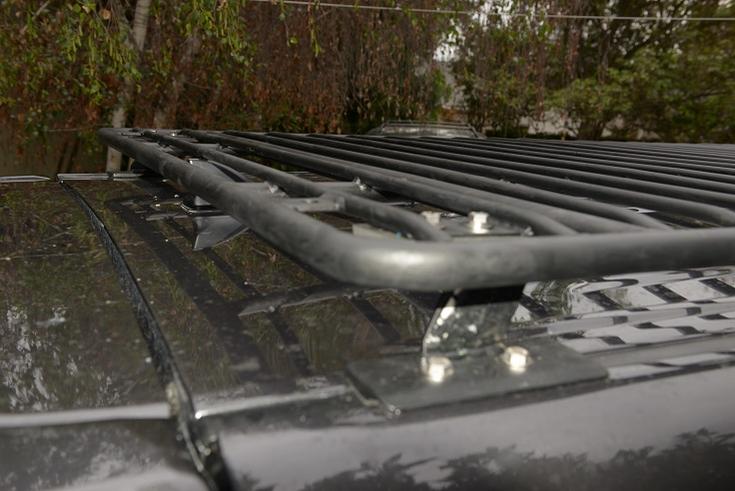

I have the Baja Racks flat utility rack with cross bars, not the mesh. No moonroof so no opening for it either. It sits very low, just about 1/2" above the shark fin and maybe two inches above the center high point of the roof. It barely clears my garage door now that I've installed a 3" lift. If I'd gotten a basket style it wouldn't clear.
It's easy for me to tie things down to the side rails or the cross bars which occur at about 4" oc. Ratchet straps work well on the rack too.
I had a custom rack made for $50 more without the u-shaped loop around the shark fin. It is easier to load and tie stuff down without the loop. I don't plan on paying for satellite radio so interference from a roof rack didn't matter to me.

Awesome thx for the pics and measurements

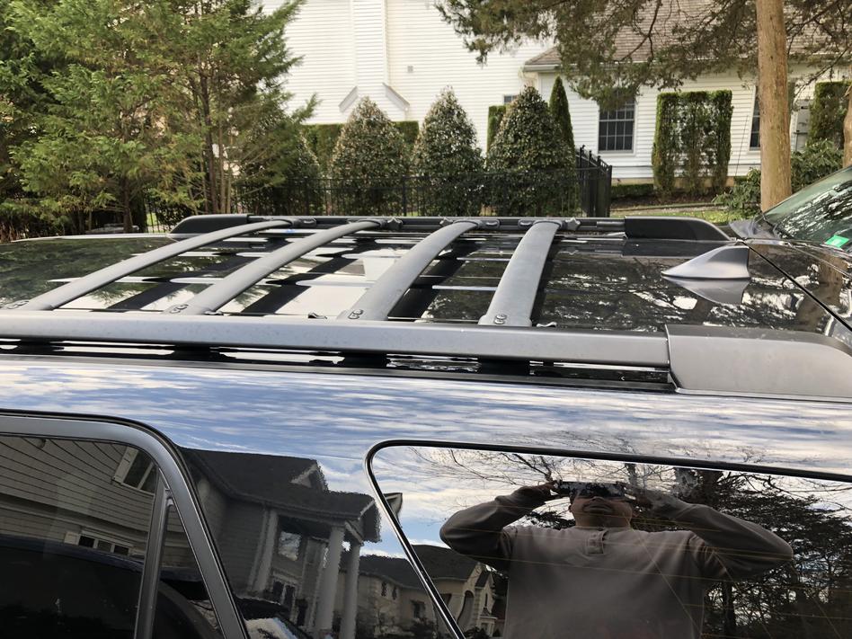

I just added a second set of cross bars
Stock with 4 crossbars...I don’t really like the look of any of the racks. I had a Thule loadwarrior with an extension and did not like the look
And the added height kept me out of parking garages. I could easily get 1-2 more cross bars on there for more coverage and they are cheap. 100 on eBay or 60 bucks a set in the classifieds. It is harder to tie down vs a basket though.
