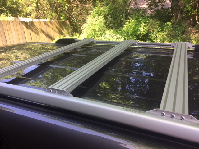

However, RockyRoad's product appears to be a viable alternative to a Gobi or like roof rack.

The Rocky Road solution looks pretty good for what you want and it only costs $250. The basic rack shown on the website has 3 cross rails bolted into the OEM side rails. One of the images on that site shows the rack with axes, tanks, etc on top but you can see the bolt on brackets and height of the cross rails.
http://www.rocky-road.com/5th-gen-4r...roof-rack.html
