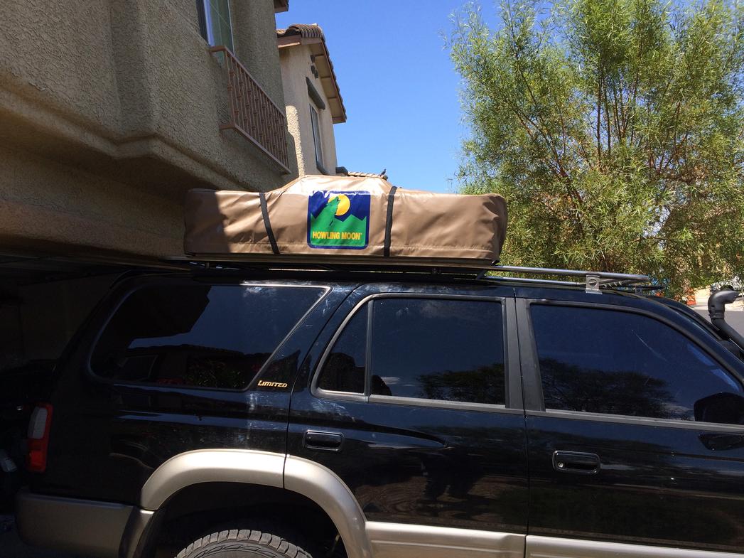

We built a low profile rack for [MENTION=113639]Mgyver1[/MENTION] and his Howling Moon RTT. It's built out of 1" .065 tube and ties into the factory roof rack rails. He's got one run on it so far and seems to be happy with it. I'm sure he can speak up also.

nope, it was thule bars on 4Runner, they sucked so many rattles, to low pro roof rack, to minty bantam t3-c trailer. unistrut blows ass....
i have solidworks drawings and a pdf on how to build it. Another member has successfully built their own rack from it so i know it works. And unlike some people on t4r, cough, i offer the plans as open source for free.99 just let me get them uploaded when i get home monday and it should be a quick weekend project 4 ya.
